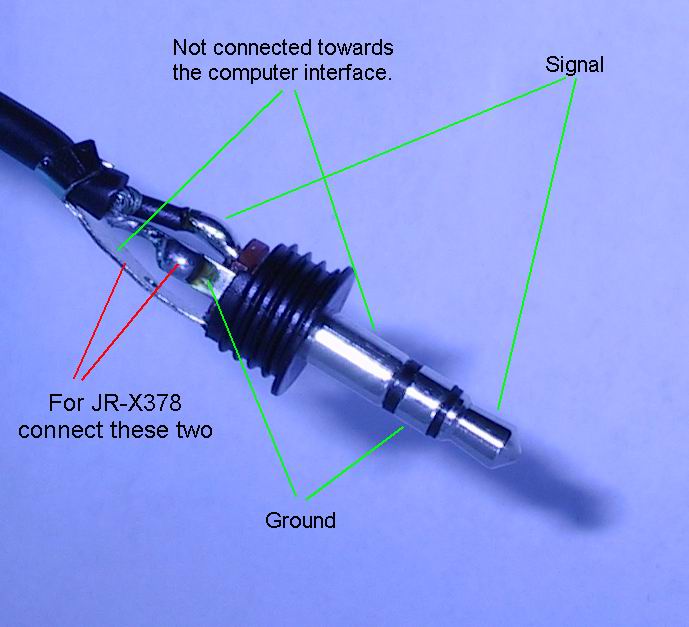

I don't want to hijack this thread but I got AeroFly last night and am haveing the same problem...
Disk installed and the Interface cable plugged into the only plug it fits into on the back of the tower. I hook my X-378 to it the program runs id's the cable but I cannot calibraite the radio nor affect the plane in the fly mode.
Any ideas? We played with the thing at the LHS...worked fine.
Any advice would be great.

Did you figure out the problem? I had the same problem with my install. Guess what. The plane I had selected on my JR 8103 was set for PCM. Once I read the manual and changed to PPM mode it worked fine.

Old 04-04-2003 | 12:54 AM
Posts: 35
From: Reginasaskatchewan, CANADA
Default Post from ipacs.de aerofly form
regarding your JR radio. it is not true that you will damage your radio when using it with aerofly professional. and also you do not have to switch on your JR radio when using it with aerofly professional. simply plug in the cable and the radio will turn on automatically. just make sure its set to PPM mode. some older pro cable didn't have the correct wiring for the JR X378 radio. you would have to do a slight modification to the cable for it to work. the newer ones should already be fixed.
look at the picture in this posting:
http://www.ipacs.de/ubb/ultimatebb.p...=000534#000001

Did you say aircraft one on PCM? If that is true you need to change the settings on your radio. Aircraft one needs to be configured as PPM.

The modulations available in the JR 8103 are:
PPM
SPCM
ZPCM
In order for your transmitter to work with Aerofly, what ever airplane you select must have the modulation set to PPM.
This is true for any transmitter brand or model.
