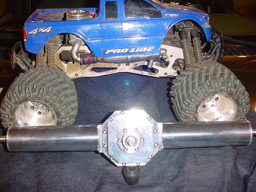

Check out item #130482443099 on ebay. I've been reading here and other forums for years and just signed in. I hope its okay to post this, i just want to help out people like me that cant find REAL 1/4 scale parts anymore.
Thanks for all the past info and hope this helps some people out!

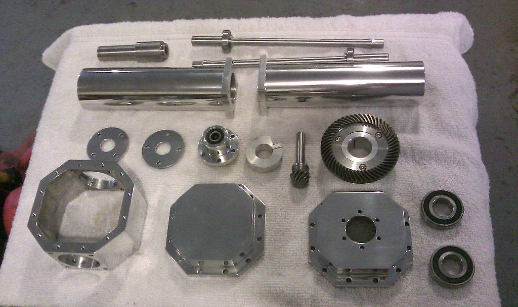

very nice...how's the front design coming along? I'd be interested in a front and rear in the future for sure....
Old 02-06-2011 | 08:13 AM
Joined: Feb 2011
Posts: 3
From: , SD
Default RE: 1/4 scale diff
Thanks mooman.
I have the front designed but i may change it as i build it. That way i can make it as modular and simple as possible but keep it strong. I am waiting to see the interest in the rear and make sure i can justify the time (it took a lot of design and machine time for the first one) even if it is just a hobby : )

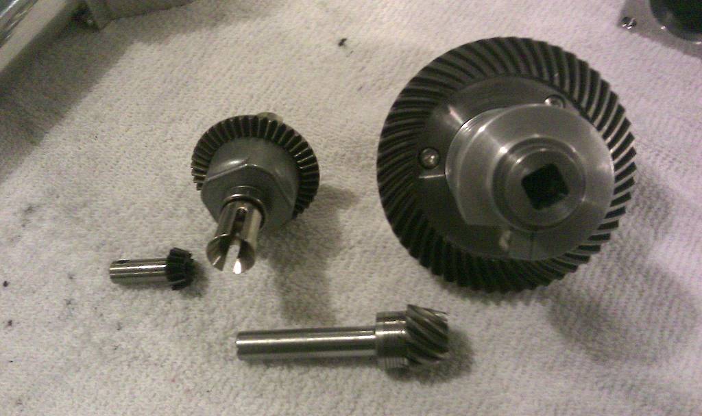

What is the ratio? and can you make as open tube type?
Old 02-06-2011 | 01:09 PM
Dirty_Vinylpusher's Avatar
Joined: Jan 2009
Posts: 3,497
From: Close to the beach, AUSTRALIA
If they're grinder gears it'll be about 3.5:1
Nice work.

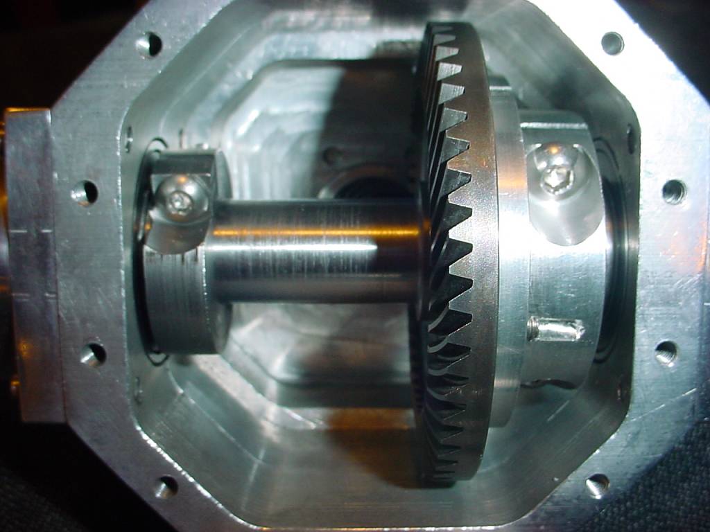

Having a fight here with myself as to call this a diff or a solid axle? Or am i missing something here?
Anyway, it looks very nice and very nice work

Mmm suppose it's more of a right angle drive than a diff.

the ratio is 4.42 to 1 and it a spool rear. so axles are removable and i am thinking of making a adjustable slip posi but the primary design was for rock crawling and monster truck so i made it with a spool.
I guess in a street car that has a spool in it for racing i still call it a rear diff but it is called whatever you like.
Thanks guys.
