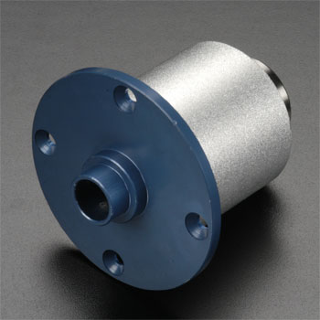

Ok ..further looking at the firehammer..I see that the diff is a blue alloy with alum case...The case is crushed in..Noticed steel gear on the diff also..Looks new..I am going too start to take it apart and see if

Does your blue diff look like this upgraded one from Duratrax?
http://www3.towerhobbies.com/cgi-bin...?&I=LXHUB2&P=Z
Is just the sleeve damaged or is there visible damage to the case? If it's just the sleeve then you may be okay. I got a nice sized rock stuck between my diff an chassis plate once and it put a nice dent in my alloy FG sleeve but the diff still works.

Kengen..yes it looks just like that one you posted.I will try too post a picture..to show damage..

Looks like it caught a rock like mine. My limited-slip FG diff has a big rib all the way around in the middle so it probably helped limit the damage.
If the truck moves freely without any rubbing noise from the diff then you probably just need a replacement sleeve. Once you get the old sleeve off the diff internals might be in good shape. The grease might have dirt mixed in if the previous owner ran the diff in that condition in the dirt allowing dirt to get inside. If that's the deal then you might need to clean out the old grease and put in new. If you can avoid it try not to take the bevel gears out because it is a real pain in the neck to get it back together.
You might be able to use the sleeve that comes with the plastic diff on that alloy unit. The two sleeves look very similar.

OK..It took some doing but I got the rear diff out of the truck..Had too cut the sleeve off the housing...I lucked out..the internal gears are ok ..no damage..even clean grease
Question 1 is there a O-ring on the end where the 2 small screws hold the sleeve from sliding off....
Question 2 the diff cups are split these have splines on them..Would this be called inboard cup?

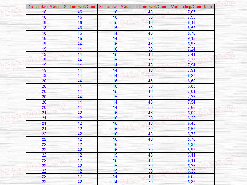

The spur gear is 48 tooth. The Pinion is 19 tooth. If you decide to with a steel pinion, great price here:
http://www.innovativehobby.com/index...OD&ProdID=1015

As above, only I'm pretty sure you need the 44t spur with the 19 tooth pinion, at least, that's how it is with FG, maybe not the FH, I dunno, I just thought I'd throw that out there.
![Default](https://www.rcuniverse.com/forum/images/icons/icon1.gif)
ORIGINAL: Foxy
http://www3.towerhobbies.com/cgi-bin...&I=LXHTU9&P=ML
You can see the "48" imprinted on the Spur Gear. Anything else won't mesh.
The spur/pinion sold at Innovative is also a 19/48 tooth combo.

Fair enough. Just checking. As I say, that's how they are on the FG, and I thought it was a pretty close clone, guess I was wrong. Thanks for the correction.
