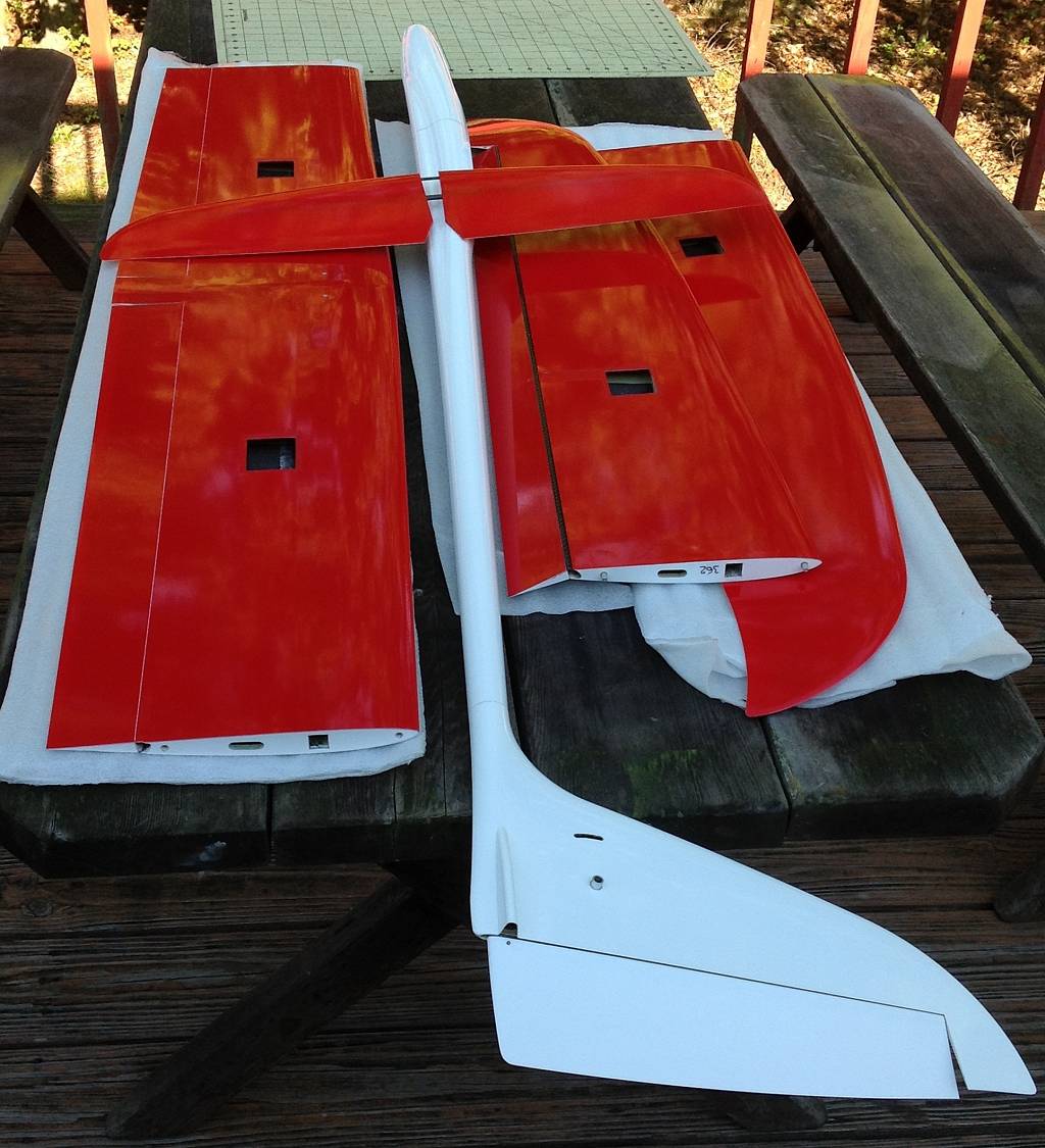

just a couple of pics:

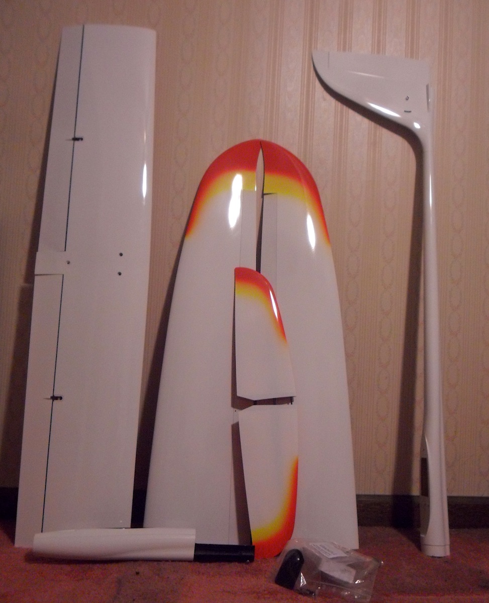

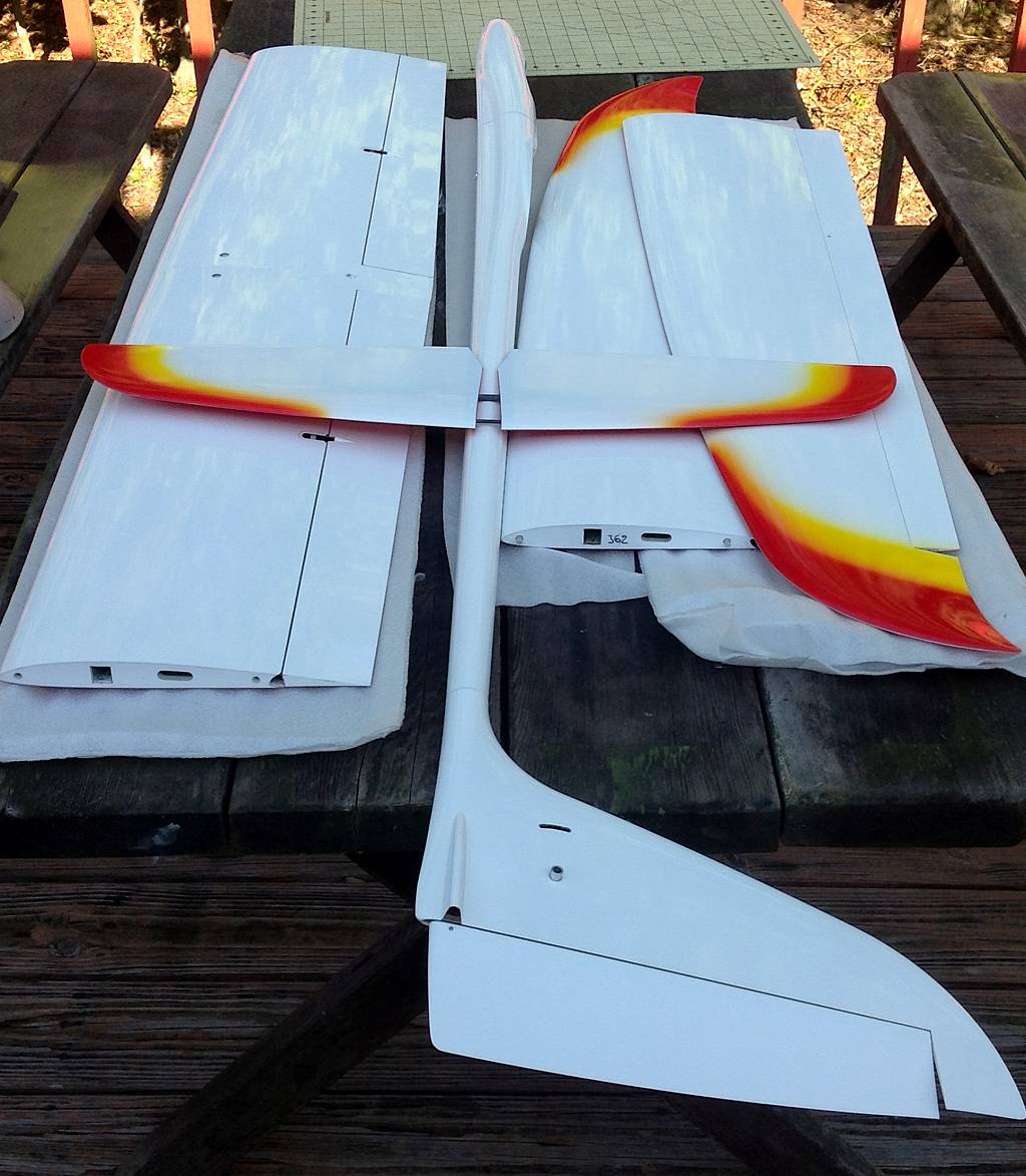

Just a few more pictures before servos and motor arrives.

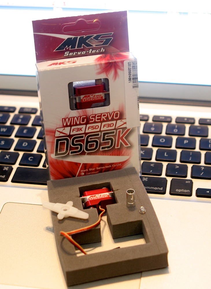

Here's the pictures of MKS 65K servos and Hacker B40 12S w/4.4:1 gearbox.
Those servos fit nicely in a Graphite tail and offer plenty of room for installation.
After checking a slop on MSK servos and KST servos I think I'll get MKS DS6125 mini for ailerons and DS6125 for flaps. Price difference is almost twice but this is not a $200 glider either.
The good part is that MKS and KST servos are identical in size, so I can install aluminum servo mounts with extra bearing from Windrider.

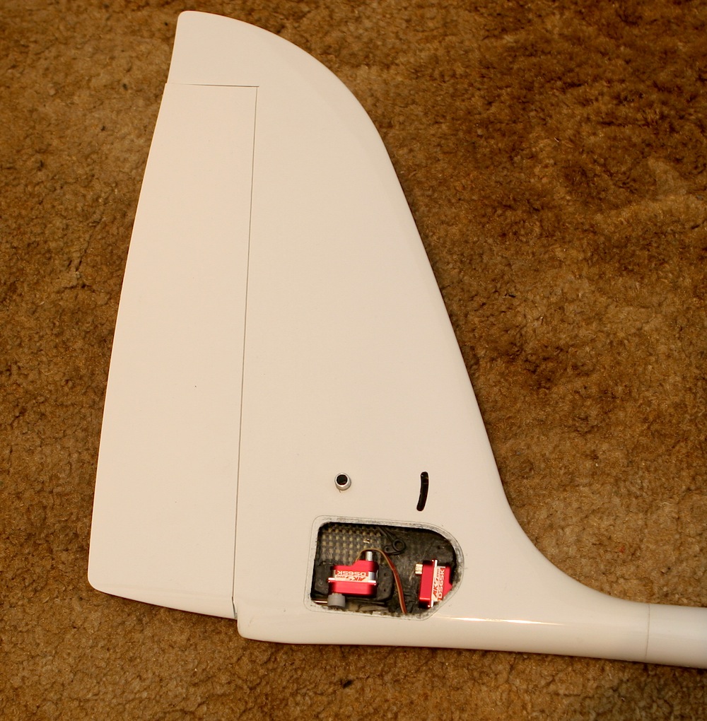

Finished tail section with wiring and controls done. Wiring is covered, connectors are covered above the rudder servo.
Good work longsoar. It is a bit of a tight fit in there isn't it?
Cheers,
Brad

Hey Brad!<div>Yeah, kinda jammed in a tail section. That's the reason I used wire guides to make sure they wont interfere with controls.</div><div>How's you flying going?</div><div>cheers,</div><div>Mark</div><div>
</div>
