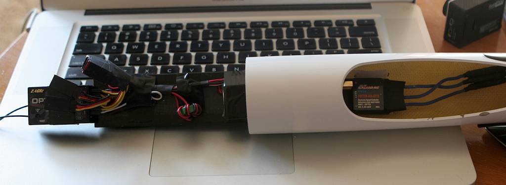

This is my latest electronics setup. While testing the motor it felt like it got much more power.
<br type="_moz" />
ID:	1838202   Click image for larger version
