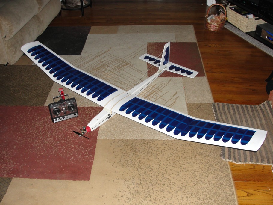

Built my first glider last year: House of Balsa 2x4 with a small glow engine bolted to the nose.
I now want something larger and more efficient while keeping it simple. I'm looking at the Sig
Riser and the Goldberg Gentle lady. I'm planning to use a Norvel .061 on a power pod. Just
need to decide which kit.

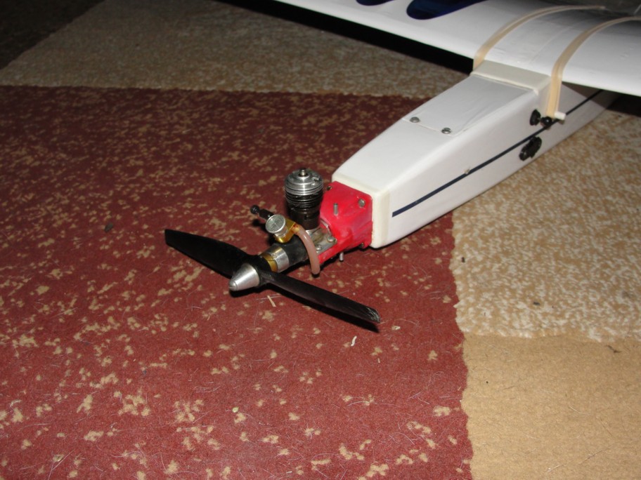

Sorry guys, been away for a while, got sucked in to FB and youtube. I'm a glow engine
enthusiast, that's what I know best. I'm currently flying my 2X4 with a throttled Norvel .061
The 2X4 is OK but it has some short comings I'd like to have a better, more efficient glider.
I like glow because because I already have it, going electric means lots of stuff to buy.Besides,
I wasn't sure a brushless set-up would fit in either plane.

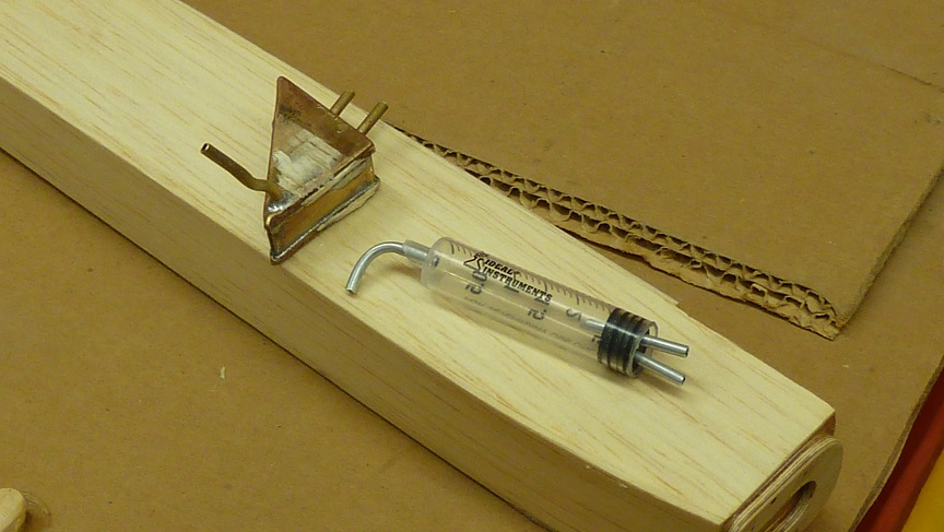

One detail about flying fuel engines in gliders that is missed by inexperienced flyers is the use of freeflight fuel tanks. In fact, freeflight timer shutoffs to limit the engine run make a lot of sense for modelers who want the challenge of winch like launches.
Flying a fuel engine glider with no means to shut off the engine really has little challenge. It can be boring for most modelers. The biggest test is to your patience waiting for the engine to stop. On good glider days, the problem is often just keeping the altitude down and the model in sight. But add a fuel shutoff and you model has it's own "winch". Of course, you gotta make your own unless you've got a history of freeflight.

Fuel soaking is always a deal with glider style models like this. I'm going to suggest that it's worth wrapping the covering, assuming you use an iron on, around the edges and then heat seal both the forward hatch and wing openings with a sacrificial sealing strips. I've done this on a good half dozen glow powered sport models and I was glad I did later on when I had to get into the guts. It was clean and dry inside. And removing the strips was the matter of a few added seconds.
Alternately consider attaching the nose hatch permanently and make a light plywood "sled" that holds your receiver and battery pack.
A free flight idea for a fuel tank which would give you around a 90 to 120 second run time is to use a 10cc syringe that runs top to bottom through the nose just behind the engine firewall. The rubber plug can be poked through and stub tube added for filler and vent. And the outlet is reamed out to 3/32 for a 90 bend of brass tubing that is your lower feed hookup. On the Riser a 1/8 plywood skeg could be added to protect the feed where it sticks out from being swept off. Or angle the syringe so the outlet comes out down by the lower side.
Here's a couple of pictures to give you an idea. This one is a cut down 3cc syringe for free flight. But it shows the idea. It was installed in the fuselage you see the two tanks resting on. The bent feed line stuck out the bottom while the upper lip of the syringe tube was sticking up about 1/8 inch above the wood so it was easy to seal off.
