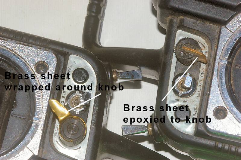

On my 6XA transmitters, I installed these index pointers on the channel 6 knob, so I can feel where the knob is.
