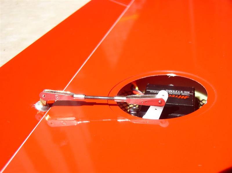

The flutter occured in shallow dive, not high speed, not under propeller power. It appeared that it might have been occuring in both the aileron and the flap. The bird is a Stork E, 3 meter moldie (as seen on Esprit website). Motor is a Hacker B50, but the flutter was not occuring under throttle (that we noticed...could be wrong). The entire trailing edge was trimmed down several degrees, as one might to to provide addtional lift on launch(right or wrong, it was done to eliminate me, newbie, from scrambling to find the right switch if I need to add power to get out of trouble...I am eliminating that setup prior to next flight).
The servos are brand new, Hitec HS5125MG digital wing servos (41.66oz.in torque at 4.8Vand .17sec to 60 degrees)

got the replacement brass control horns from esprit models today and fitted them in place of the ones that I originally installed and cut too short. The new ones still only give me 1/2 inch length from the control surface to the center of the hole where the clevis is inserted. Is that going to be long enough for a 3 meter sailplane? Looking through some of the photos of similar sized birds it appears that many have controls horns installed that are greater than 1/2 inch.
Also, the Hitec servos I have (HS5125MG), even when powered up have a tiny amount of play/backlash in the gears...never seen that before. Does anyone else here have those servos? Do you see the same thing? Could I have gotten 4 bad, brand new servos or is this normal? The cheaper sevos I have on the v tail are locked in with no backlash at all.

I certainly appreciate everyone taking the time to outline something that I am sure must be basic to those with experience. Got to call ZB at Esprit about the horn he sent me as from everything I have read, 1/2 inch just doesn't appear to be long enough. Maybe its me and I have just installed it wrong.
The emphasis on slop elimination still disturbing due to fact not much I can do about the play in the Hitecs. Maybe its a non issue when dynamic forces of actual flight are put into play. Guess there's only one way to find out.

A Banner day for me
My first launch, by myself. My first fixed wing landings, by myself and no flutter!
I replaced the brass control horns that I hacked down to little nubs and moved the clevis on the servo in one hole toward the servo center. The brass clevis is still only 5/8th of an inch tall, I thought, looking at some other examples on various posts, that I might need to be closer to an inch. The hitec servos, though having a bit of backlash, apparantly were not to blame. It was a nice quiet night with little wind and the only sound was that lovely aerodynamic sound these 3 meter birds make as they pass overhead. No buzzing flutter.
Thanks everyone for your input and lessons in basic control setups. I will post one closing post soon with photos of the changes I made. Hopefully, a future newbie will benefit from my mistakes and your advice.

as promised, the before and after shots. Photo with short horn and clevis further out on servo arm caused flutter, longer horn and clevis moved in fixed it.
