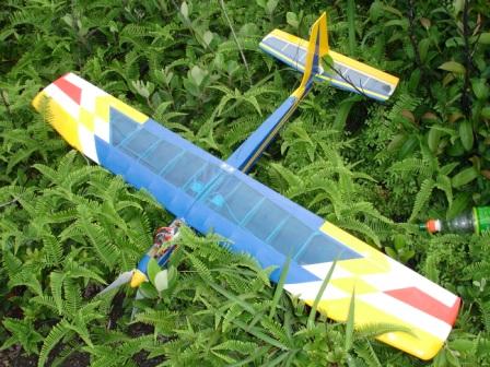

OK I've gone brushless, what a difference!
My solution was to fit a small direct dive brushless, a KDA22-10s. I filled the hole in the foreward bulkhead where the gearbox used to sit, and mounted the motor in front, cut out the cowling to fit over the motor. A supplied adapter is bolted to the front of the motor and the standard prop hob drilled slightly to bolt up, also using standard prop blades. Looks a little weird as the prop now sits further forward from the cowling, but this may allow some airflow to motor.
Gave good rpm on bench with two cell lipo, but have flown with 1300 mah 3s lipo. I am pleasantly surprised with this little motor and my much rejuvenated Sky Runner. Will fly vertical.

Do you have a wattmeter? I would love to know how much power you are pulling. If you are going straight up on a 3 cell lipo you are probably drawing at least 12 amps on the bench.
This motor is sold under different brand names, I originally bought them as Dynam from a local supplier at twice the price.
https://www.unitedhobbies.com/UNITED...idProduct=2104
Look at image 3 to see the supplied hardware, including prop adaptor, prop saver, mounts, connectors, spare shaft etc.
Was more test data, but the forum has been changed. Someone has commented that with "GWS DD9050 = 14 Amps, 700g trust, 8,300Rpm."
I measured slightly higher RPM with stock world models folding prop and my 12month old lipos, about 8600rpm.
The 22-10 refers to 22mm diameter to inside of magnets and the 10mm magnet length. I would have tried the next size up 22-15m, but had the smaller motor sitting there, it's fine for me in the Sky Runner. I use the KDA 22-15m in Hyperion Cub10e and Super Chipmunk 10e, and Great Planes Fokker D.VII. They do not lack for power. Have a KDA 36-16m in a World Models EP Sailor 2m gilder, 25amp esc, 2100mah 3s, same mounting as the Sky Runner. The vertical take off and climb is stunning.

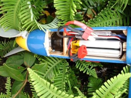

This photo shows plywood disk filling hole in forward bulkhead, motor is bolted to other side (back mounted on 'x' shaped mount). The hole at top of the disk is for the motor shaft to protrude back, with shaft on same alignment as the previous gearbox shaft. A 1300mah 3s battery is kept forward against no 2 bulkhead with foam block, to balance model, there is room for many battery options.
This photo on motor exposed due to cut out cowling. Perhaps not pretty, but functional.

I have tested the Skyrunner brushless setup with 2 cell lipo batteries. Even cheap Loong max 1300mah 2s fitted right up front behind the firewall.
Still very flyable and lighter, however the gliding performance did not seem significantly better than with 3s battery, and you will miss the fun of the 3s performance.
Hi Ed
Yes I had to cut out the opening on the no 2 bulkhead (where the back of the brushed motor was), to get the 2s battery all the way forward.
Balanced it about the same as the 3s option, a little nose heavy. Perhaps I need to balance more carefully.
