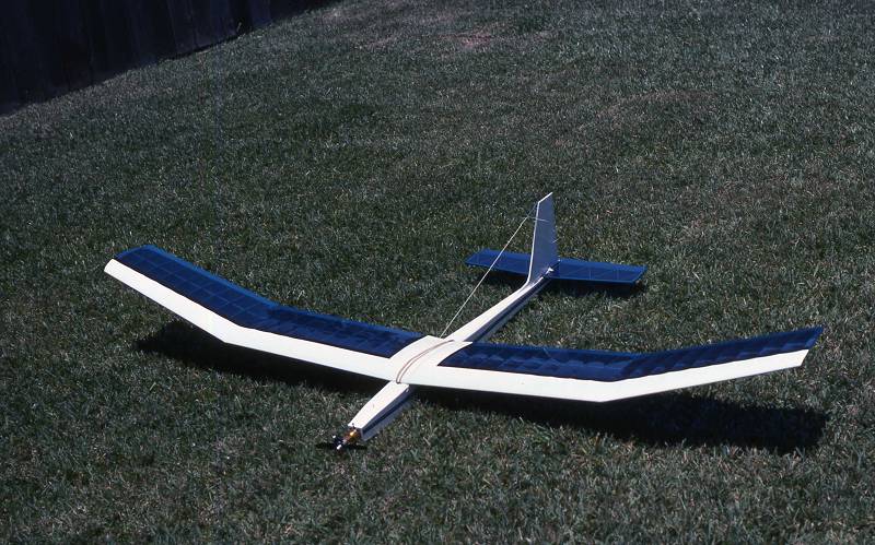

Here is a pic of the GL taken back in 1985. Still looks the same though

both will be just fine, but obviously gliding characterisitics will be affected by the bigger prop
