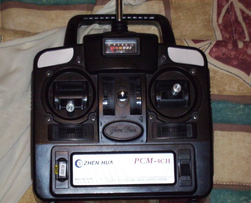

Hi, I had a normal heli with 2 servos, one of the servos went and I bought another. The connection did not fit in the board so I arranged it with the older servo's plug. It worked but the it was supposed to be the other way around. The servo has 3 wires and I connected them OK with the older wire.
Any suggestions as how to make it work OK..

You sure you got the wires right?
Is the servo working but turning the wrong way? If so, find the servo reverse switch on your Tx.

I connected the red with red, white with white and the black with the black.
I doubt I have a switch on my TX..
This is it..

You need to get a different brand servo, for instance a JR servo will spin the opposite direction from a futaba servo with the same wires hooked up. Hope this helped??

I've heard of people opening up the servo and reversing leads on the drive motor and the sensing pot. I'm sure you could do a search and find some instructions.
Oh hell, here's a couple of links that describes how to do it. Took me 10 seconds to "google" it.
http://www.fatlion.com/sailplanes/servos.html
http://www.hitecrcd.com/Support/Faqs/Faq_Genservo_.htm (see "How can I reverse the direction of my analog servo?")

Dave the problem is that I can't find any more jabo servos with the white small connector...
Recently I bought a PICO servo for ****in $60 from Malta, and when I connected the same wires it work fine and all.
But the e-sky servo did not..
