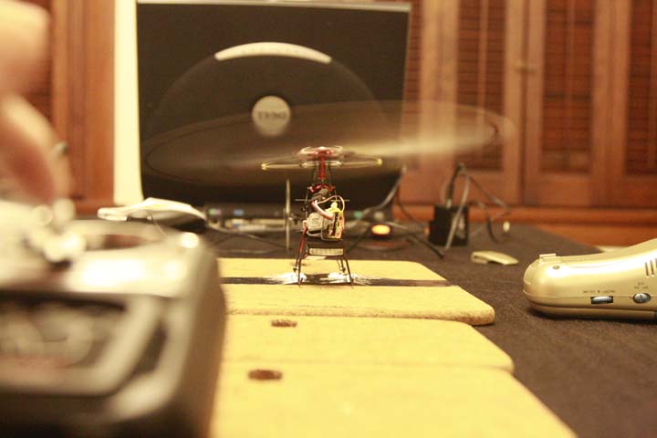

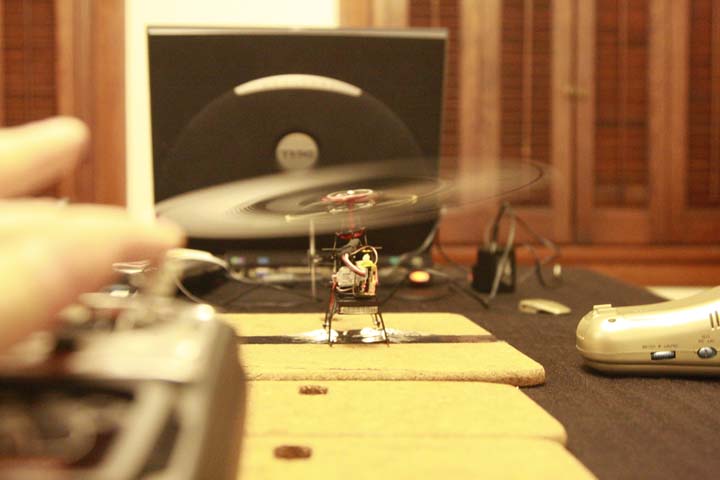

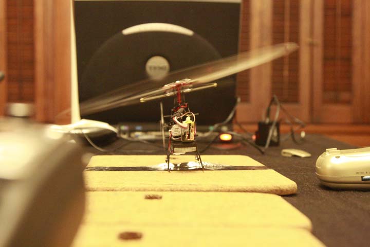

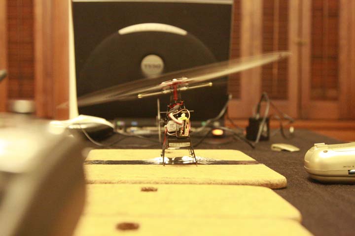

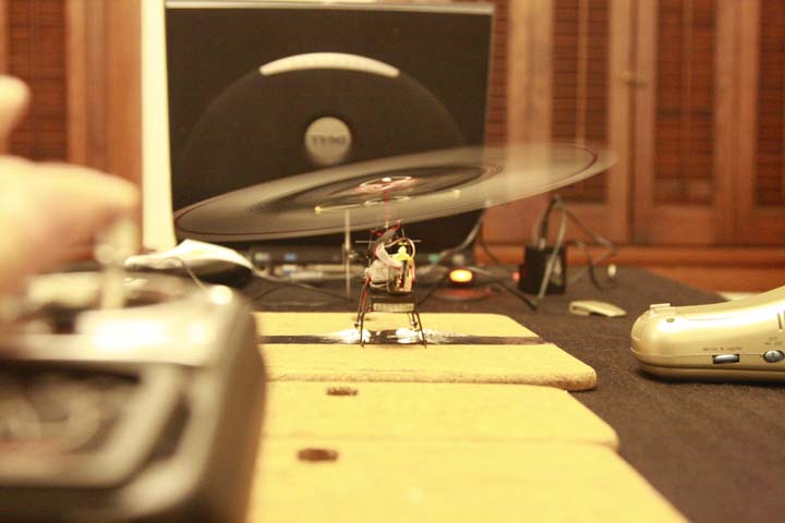

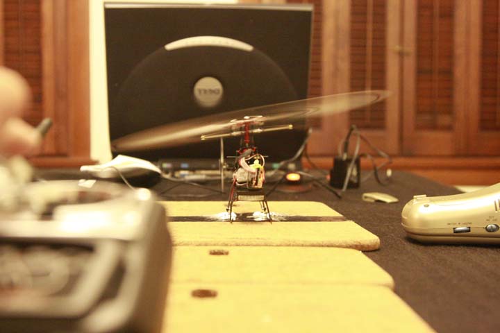

Here are a few pictures I took while powering the heli and taped down to the table.
First image is a pic with the heli with about 33% throttle and max right Aileron....aka right turn.
Second image is heli with 33% throttle and mac left Aileron...aka left turn.
Third pic is the heli max Elevator foward.... moving foward.
Fourth pic is the heli max Elevator reversed....aka reverse.
Fifth pic is the heli with 50% throttle, everything else is centered.
Sixth pic is max throttle....everything esle is centered... noticed how far the rotors are leaning to the right side of the heli? (left side when looking at the pic).
When I got to hover, it flips over in that direction.

I am assuming settings since I dont see any visible damage to the rotors/gears... but I am a newbie... I dont know anything. :-)

if your crash broke the blades, especially right at the grip, then your spindle (the small metal piece that goes through the top of the headblock and connects the two blade grips together) and the main shaft ( the metal shaft that runs through the head assembly down to the gears) are more than likely bent. most crashes, even minor ones can bend both easily. i would buy a few spindles and main shafts to keep on hand just in case, as these are basic crash parts. take the blades off and use a 1.5mm hex driver and turn the hex screw inside the grip. if you see the grips wobble any, then your spindle is bent. also grab the main gear and spin it slowly with your hand. watch the head assembly, look for a wobble. if so, then the main shaft is bent also. i would definetly check these first, and then proceed with the setup.............td

One thing I didnt know and I didnt take a picture of is, when the rotor blades start to spin, they are parallel to the ground.
It is onyl when I increase the throttle to about 33% do they start to lean to the right.
When i first power the heli on, it looks mostly even...aka rotor blades are parallel to the ground.
I will try what you said.. I didnt know it was that delicate..

I did mess with the remotecontrolsettings too... but Im starting tobelievethat its mechanical...
I taped down the heli and turned it on.
I set the throttle to the lowest it can be, and see a 'wobble' in the main rotor shaft...
Im going to buy and replace the rotor head, shaft, and rotor blade holders and see what happens.

unhook the motor, run the throttle up and see if all the servo`s are going in the same direction.
in the pic`s it look`s like the pitch servo is going down when the alerion servo is going up. or one servo isnt working at all.

UPDATE:
I set the remote control to the settings ABOVE and it removed the strong rotor blade tilt to the right side.
I think it was the -71% pit setting... I changed it to REV and then set it to 71%.
Now my issue is that it seems the rudder, rear props, arent strong enough because the heli spins when I throttle it up.
How can I adjust to stop the heli from spinning when I throttle it up?
Besides moving the sticks and fine turning slider on the remote...
Nose to the left and tail goes right....
PS: I got to hover about and inch off the ground for a sec or 2, but the heli spins faster as the throttle increases.

If I am not mistaken, when the throttle is at 100%, on a collective pitch heli, the pitch started to change to give it lift....
So, when I changed the Pitch to REV and 71%, Ibelieveitcorrectedthe rotor blade right side leaning.... I dont understand it, but I think it fixed my issue.
So the changes I did on the control was:
Ele 80%
Alea 80%
Pit -71% (NORM to REV and then 71%)
Gyros to 70 or 80%
BUT now I have a new issue.
When I do increase the throttle for a hover. the heli spins now....
Is there something else I can change in the settings to counter the strong rotational issue with the rotors and the heli?
The fine tune adjustments isnt enough on the wk-2602....since more throttle more powerful the spin is...right to left in respect to the front of the heli.
I understand the physics of helis...but I dont understand thecontrollerthat well...
Should I change the PLTsensitivitytoo?
Pitch Servo Travel Adjustment)
Or RudderSensitivity?
Thanksallot...!
PS: I actually got it to hover for a few seconds but the spinning caused me to loss control.
