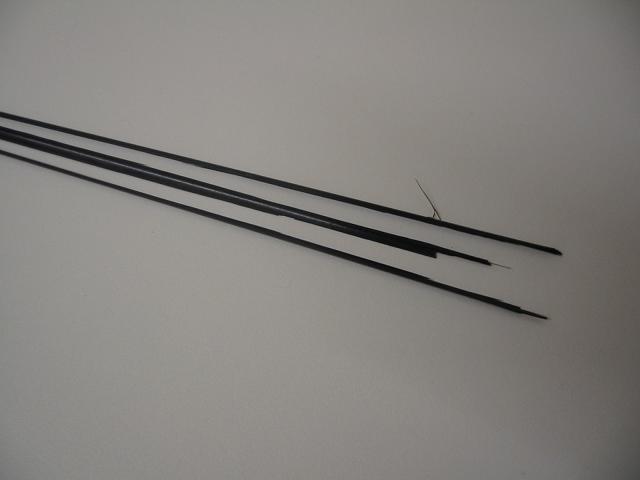

Hi everyone,
I had another crash yesterday evening. I don't know why, but the tail control rod (carbon) flew off the model while it was in hover at around 15ft. causing the heli to spin like crazy. I brought her down level but much too hard breaking the landing gear and causing a boom-strike. It wouldn't be so bad if I could just understand why it happened!
Anyway, the full story is on my website as always.

I saw a ball link for throttle wear out. the servos was being driven by a governor so the servo activity was very high. Could be the same thing happens with the gyro? The worn out link i saw had a washer put on it such that if the link wears out the washer still holds it mostly in place. (obviously this had happened to him before) Maybe i'll start doing that too.

I had the same thing happen to me. Had carbon rod with Rocket city links. It can of the tail lever first while I was in forward flight. I saw it hanging and then it fell of altogether. I was able to hit the throttle hold and auto it in. That was my best auto ever. Still I dont understand why it came off. Both ends were new.

Maybe you're right about the additional wear from the gyro movements Spaceman, but I couldn't find the servo end of the rod after the crash! When the rod came off the servo it went up in to the disc and that made it fly off (breaking the tail pitch control lever right off rather than coming off at the ball-link). The rod is a mess (see attached pic).
I've only had this heli for a few months now - do you really think wear is a possible cause for the rod to come off? I have been trying to work out if perhaps the servo moved too far. If the heli is sat still and I move the stick through its full motion it doesn't appear to move far enough to pull the rod off the ball-link, but what if the gyro was adding additional movement? Possible?

i guess they could wear out in a few months if the gyro was working the servo hard, maybe a littel dirt grinding away... hard to say.
Mine has a littel over 3 months on it, and the oval links are already loose. it does get flown a lot though.

I would highly suggest being quicker to hit throttle hold. If you ever see the heli beginning to pirouette out of control, take power away from the tailrotor immediately and auto it in. Don't panic, or you'll crash it. Even at 15', there's time to react, unless it was passing through 15' at a lightning fast descent.
Many moons ago, at 150 feet, one of my Raptors threw a tail rotor blade and grip, leaving the other one firmly in place. I saw it begin the violent vibration of a mid-air funky chicken, and I immediately hit throttle hold. The vibration stopped instantly, and I auto'd it in for a perfect save. I even found the slung tailrotor and got a free replacement from Ace! Now granted, this scenario won't play out well to a heli with a constant drive tail. But with your Shuttle, you shouldn't have a problem taking authority away from the tail. Sorry it happened to you, but see it as another facet to the constant learning curve we go through in this hobby.

Rocket-city ball links may not be your best choice for tail rotor.
Due to extreme activity of fast servos they wear out quicker then
the original Hirobo or Jr.Take closer look at them and you notice that there is no difference in the size of the ball opening on booth sides,there for less material supporting the ball and links coming loose very fast.

FWIW, i've been flying these since 97 and never had a Rocket City ball link fail me, either by popping off or breaking. Can't say the same for other brand links. I never had problems with Hirobo linkages, but it was a personal thing to change out all the z-bends and use RC links in their place. I did this even when I was a rep for Hirobo/Altech, and I had no problem telling other owners to do the same.
This is also part of a maintenance issue. Nothing on a heli has a permanent lifespan, and everything has a service life. If you feel a link providing too much slop, change it out (balls are suspect too). If a bearing feels rough, change it out. If fuel tubing is too soft, change it out. Replace your batteries once a year. This is just the tip of the iceberg!

Its interesting to hear everyone's thoughts about the ball-links. The link that came apart in my crash was the servo end of the tail rod, with a ball on the servo arm. The tail mount is, I believe, the NHP kit.
I wish I could have found that end of the rod, but it is lost out on the field somewhere. I would like to see if the plastic part of the link is actually broken.

Get a double balled stud (like minature excell makes) and mount the link on the inside ball. The weight/mass of an unsupported control rod is considerable compared to a the original wire/rod supported thru guides, and can be thrown off. The 2nd ball on the stud may be enough to retain the link if it gets thrown of the 1st ball, although the movement might get sticky. Also seen small washers/lg panhead screw combo used to screw on the ball (TT type ball/bead). Washer should not touch the link in normal use but be just big enough to retain the link if it falls of the ball. Either system MAY buy you enough time and control to get down in one piece.
