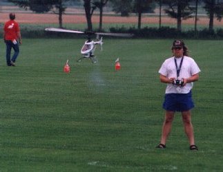

Why the anger?
Neither of us have these stats and there are a lot more cars than RC helis ....
It's a simple matter; I can safely say my heli will not wander over a crowd due to interference or Tx failure, can you?
Do I fly helis? Just a few (LMH, Nexus, Raptor, Mystar, Hummingbird).
Here's a pic of me at the '99 Nationals....
And try less caffeine buddy.

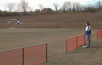

Nope, it's about a REAL comparison. I have 30 years of field experience (5 with am, 25 with ppm, 10 with pcm, 7 of these with helis). I've experienced real radio hits and the benefits of fail-safe firsthand (with witnesses that are on this forum). I also have an engineering degree (specialising in digital electronics) from the University of Toronto (where I work part time) and I work full time as a systems designer for a major bank... but your double digit sim time obviously makes you better qualified.
Now that the personal drum beating is out of the way, why not try this from a more formal logic approach and prove to me why fail-safe is useless in a heli. Are you familiar with failure mode analysis? For example, why would a decay in potential energy of the head not be beneficial in the case of loss of control?

Thankfully that list is zero in length ... I fly PCM and fail-safe brought my heli down well within the designated flying area on a couple occasions. If I was flying FM, I can't predict where it would have impacted but I can predict it would have released a significantly greater amount of energy....
"Razmo" if we can get beyond the bashing, maybe we can communicate.
Simply an explanation of what the originator meant by "useless".
Precisely.
Q) What is the most common cause of interference in a heli?
A) high frequency vibration (espc. metal to metal eg. crack in header).
Q) How do you reduce vibration in a heli?
A) reduce throttle
Q) How do you reduce throttle if you have no control due to interference?
A) fail-safe
I've had a couple saves granted by fail-safe dropping throttle (eliminating source of interference), returning control for me to auto to safety. Most recent was last June when I had a muffler bolt break.
And this is yet another reason (beside my aforestated reasons of (1) reducing potential energy in a crash and (2) controlling distance covered when control is lost.)
Useless?
You do the math....
