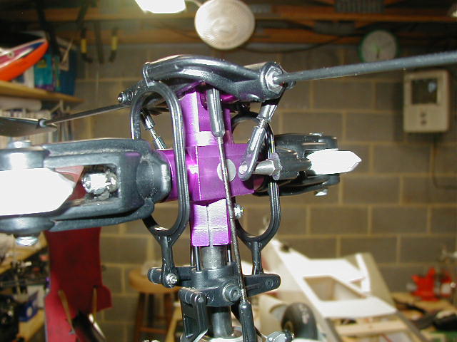

I flipped the head and added offset balls to achieve 0 delta offset. Doing that made the helicopter feel like it's on rails.... it hovers and 3-D soo much better than before and it fly's straight and level no pitchness. I'll try to post some pics tonight.
Thankyou
David
