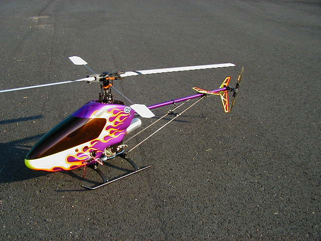

How can I apply clear coat to a Nexus Canopy? I did a search and it is recommended NOT to use cans....so how can I do this without going to a Body Shop?

The clear coat I use is a two part enamel that is PUT into a can from an automotive paint store. It works very well. There is only one place that does this in my area. Of all the clear coats I have used over the years NONE have lasted, all had turned yellow or just melted execpt for the two part automotive clear.
I am going on two years with 25%-30% fuels and no signs of wear.
Dru.
P.S. I was told that the can was good for only two or three days before it would harden inside the can.

I agree with blvdbuzzard. Any 2 part clear has a catalyst added to make it harden. Once you put it in a spray can you are very limited before it turns to a rock in the can. If you can find a place local to mix it up for you you should be good to go.

Look familiar Joe , you da man..
