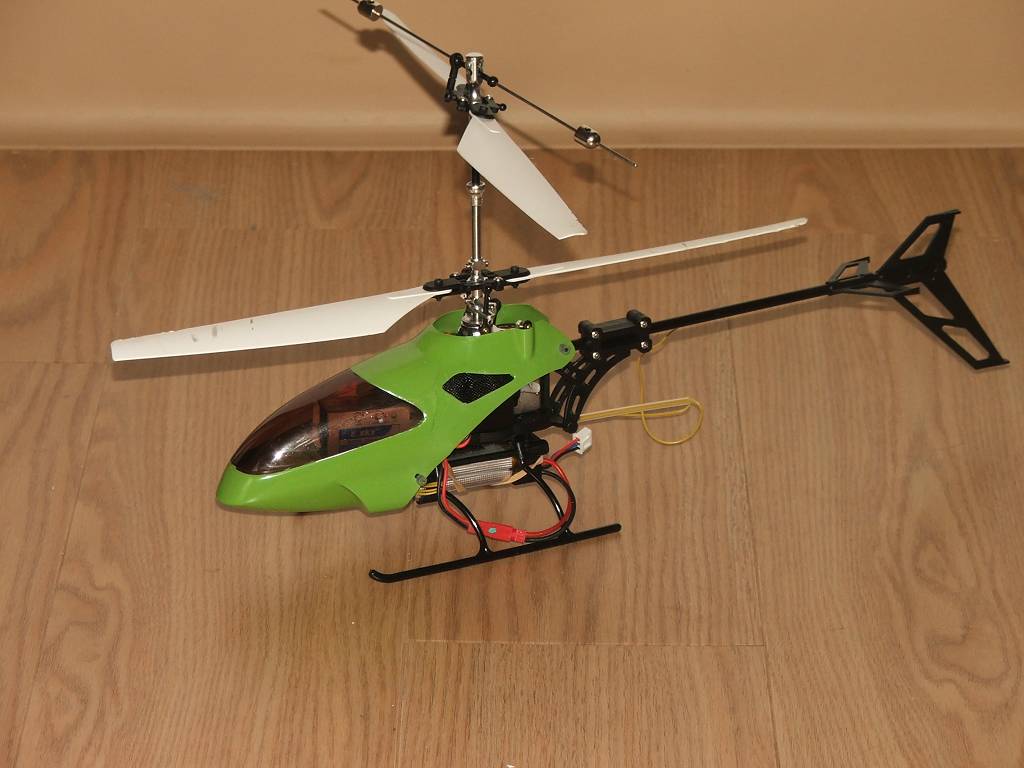

hi,
my flight times doesn't last as long as i would like it to.
i've already tried many battery brands.
after a month, the flight time is only 1-2 minutes.
i don't fly until exhausting the batteries. i'm very careful about that.
i also have a voltmeter and i always measure the battery charge before using it.
so, i don't think i'm using it improperly.
for example, i have a turnigy and a flightmax that are only 1 month old and they can only hold flights of 1.5 minute now.
i fly every day indoors, but the flights are very short.
i usually fly 2 minutes and let the heli sit and rest.
then one hour later a fly again another 2-minute flight.
after 2 or 3 2-minute flights, i recharge the battery.
is the life of those batteries really that short?
thanks.

I get from 5 minutes to 11 minutes on my electric helis.
As you can see, my answer is as vague as your question.
Without more detailed information it is impoosible to answer your quection properly.
What heli, what motor and pinion, & esc?
What size battery packs (cells, mah rating & C rating)?
What charger and at what settings?

I'm sorry for the lack of information.
The helis are simple coaxials.
It's a Cx3 and an Esky Comanche.
I've noticed the same problem with both, but with the Esky Comanche the problem seems to be more serious.
Comanche:
The motors are Xtreme 180 because the stock ones are worn out.
The stock battery didn't last 2 weeks.
The heli had many problems and the battery may have died because of it.
Then I bought a turnigy and a flightmax.
I've been using it for 3-4 weeks and they can't provide a flight longer that 2 minutes now.
The charger is the the Stock Esky one. It's also a balancer.
Some times I charge them with my stock Eflite charger, that is basically the same as the Esky one.
The only battery that lasts well is a flight power that i use with my cx3.
The rest all seem to be the same.
I find it so odd that those batteries are dying after so few and short flights.

What do you mean you can only get a 2 minute flight? You said you fly three two minute flights and then charge, that's a total of six minutes on a charge which is about right for a single charge.
Saying you measure the voltage before using it doesn't really tell us anything about whether or not you're using it properly.
You indicate the batteries lasted longer when new. How long did you fly them? What was your indication that it was time to stop flying and recharge a pack?
If you flew the packs until the heli started slowing and struggling to hover, you over-discharged the pack which is probably what killed it.
If you're packs are showing a significant lack of power after 2 minutes, then you just let them sit for an hour and fly it again without charging, your killing them even more (beating a dead horse?) Are they showing any signs of puffing or getting warm?
The thing is even worse!! I've just remembered I started using the Turnigy battery last Saturday and it's already dying.
Thanks.

Hmm, well in that case I wonder if it's something with the helis, like maybe gear mesh set too tight or something. I don't really know what to tell you, sounds weird to me.
You shouldn't have to let them sit except maybe a few minutes to cool off a bit after flying, then go ahead and charge them up again.
You should always recharge them after flying them before flying again, don't fly them for a few minutes, unplug and let sit, then fly again without charging. I'm not sure about these helis, but some helis have a voltage sensor that will be off if you plug in a battery that isn't fully charged.

... maybe gear mesh set too tight or something.
If so, would it be hard to rotate the shaft with the hands?
Yes, I notice it's a little harder to rotate the outer shaft with the hands, but it's because one of the Xtreme motors has an axis that is harder to spin.
It seems to be related to the way this particular motor was manufactured.
I think some motors may be just like that, but I don't know.
However, when this motor is powered on, it works ok (I think).
I replaced the stock motors because the heli couldn't go up with them and before replacing the stock motors, the battery that came with the heli died in 2 weeks.
Then, this battery issue is really old.
One thing I didn't mention is that - for several reasons - I have already replaced the 4in1 unit, motors and servos of this Comanche.
I mean, the heli I have now is not the same I bought 6 weeks ago.
Is is possible that I'm JUST unlucky with those batteries (too)?
Is it possible that all of them were in bad conditions since day one?
I know there is a lot of trash in the market.
What are the chances of buying a bad battery?
Are Turnegy and FlightMax good brands?
Thanks.

Yes, gear and pinion too tight. Helis often have a slots for screw holes that let you slide the motor to adjust the mesh, but I just looked at my esky lama (same as Comanche, just a different body) and it doesn't look like it's adjustable.
Ya, the extreme motors will be more difficult to turn because they use stronger magnets.
I don't think I've ever bought a bad battery. I had one that never performed very well but that might have been my fault.
You say the stock motors couldn't lift the heli. You mean they couldn't from the beginning or that they wore out after a while?

the original motors only flew well a few flights.
soon i wasn't able to lift over than 1 feet off the ground.
the heli also was unable to pirouette.
then i changed the motors and it solved THIS problem.
however, at this point I had already lost the stock battery and replaced the 4in1. it broke down because the heli crashed. I couldn't maneuver it properly because i had extremely weak motors and it caused the heli to hit the wall.
i also replaced the servos because the heli lost the radio signal, hit the ceiling and fried the second 4in1 unit.
i had to replace the 2nd 4in1 for a new one.
this heli has been a collection of problems since day one.
i replaced every bad part and now it flyes ok, but my batteries simply don't last what they should.
since i've already replaced every electronic component except the radio, i don't know what else i can do.
you never had any of those problems with your lama, right?

That's weird, I've had my Lama over a year with many flights on the original motors and it flies and maneuvers fine. Never any problems. I actually have a set of extreme motors that I purchased with the Lama but never bothered to put them in because I was happy enough with it the way it was.

I have heaps of coaxials - mostly Esky - below are pics of some of my models.....[sm=49_49.gif]
