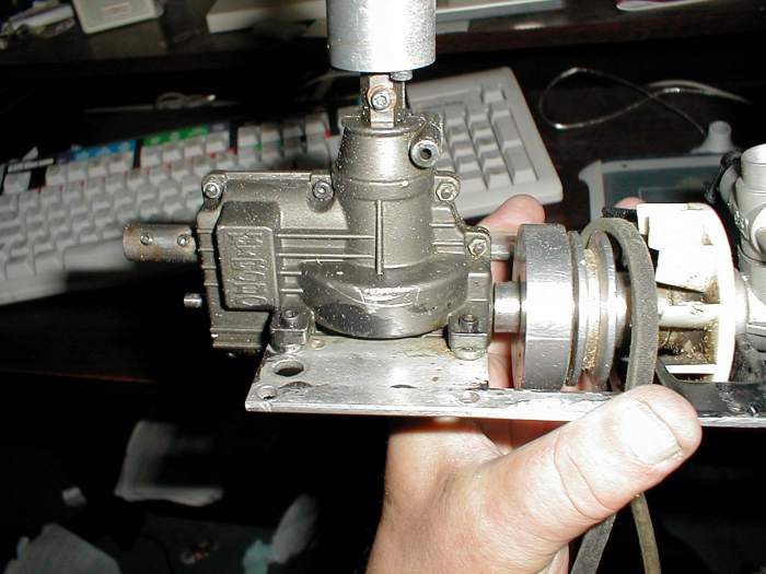

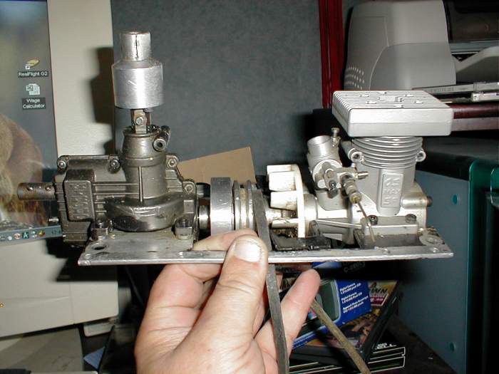

Hi guys.
Could any one give me any information on the Hirobo mechanics and the Hirobo Cobra as I am going to restore them.
Pics,manuals or anything at all.
Thanks guys.
Roy

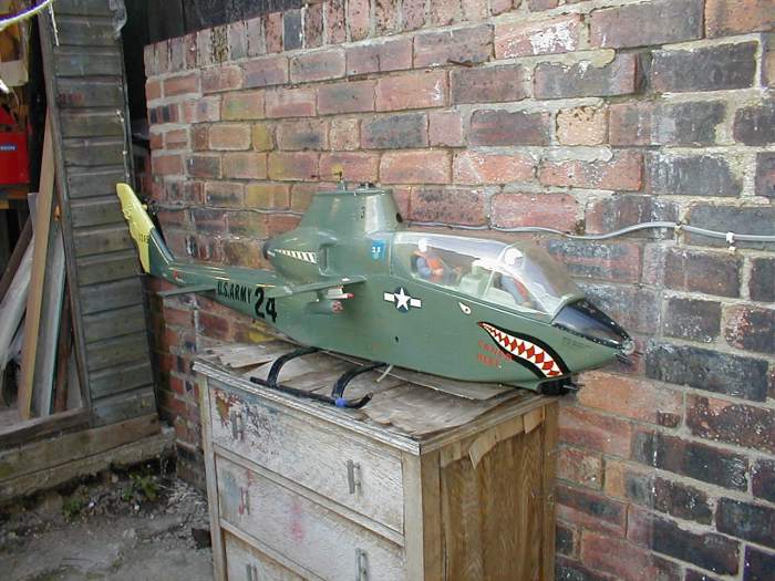

Here we are.

Wish I could give you more than advice, but I think you will have trouble as those flat beds were only made back in the 70-80 era and I doubt that there are any parts around other than those that can be had by posting for whole birds to use as parts.I would imagine that it would be easier and better to just use the fuse and put it around a modern day mechanics , as those flat beds usually had heating problems in the gearbox as well as the engine and just weren't geared right to fly good.

The lesser temp might help ,but I think the problem was in the plastic case housing the input bearing from the engine.The engine would get so hot that it would transfer the heat into the gear box bearing and then distort the plastic housing which would then allow the gears to misalign and strip.They made an upgrade out of aluminum that did help.If you have all the parts I would try it and maybe if you don't run the engine to lean and to long at a time it might last.I would also try to build a fan housing and maybe install an extra electric computer type fan to make the cooling exit the fuse as most of them just blew back over the engine and right up into the front of the fuse and then it recirculated in the fuse making things really hot.
If I was to put in a modern mechnics ,it would probably be the xcell type as they are pretty easy to mount in to about anthing and if the stacked frame version is to wide then maybe the older bent frame or the new fury type would be narrow enough.

Hi.
And here are the photos of the fuse.
Roy.

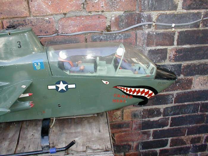

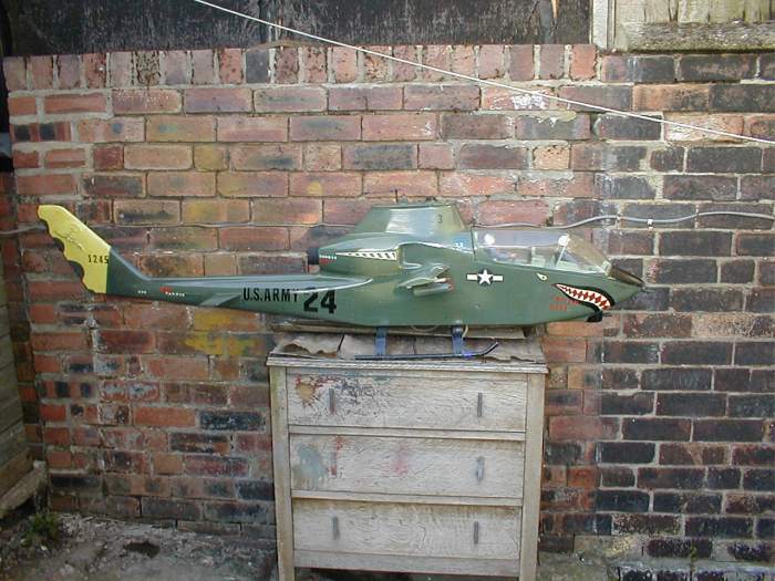

And another.

Keep em coming ,it looks like some one really put some time into that fuse.
Good luck in getting it in the air.

Anyone know witch cobra it is from the pics.
Thanks again Steve.
Roy.

u need a shroud that separates above and below the frames (i have one built from thin ply) u can cut and shut a suitable 60 size one or make a plug and do up a glass one (my choice ) instead of ending the shroud u must take it past the cylinder and head then make a 90 deg bend to channel the hot air out of the fuze ,a piece of piss really , and an aircraft head was all that was used in the early ones ,
