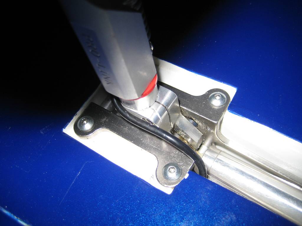

I am having some difficulty with the Dragon retract units (mains).
First, I'm not having very good luck securing the strut post in the trunions. The original struts simply would not not fasten in the trunions solidly, they would rotate at the smallest side load on the wheels. The lower strut also has a tendency to rotate on the scissor clamp(at the most inoportune time). I recently exchanged the struts for Pro-Links hoping they would secure better. I've knurled the strut post and inside of the truntions in hope the trunions would secure the post better. On my last time out one of the Pro-links rotated in the trunion, not completely, but it did come loose enough so you could rotate it slightly by hand.
Anyone have this same problem? Anyone with a solution to the problem?
The nose gear seems to attach to its trunion solidly, but that is a different strut post (steering).

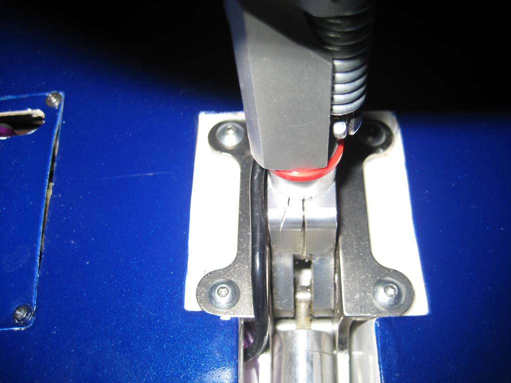

Secondly, one of the trunions has now split on the bolt head side of the trunion - See attached pictures.
Anyone have this problem?
Is replacing the entire main retract units the solution?
Any ideas for correcting this problem would be greatly appreciated.

The opening in the trunion is made a fraction to big on some of the Airpower retracts. Seen it many times.
A solution except for returning them for new ones, is to use alu tape one or two rounds around the strut. Then remove the screw in the trunion and force it a bit more open with a flat screw driver so you can insert the strut without damaging the tape.
Worked well for me.

There is a very simple solution I discovered years ago when I came across the same issue on some Asian gear. Just drill the side of the trunion and tap for a setscrew. 4/40 or 6/32 is fine. Put the strut in the retract but dont tighten the clamp bolt. Center up the wheel with the normal tad of toe in then lightly snug up the set screw against the strut. Now tighten up the clamp bolt and your good to go. The setscrew will take up any tolerance issue with the trunion plus give additional restraint against rotation.

Thanks everyone for your helpful feedback.
I think Todd's solution may be the most effective, although I will use the aluminum tape also if the strut/trunion fitment is too loose.
rcand,
I considered replacing the retract units themselves, but since I've dropped about $400 in struts/wheels/brakes already, I'm trying to save a little money keeping the retract units.
However if the replacement trunion blocks aren't readily available from SM/X-treme Jet, then I'll definetly be giving Todd a call.
