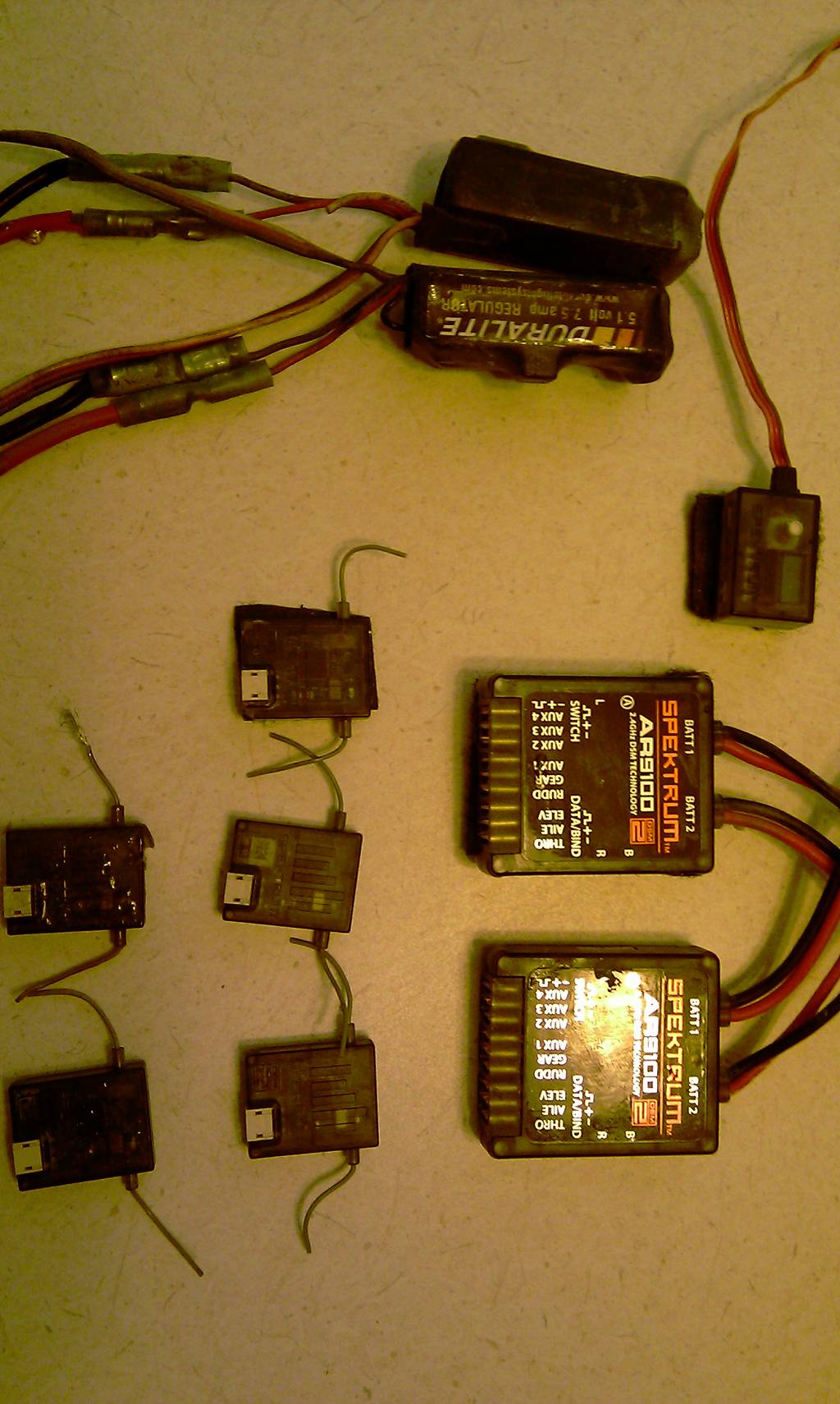

Well after loosing another jet last month I fixed it by selling everything I owned that was spektrum. I am done with the problems. I had one plane that never went into fail safe just simply flew away.

Old 10-24-2010 | 10:25 PM
bevar's Avatar
My Feedback: (27)
Posts: 3,440
From: Lake Worth, FL
Default RE: Temp loss of control
Looking at your pictures, I'm wondering where your problems are originating from.
Duralite regulators?
The crimp connectors you are using?
Install issues?
Batteries?
The pictures alone raises enough questions to answer before you look at Spektrum.
Just a thought...
Beave
