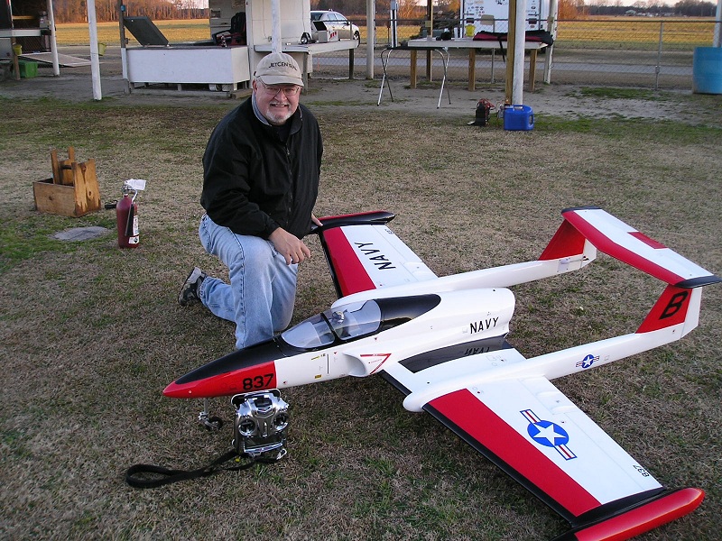

Had a decent break in the weather this afternoon and got the bird in the air.
Put in 5 flights and nothing fell or blew off so all was good. This thing is definitely different from my other two jets. Very agile but felt kinda slow till you get the throttle up tad bit over half and then it seems to move pretty smartly. I didn't get any speeds because my bud with the Stalker was out of town. Took a couple of clicks of down elevator and a click of aileron and that got it close. Way to much elevator first flight. By the third I had it close. I don't know about the C/G just yet. After the third flight, I took 6 oz out of the nose. Couldn't tell any difference. Inverted required a slight push on the stick but very little, I would think with the airfoil it has this would be the case even if it was dead neutral.
At full throttle it wanted to nose down a hair. Trim to level and it wanted to climb slightly at lower throttle settings. Next chance I get to fly will put the weight back in the nose and see if that helps. i was really worried about the weight and that verticals with my JC Super Eagle would be lacking. However the vertical was very good with this motor (30 LBS) especially if you get a little run on before pulling up. Rolls really well on the up and down lines. I think I might have too much rudder however as for me in knife edge it wanted to roll out. That could be an indication of an not quite where it needs to be C/G.
I have a little window of opportunity in the morning to keep a couple of more flight s in before rain moves in and then it looks like Xmas before the weather is decent around here again. As I get a more definite feel for the control throws I will post them here. I like this plane, flys fast, flys slow, looks very nice in the air. Just gotta trim out a few things.
I have a short Video that I am compiling from one of the flights today. Its not going to be very good as my son is very heavy on the zoom and keep losing the plane but it does show that it flys. Will post it soon. EDIT: Video should be here now. Will get a better one later.
More later.
mike

1/2" up, 1/2' down seems to work well for the elevator throw for most flying, need to set up a second rate with a bit more to tighten up my rolling circles. I have 20 degrees on both sides of the ailerons and seems comfortable. Currently 20 degrees both sides of the rudders, but will try some more.
To me the the plane feels the best with the c/g 1/2 inch behind the front wing tube. I've been back further but what is happening to me is that the plane starts to feel a little darty in the vertical plane on high speed passes and at lower throttle settings would balloon slightly. Could possibly do a throttle/elevator mix to offset that but moving the c/g just a tad forward takes care of it just fine. With the suggested c/g on the wing tube the nose tucks slightly in rolls and takes a bit of down elevator push inverted.
Here is another video. Once again I apologize for the quality. Need to quit buying planes and buy a better camera.
Be safe!
mike

My biggest problem now is figuring out whether to fly with the tanks or not. Plane looks really good with the tanks but it flies a bit more nimble without them. Still aerobatic but just not as crisp. On the other hand I bought the dang thing cause I liked the tip tanks!!
Oh decisions, decisions!!

Got some radar readings today using my Jet Central Super Eagle turned up to its full thrust of 30 LBS
Using a Stalker Sport radar gun and not diving at the gun, with about an 4-5 MPH headwind got readings of 164mph, 165mph, qnd 168mph.
One run with the wind netted 175 mph.
This was with the tip tanks installed.
My PST Reaction by comparison was flying in the mid 180's with the same motor. So a little bit of a loss but not too bad for a larger airplane.
More later.
Take care and happy New Year!
mike

Hi Alan.
We did just that yesterday, got some speeds with the tip tanks installed.
But I am afraid that you are going to be disappointed.
The tip tanks only accounted for a 2-4 mph loss. Pretty insignificant and pretty surprising as I was thinking like you.
Maybe its your pointy front, blunt rear design that works better than the more conventional way tanks are mounted.
But everybody that sees the plane comments on how much better it presents with the tanks on. So back on they will go.
As far as the speed with the 160, I don't know right now but my plans are to purchase a Jet Central Rhino by springtime and then maybe I can find out.
The radar gun that I use is a STALKER Sport that I purchased several years ago when I was hot and heavy into RC boat racing. Our club at the time purchased a STALKER Pro after comparing several different units and finding out the Stalkers where the only gun at the time that would pick up a boat at a safe distance consistently. several others required that the boat get so close at high speed before they would pick them up that it was dangerous. Stalkers ain't cheap but they work. I recently purchased the gun back from another club member that picked it up from me couple seasons ago.
I want to make it down to Florida and hang out with you. I just have to find some one close by to go and share gas and motel with me. My wife and I will actually be in Daytona 3 weeks before for the Daytona 500 race for our anniversary. But to make two trips down there within 3 weeks of each other is just a little bit to much on my own. If I get a travel partner though I will be there and will have the radar gun with me if some one with a 160 size motor in a Torus shows up.
Take care
mike

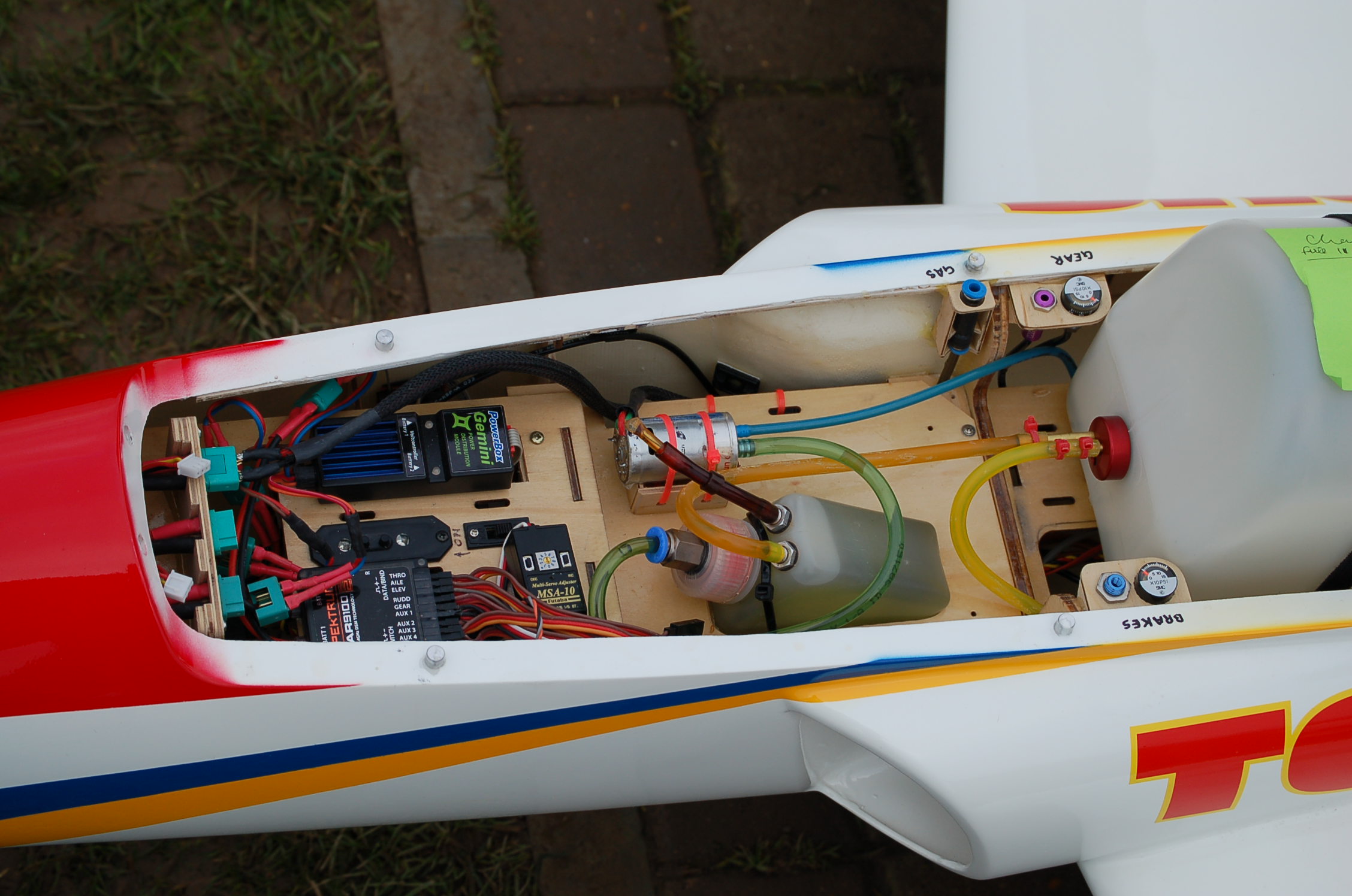

I'm just completeing the turbine install in mine, then on to finishing off the receiver wiring installation and fuel system plumbing.
I managed to find a nice big smoke tank to install between the formers in front of the main tank. Smoke On!
