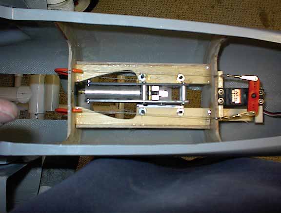

Well I thought I would start a thread on this jet I am building. I went and picked the kit up from Malcolm a few weeks ago and started working on it a week ago. This is a really nice kit, but the instructions need a bit reworking. When they say the kit comes 70% done, they mean it. I hope to have this completed by the end of the month.
Well I was going to put my Simjet 3000 engine I original got for my Euro Fighter in it, but now its not performing the thrust even for this one. So looks like I am going have to get with Keven and Ed more on the engine before I decide to use it in this project.
Dave

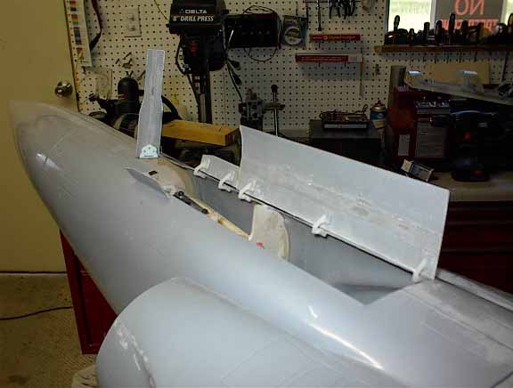

Here are the nose doors.

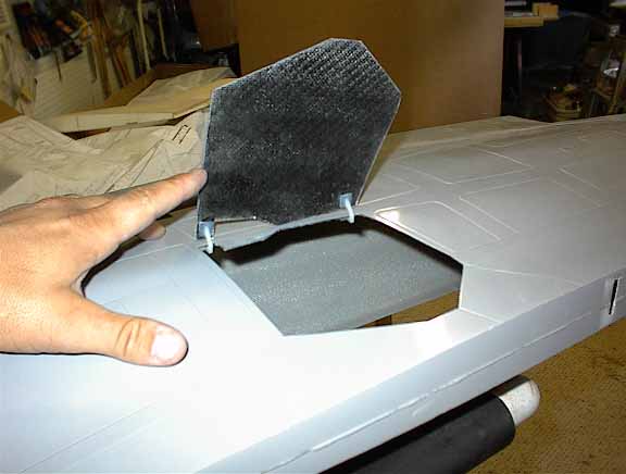

Here are the main doors cut out, man that was a easy cut as the have really nice lines to follow... also the panel lines on this jet are remarkable.

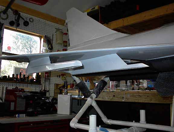

here are the missle rails it took some time to get the blind nuts up in the tips of the wing but I managed...

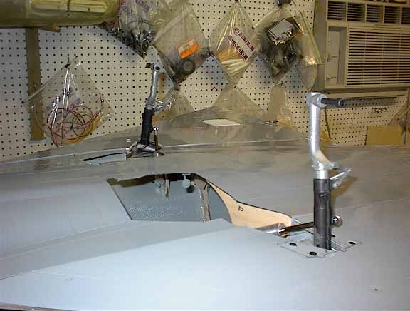

The retracts are in and was that a job. took me 4 hours just to get them in. Now I have to tweek them a bit.

What type of material is the red tubing the nose gear steering is running thru. in pic one? That maybe a good way to make mine.
Thank
Old 08-01-2003 | 07:27 PM
My Feedback: (31)
Posts: 1,004
From: Lady Lake, FL
Default Mirage 2000
it is a low gage type of plastic tub that I heated with a heat gun and wraped it around a pipe to get a good form. you could probably get it a hardware store.
Dave

Dave,
Your first hard landing on the nose gear will crack those wood rails right where the narrow part is. The supplied mounts are kind of soft, you might want to "cap" them now with some good ole ply rails.
Vin...
Old 08-01-2003 | 10:53 PM
My Feedback: (31)
Posts: 1,004
From: Lady Lake, FL
Default Mirage 2000
Vincent, there is ply caps on the ends but I was thinkging of adding carbon fiber plate on top. Thanks for the heads up...

I ran two rails across the top and spanned the bulkheads (after they cracked of course).
Vin...

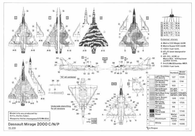

Old 08-02-2003 | 08:35 AM
My Feedback: (17)
Posts: 1,096
From: Chevrieres, FRANCE
Default Mirage 2000
David,
your 2000 looks cool, I remember the early days when the first kits were flown with 6kg thrust JPX....flew quite well
Look at that stunning tiger scheme that was demonstrated at this year Nato tiger meet...if you are good enough at the airbrush.....;o)
Old 08-02-2003 | 08:39 AM
My Feedback: (17)
Posts: 1,096
Default Mirage 2000
EC 1/12
Old 08-02-2003 | 08:40 AM
My Feedback: (31)
Posts: 1,004
From: Lady Lake, FL
Default Mirage 2000
That is the scheme I was thanking of doing Rider-60 but still unsure, I can air brush. I will post the painting and airbrushing proccess here when I get to it.
Old 08-02-2003 | 08:47 AM
My Feedback: (31)
Posts: 1,004
From: Lady Lake, FL
Default Mirage 2000

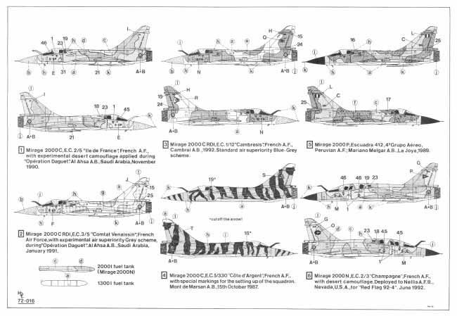

Here is the paint template for the tiger scheme I am thinking of doing...
Old 08-02-2003 | 08:53 AM
My Feedback: (31)
Posts: 1,004
From: Lady Lake, FL
Default Mirage 2000
when I do paint the scheme will come probaly out of the paint templates here.

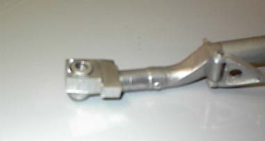

Old 08-13-2003 | 12:17 AM
My Feedback: (31)
Posts: 1,004
From: Lady Lake, FL
Default Mirage 2000
Well haven’t posted in a bit, got side tracked with the kids going back to school. I have finally finished the retracts and wheels took allot of tweaking and some reengineering but I managed. I had to make static aluminum blocks for BVMs wheel hubs.
Old 08-13-2003 | 12:19 AM
My Feedback: (31)
Posts: 1,004
From: Lady Lake, FL
Default Mirage 2000
Wheel hub block

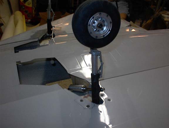

Old 08-13-2003 | 12:23 AM
My Feedback: (31)
Posts: 1,004
From: Lady Lake, FL
Default Mirage 2000
wheels now mounted on struts, makes a better looking strut with the BVM Rafale wheels installed on them.
