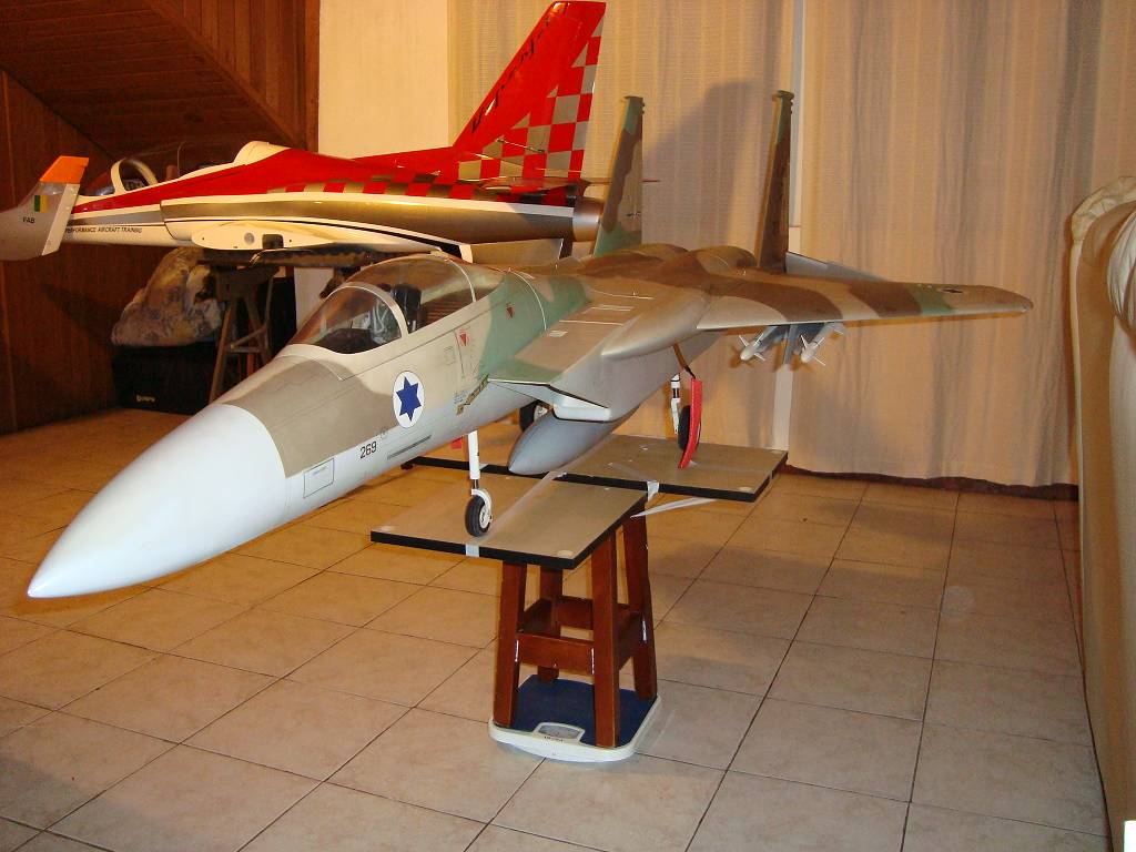

sure, weighted it with the header tank dry, with batteries and ordenance, slightly over 12 Kg or about 27 pounds.
(almost left it fall when performed this stunt, LOL)
Enrique

Enrique, gotta love Israeli air force colors !

Thanks, I like it, it´s quite unusual and different... took the idea from a RCU friend´s Mirage some years ago.
