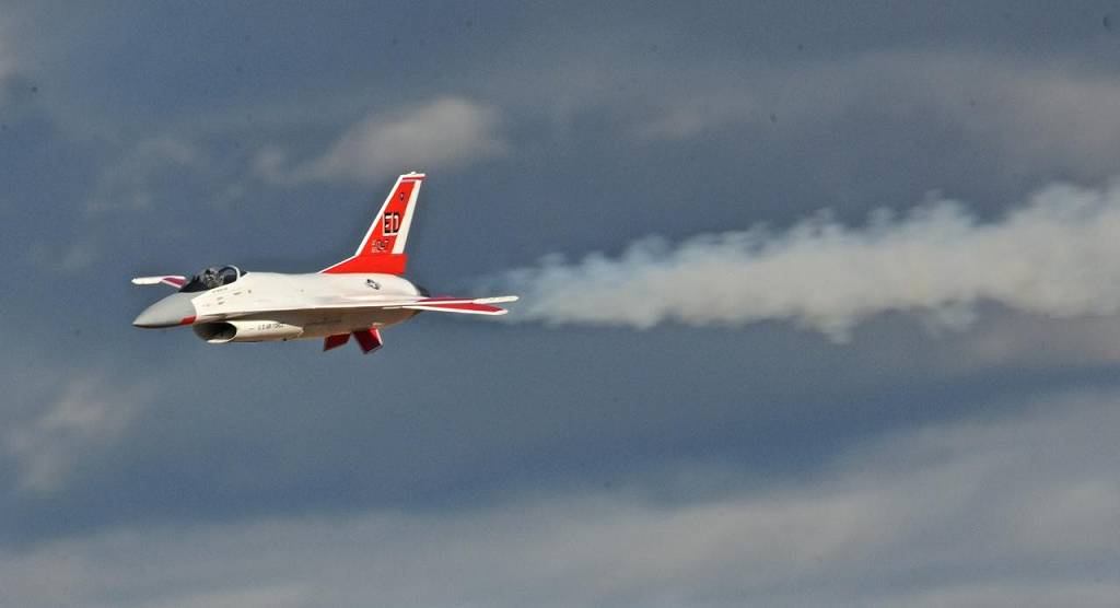

Smitty,
I've got the same setup (Tam F-16) but the brakes aren't leaking in the cold. Mind you, by cold here in Phoenix I mean 50F. The orings are also totally loaded up with grease so that may be a contributing factor too.
