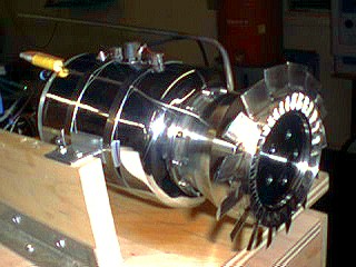

The fan is 7" in diameter and runs at 32,000 RPM
The engine is duel spool and is counter rotating to minimise the torque. I will post more pics in a few weeks as I am not at my PC right now
Alleycat,
The rear nozzles flow less air unfortunatly, but this can be ajusted with the size of the nozzle I may need gyros to hlep make it stable.
BMT,
The center of gravity and the mid point between the nozzles are
on the same plane, I am sure there will be plenty of fine tuning to do in this area also.

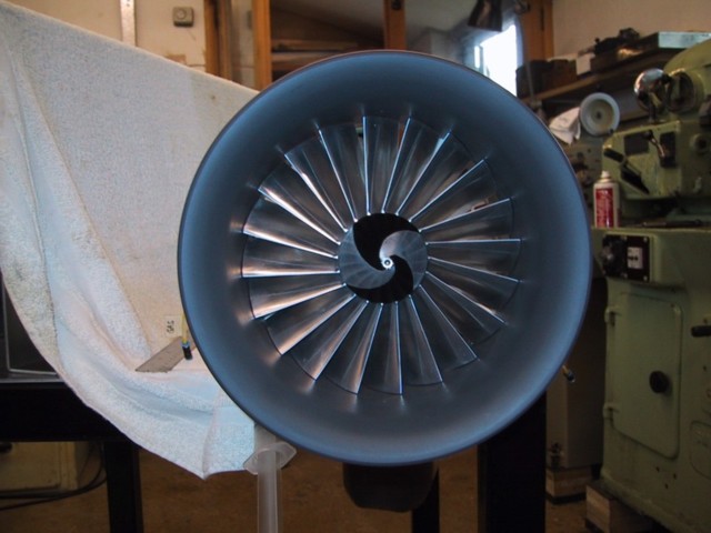

The power turbine wheel was EDM'ed out of bar stock.
The high pressure turbine wheel and power wheel are both radial and the compressor centrifugal. All of my testing was done with 3 dollar bearings on the fan and held up fine, I probably have 10 hours of run time on it and they still work great. the core runs at 100k and uses ceramic bearings. I will upgrade the fan bearings to ceramic before it is time to fly.

Go ahead and email it to me, hopefully I will be able to view it right away. If it is doable, the problem with EDM'ing is, EDM shops charge big $ for Wire EDM'ing electrodes, then to EDM the blades
at over 1 hour per burn and you may have 25 or 30 blades.

Yes there is a low pressure power turbine behind the high pressure wheel. The shaft does run through the core turbine.
This turbo fan is very close to the Rolls Royce Pegasus Turbo fan only with less compressor and turbine stages in it.

Very impressive looking fan. From what I can see there are around 30 blades slotted into an alloy hub. Have you used carbon fiber for the blades?. I take it it is a single stage fan as opposed to the rolls Royce Pegasus 3 stage LP fan?.
I would be interested to know what diameter your LP shaft is, and the general clearance you are running through the HP shaft?. This has been the head ache with our fan engine, as the core is based on the MW54, which only has a 6mm diameter compressor bore. We have enlarged that to 8mm, and taken a stress factor into account for the compressor, to allow more running clearance between the two shafts. Our fan has a 4 : 1 planetary gear reduction in the hub, due to the LP turbine running at 55000rpm, so the fan runs at 12000 rpm and is 180 mm diameter. The core engine runs at 160000 rpm, and both shafts run in the same direction. the fan rotates in the opposite direction due to the gearbox. We haven't run the engine at full power yet, but have gone to about 80% and are producing around 20 lb of thrust, full power we predict about 25, to 27 lb
What are you planning for the hot gas ducting, and nozzle's for the harrier, I should think that fabricating that little lot up will be challenging, allowing for expansion/sealing of the variable rear nozzles!!.

Yes it is a single stage fan, a 3 stage fan like the full size Pegasus would just further complicate an already comlicated project. The fan is made from prepreg carbon fiber. I am using several different materials and diameters and shapes to find the best combination for the LP shaft and have not settled on a partricular combination yet.
I will form the rear ducting, I have several drawings for the rear rotating portion but due to heat involved I have not decided on which is the best suited for the job, I will just have to start cutting metal and see what happens.

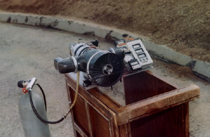

This photo from Pegasus of his ducted fan version could surely be driven from a free power turbo shaft (Wren?) as used on their helicopter or turboprop engines, instead of the i.c. engine....or two ducted fans if needed??
Eddie's thoughts on the thrust/pressure needed to balance his superb rig, may be because he balances on only one jet thrust nozzle instead of the four post pedestal approach that should be much more stable and easier to control with less thrust/pressure from the control nozzles??...any thoughts?
Regards
John
Regards
John
Originally posted by Pegasus
Here is a pic of the ducted fan version of a Peagsus
