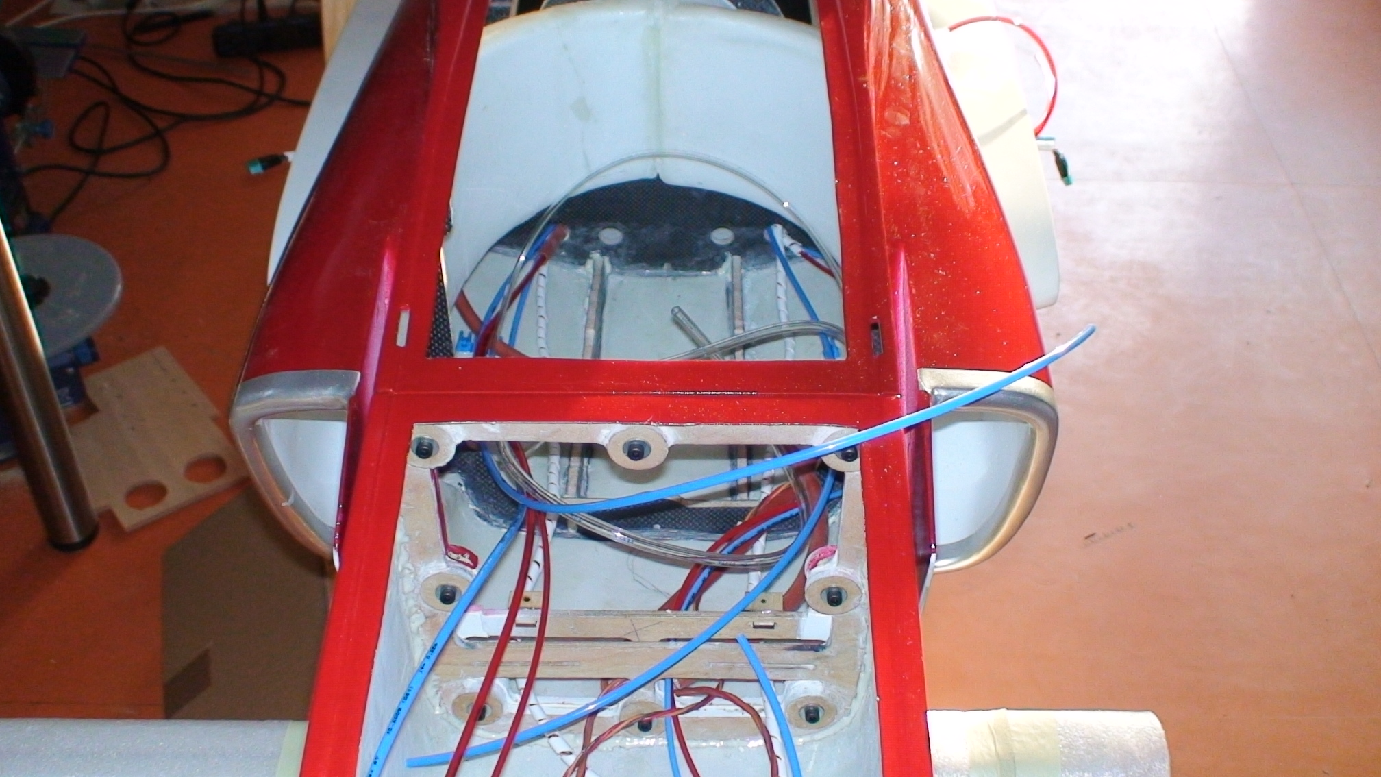

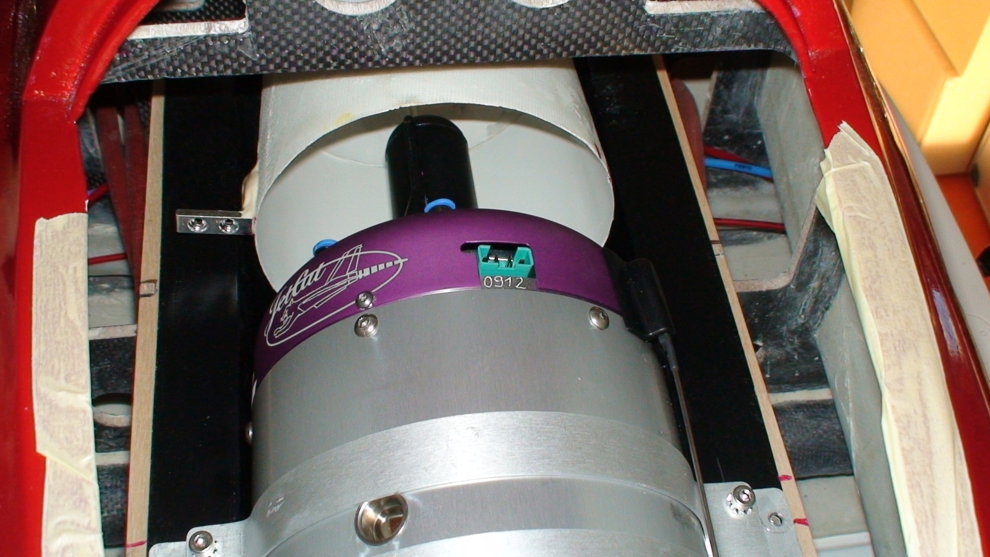

New pics with pipe installed. The back is almost finished.

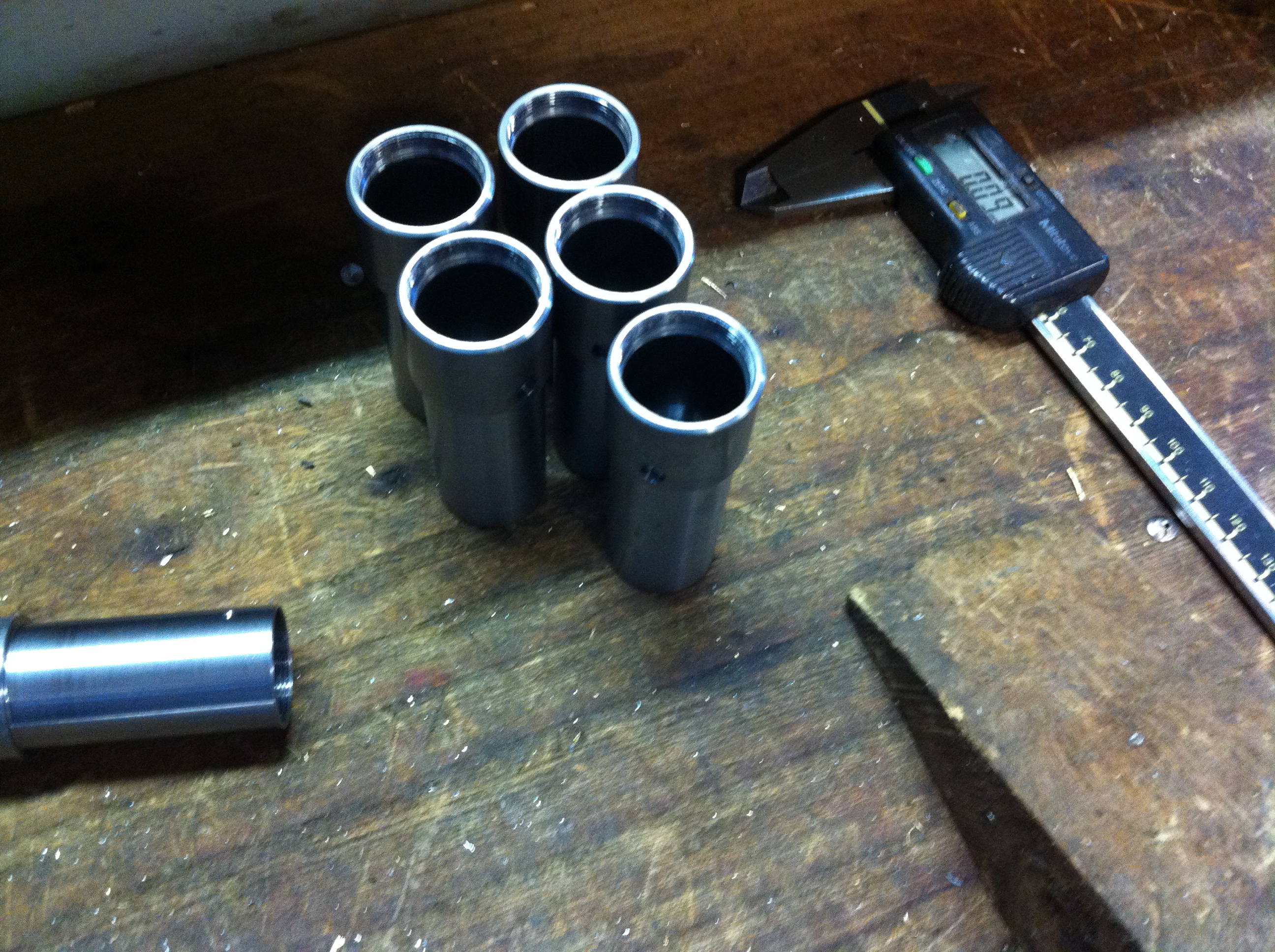

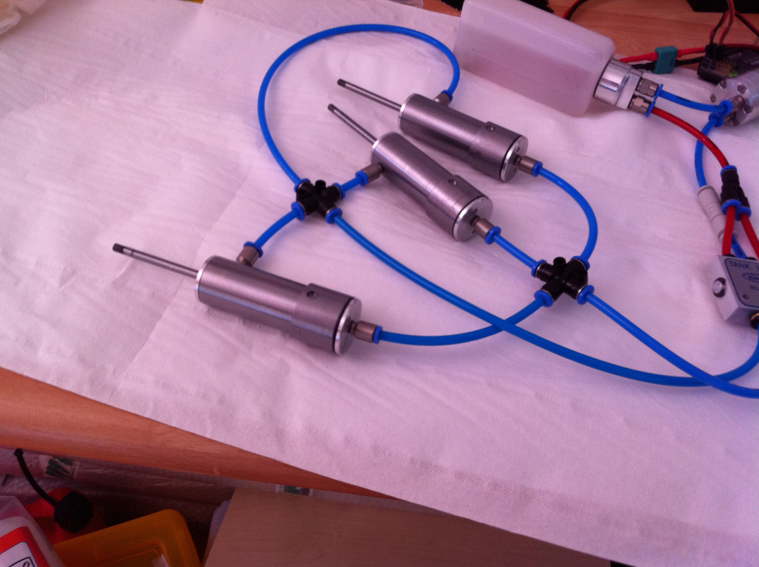

Hello. Here the pics of my new Hydraulic pistons for the Viper L. They are totally new design and construction for the use with oil. If somebody is interested in those piston we can produce in small or large quantity. We don.t know now the exactly price for single piston. Regards Enrico

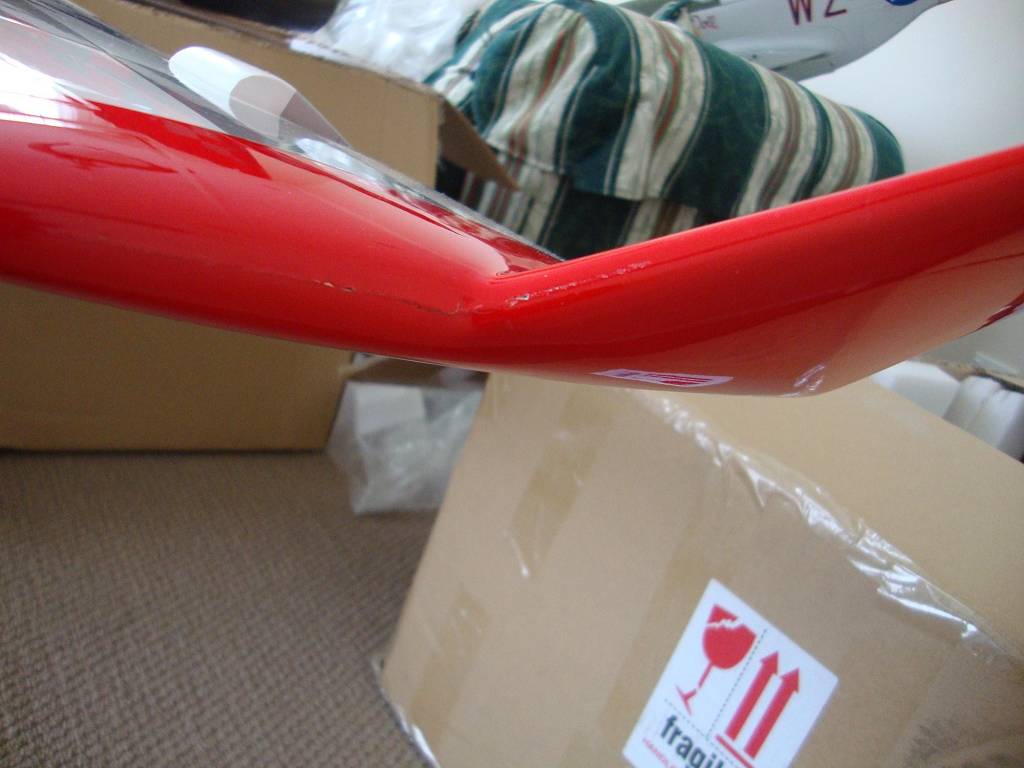

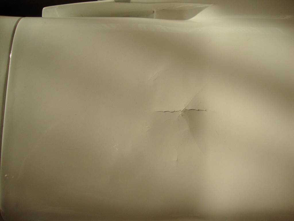

Just sorting out some quality issues with FEJ, they have been very supportive so far. Hopefully they will improve on the packaging for others shipped.
Two critical things to check when the jet arrives:
1. the winglets - if the wings move inside the box and hit the end this will apply pressure to the wing skin join and it will break
2. main fuselage (not nose section) - forward floor area is extremely thin (I think similar to Skymaster experience). Items are packaged inside the fuselage for shipping. these internal items can punch a hole in the floor from the inside out. Turn the fuselage upside down and check the bottom carefully for damage.

Still trying to get it sorted. FEJ have sent touch up paint. Original plan was to send the wings back to the factory for repair, but this is now taking forever for FEJ to organise pickup.
Might have to look at injecting some Hysol into the wingtip splits and be done with it.
When we pay a considerable amount of money for a product we shouldn't have to do any repairs on the jet when it arrives.

Enrico, how are you going to deal with the issue of the hydraulic system needing to be disconnected everytime you take your wings off? Or are you just going to leave the wings on all the time?

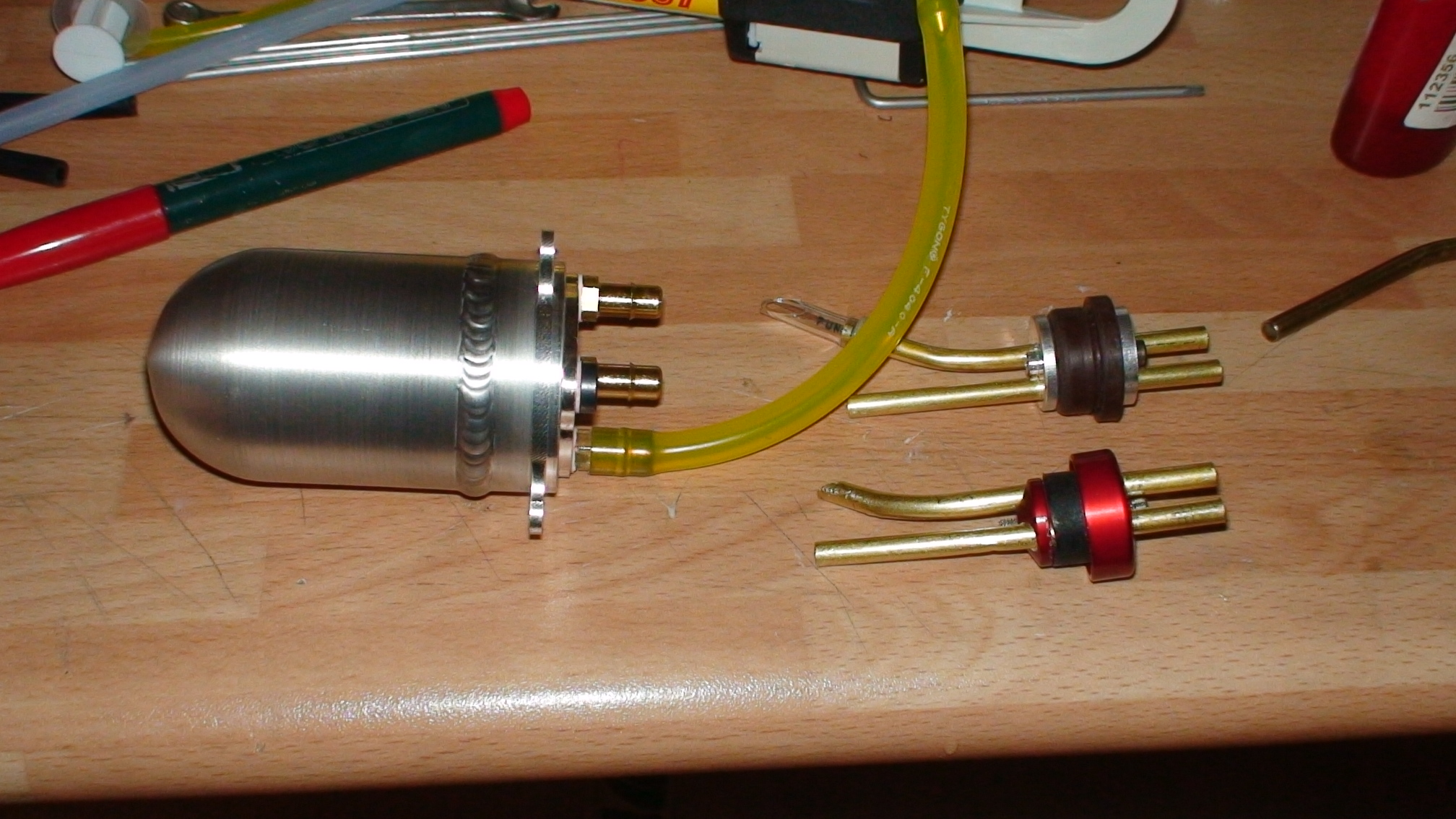

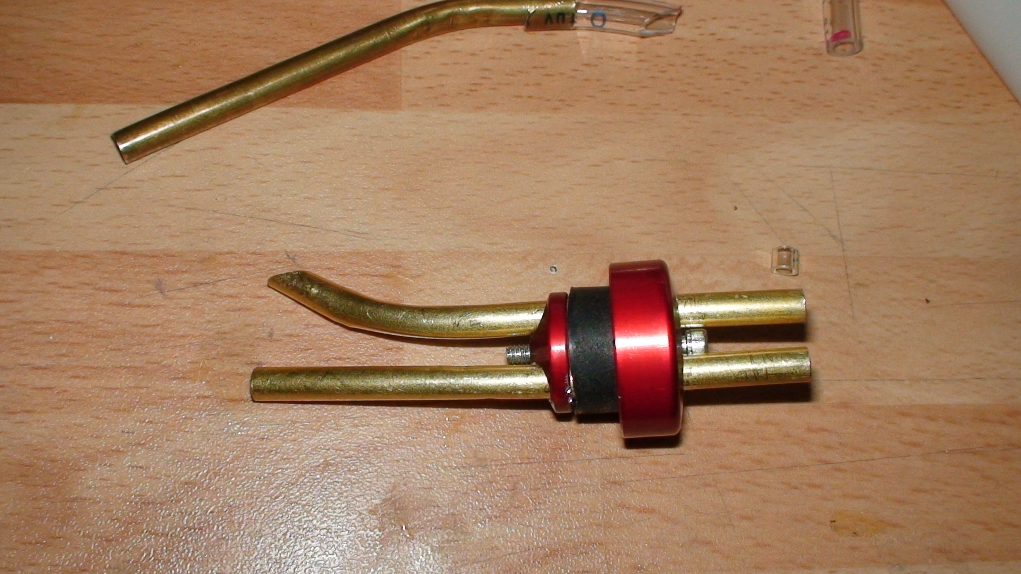

Another consideration is the fuel tanks. Tried desperately to get some photos of the fuel tanks FEJ use but couldn't until the Viper S arrived.
There are two small half tanks in the bottom of the fuselage just aft of the mid section bulkhead. Each tank completely full only has 1300mls in it, so a total of 2600mls. I'm planning on running an ATJ120Ti so think I will need at least 4000mls for a decent 10 min flight time with reserves.
Old 07-14-2011 | 04:55 PM

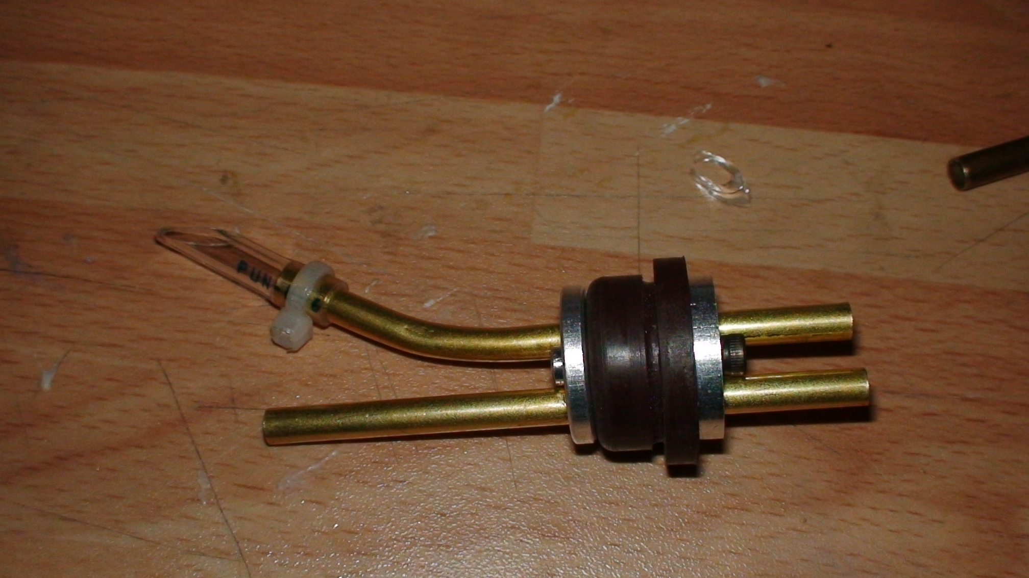

Have bought the Skymaster fuel tanks for their Viper 2.0m. The main tank is 2200mls and would sit forward of the mid section bulkhead. It is beautifully formed to fit in between the air intake tunnels in the centre of the fuselage.
Thoughts are to run the two FEJ tanks in parallel, and feed into the main tank 2200mls, then through the UAT. Probably just keep the fuel load down to the 4000mls mark.

My Viper has five fuel cells + the UAT. I am not sure of the actual capacity, but will get a measurement of it when I replace the Rhino with the Mammoth this weekend.
