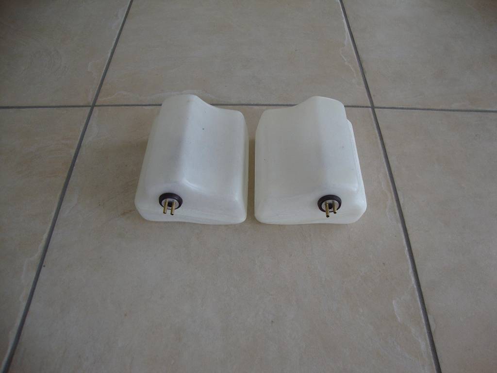

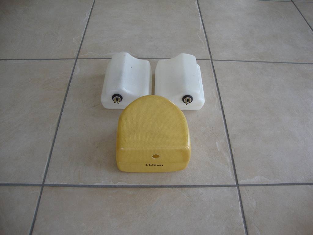

For those interested here are some pictures of the small molded FEJ Viper S tanks. Each tank holds 1300mls.
Also the Skymaster Viper 2.0m kevlar main tank together with the two FEJ tanks.
Plan to run the FEJ Viper S tanks in parallel into the kevlar main tank, then into the UAT.

ORIGINAL: Caspa1
My guess is your building the small viper ? This blog is for the new L Viper.No worries there is room for both.Just anybody buiding and care to share with us,.. just make sure you mention small or large new or old.

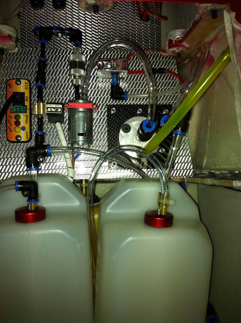

ORIGINAL: FMRR
David Jackson has the large Viper.I met him in Kentucky at the show last week(really nice guy).maybe we can get hime to post some pic's of his fuel system.Hey David are you reading this?

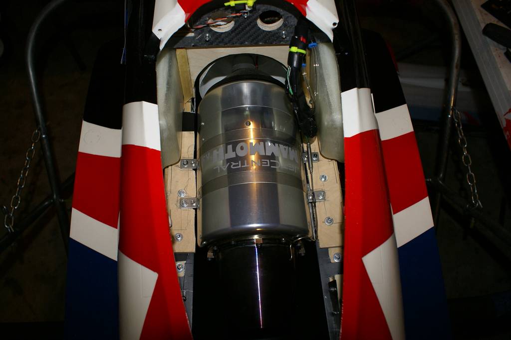

Frank,
There are five fuel tanks plus a uat installed in my Viper. The upper two fuel tanks (upper tanks held in place by former visible in pic # 3)are connected in parallel and flow into the bottom left tank. Bottom left tank flows to bottom right and from there to the main forward tank. I'm sure there's a better way, but this works for me. Don't have the exact capacity of all fuel tanks combined, but my guess is approximately 160 oz. Hope to get the exact amount in a couple of days.[8D]

From: Marietta, GA
Default RE: FEJ Viper Build
David I notice you have the Mammoth installed.Have you had a chance to fly it yet? and thanks for the pic's.
Old 07-20-2011 | 06:30 PM
  #60
My Feedback: (15)
Posts: 1,933
From: Nashville, TN
No flights with the Mammoth yet. FYI, I just noticed that my Viper wingtube slides completely into one wing half. There doesn't appear to any structure in either wing section to prevent this. This may not be a problem, but I will consider a way to prevent the wingtube from moving once the wing halves are attached to the fuse. [8D]

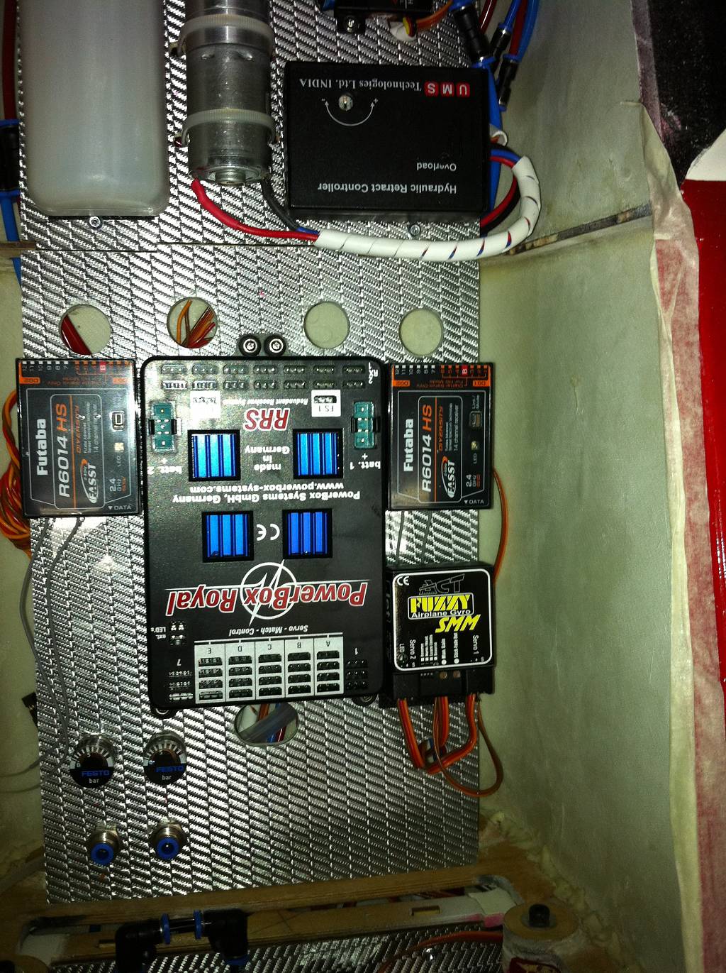

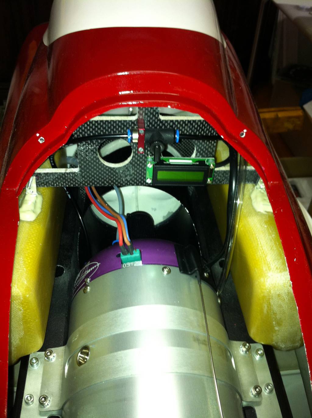

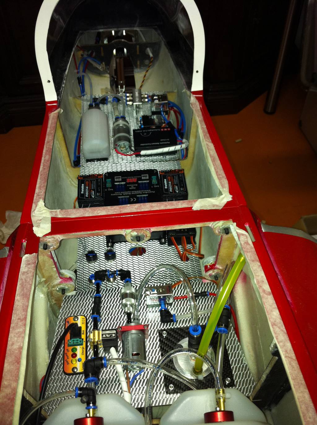

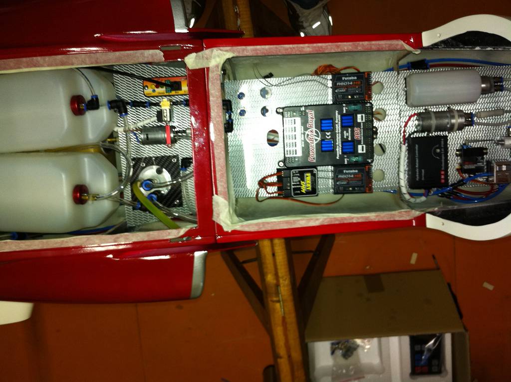

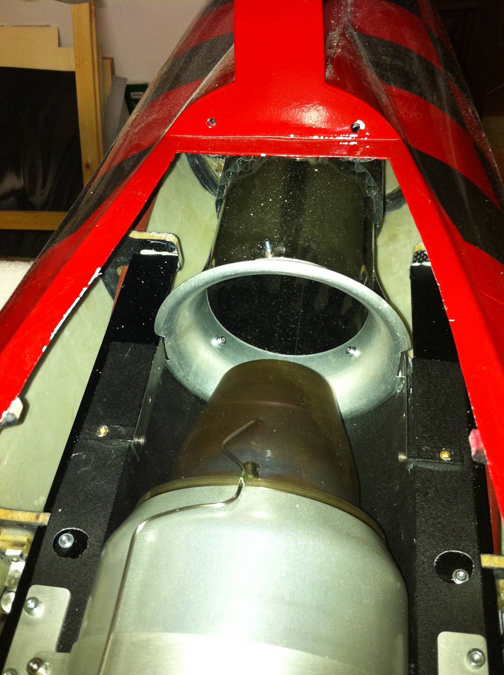

Almost completed .
