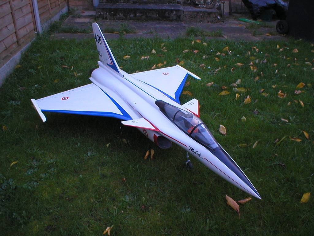

Old 12-14-2011 | 01:15 PM
Joined: Oct 2007
Posts: 772
From: london, UNITED KINGDOM
Default RE: Avonds Rafale
very happy with the performance of this little gem.
powered with p-60 and a 32oz in the middle of the front in takes and 2 x 120z at the rear.
It does do a good Harrier and pull up at 45 degree's
ID:	1699904   Click image for larger version
ID:	1699905   Click image for larger version

Another 3 flights today-from wheels up- 6minutes .20 timed and still a good 3/8th left in the front tank.
