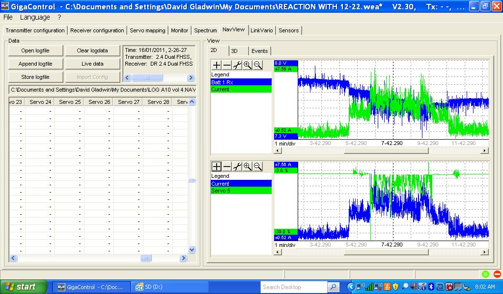

The system allows me to examine in great detail the performance of the batteries IN FLIGHT and you can plot the data on a graph or graphs, for example, voltage v current and relate that to the movement of any servo as servo positions are also logged. Its like a black box flight recorder and QAR rolled into one.
#32
Heres one which will give you the idea. The top graph plots current and voltage and one can clearly see the relationship. The time base here is condensed to 1 min per division, this can be progressively expanded upto .1 sec per division for close analysis.
The second graph (you can create as many as you wish, add any or all parameters as desired) shows current against servo position, of course voltage could also be superimposed on this diagram too.
This is 2d format. With GPS you can create 3d track format and superimpose any data on THAT track diagram.
The two possible causes of Jack's crash are also addressed by the Weatronics system :
1. It automatically connects BOTH batteries with one switch on the larger receivers and;
2. It automatically performs a load check (brief application of 7 amps) at switch on. If either battery fails this check by exceeding the voltage drop which YOU set on Giga Control it illuminates a bright red LED on the switch panel.
Almost all conceivable data is streamed back to the Tx (parameters are sampled at .1 sec intervals !) and stored on the Tx SD card, (and integral SD card in the larger DRs) however on the Micros, Smart and Clever receivers, there is no current data as they have no regulators.
All this data (and programmability) is also a feature of the tiny 8ch Smart receiver which weighs all of 16 grams with an integrated gyro. It is a full range dual receiver with downlink and one is now installed in my Savex L39/ Wren 44 combo.
Brilliant equipment.

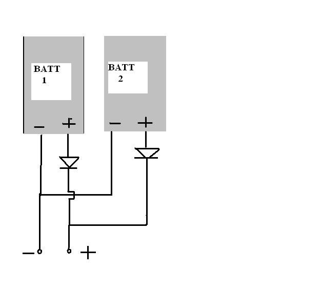

Well I am a long time believer in using twin, electrically separated Rx batteries. There is absolutely no point in having twin batteries if you do not separate them, even if is is only with a diode. Otherwise a fault on one battery system (could be the switch for example) could not only flatten one battery but the other one too.
Fortunately the answer is YES!
In the Feb/March 2001 issue of RC Jet Int. Paul Mitchell bench tested lots of dual battery siuations. For the 'model' part of the test he used a 9 channel Futaba radio with a servo test function which cycles all servos slowly & continually to the extremes of their travel, i.e. nine servos at once, no flight loads but I doubt we would operate nine servos at once over their whole travel.
The simulated 'flying session' was six ten minute flights with a 30 minute wait between flights for a total flying time of one hour.
Batteries were 1200 mAh 4 cell packs.
With one battery flat & one fully charged the result was the servos ran faultlessly for the one hour and the discharged pack showed a slight gain in voltage. This suggested there was some cross charging but it was insignificant over the one hour period.
Most importantly with one fully charged pack and one pack with three charged cells & one shorted the result was the same except the faulty pack did not increase in voltage, it started & finished at 3.9 volts.
That's a good enough result for me, try to get a copy of the article. - John.

#47
ORIGINAL: basimpsn
My opinion two batteries pack connected directly to the receiver is a better than diode isolation. Under heavy load a diode can either short (witch is better) or open. Remember if there is something onboard that would cause such circuit load, there is no way you would be able to land that plane unless you have two receiver
P.S Two battery redundancy protect your system if one battery pack cell goes high in resistance (open).
Just my opinion
ORIGINAL: PaulD
I have been using pairs of A123 batteries with 2 heavy duty switches. Never had a problem but only concern is I don't have any isolation if one battery were to go south. Been thinking about some form of diode arrangement to provide isolation but then I would have to ask - which has higher chances of failing - an A123 pack or a diode?
PaulD
PaulD
.P.S Two battery redundancy protect your system if one battery pack cell goes high in resistance (open).
Just my opinion
+1

#49
Not Really. The diode is probably the most reliable device ever invented and I have never had one fail in 20 years. Can they fail - yes! But invariably because their limitations have been exceeded, large spikes on the supply rail can take them out. But your Rx is full of small signal diodes, so if this happens you have bigger worries.
I always at least double the voltage and current requirements before buying diodes as these are simple devices that are small are very chaep. Don't skimp.
As for A123's I have not had a single problem with them so far. On this basis I could say I will save money and just fit one battery.
However, for me I look at it like an insurance policy. I really hope my wife doesn't need to pull out my life insurance policy, but it is there just in case one day she does....
We seem to have some crystal ball gazing going on here, based only on personal experience, and taking no account of wider experience or what might happen. It is up to each individual, but I prefer the peace of mind that my set up provides, based on wider experiences over a modelling lifetime.
I have had cells go short circuit (I am describing an internal short with in the cell to avaoid any confusion) and crash a model with a single battery. With Nickel based cells this was a common mode of failure and it has nothing to do with gradual cell degradation. I have also suffered a cell going open circuit. This is very rare but it happened to me, again in the days before I relied on twin batteries.
I have witnssed a fire caused by a shorted switch harness that would not have happened if there had been a diode in the system.
So I will continue to fit diodes in the hope that I never need them.
#50
