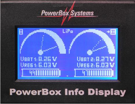

At the same time I always keep track of the voltage drop during flight through the Royal screen were there is illustration of current voltage level as well as minimum achieved during flight (dotted line in the picture).
So from now on I keep some basic rules to monitor the power source of my planes and try to protect my investment as much as possible.
