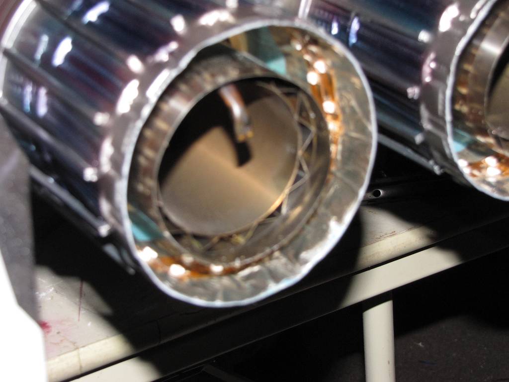

Here is my BD-5 with the copper tube running between the dual wall exhuast, 24" long exhuast pipe. I also use cement mold release from fastenal for smoke fuild.

Hi,
That looks perfect !!
So, hopefully it will work on my ship as well !!
