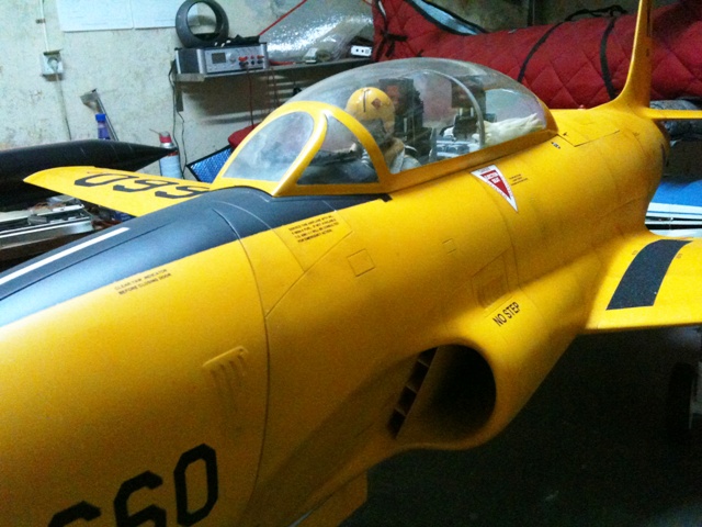

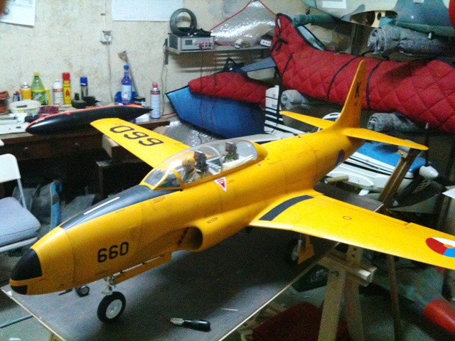

Hello,
two years ago I found an old T-33 kit from Bob Violet.
It was the ducted fan version.
Is there anybody who turned this into a turbine version? What have you changed?
Where is the centre of gravity located?
Thanks in advance
Dirk

Thanks for the comments.
I have done the "under wing modification" but still the DF duct in there. A special sattel tank system was made from fiber. The issue is, that I still have around 0.8l fuel tank between nose landing gear and the turbine.
What are your experiances in regard of CG. Is this realy on the back end of the first wing tube?

My relation to BVM is not the best (lets say like this).
This tank system was one on special offer and I ordered this and I called also Patty to confirm, that everything is ok with the order. It was, unitl another employee from BVM send me an email, that becourse o illness thay could'nt update the system in balance with the stock. I started to have an argument, but as usual, the customer is coming behind the business case. I understand this, but the kind of treating this was not ok, in my opinion.
So I have made the tanks by my own.
The quality of the product is exelent, the customer care not realy (just my point of view).
