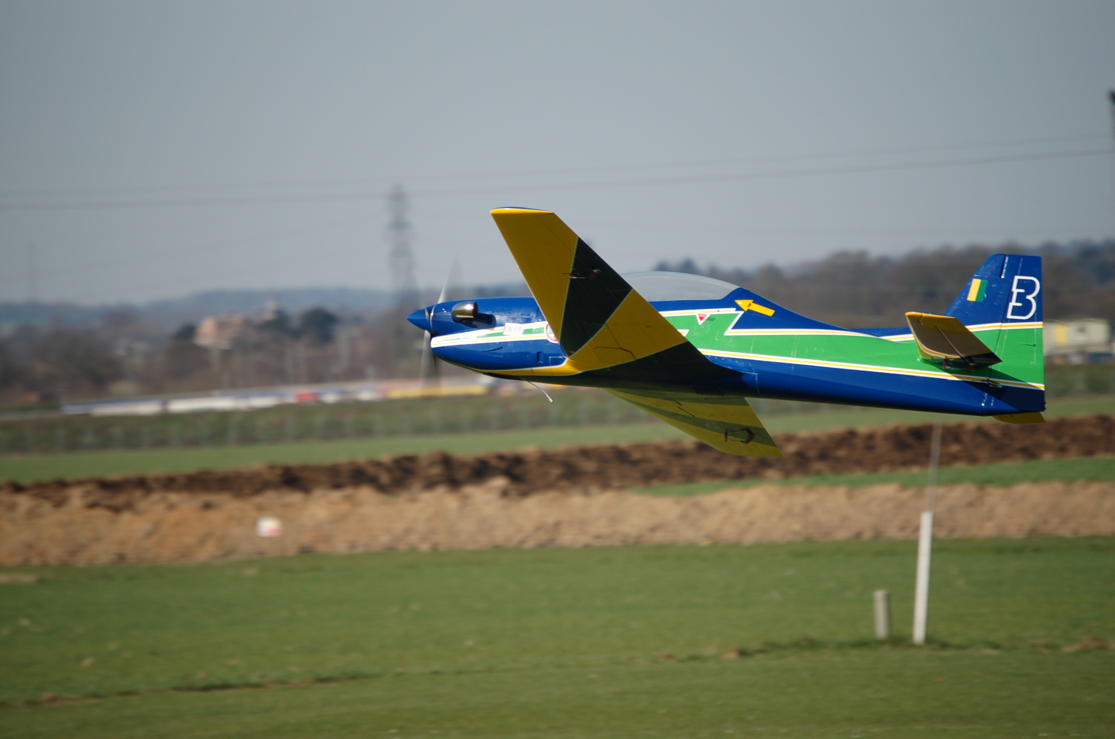

Now have 12 oz of lead up front and c of g is perfect. Another 7 flights today and a permanent grin from me
What prop are you running on yours? I'm on a 25 x 12, but got a 24 x 12 on order as the feeling is it might give it some more go for the big manoeuvres

I'm using the Beila 24 x 12. We tried a 25 x 10 on my Mate's Tucano and it still lacked the performance of mine (we both have the kero start Jet Central TPs). In my opinion, the 24 x 12 is the way to go. With the 24 x 12, you will have a different bird. If you like it now...you will really love it after you make the swap.
Congrats on your good looking machine!

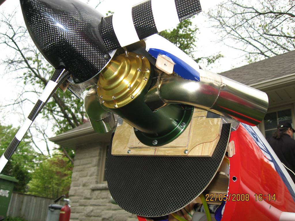

On all of the Jet Cat Tp set up's that I have run.. I found an Engle 24x14 three blade pulled the best. LEast prop noise, but noticeable performance difference. , well. For a three blade anyway..... give me a two blade Menz S prop any day of the week, for sheer performance...... yes I do know you wont have the ground clearance of the Tucano to put a two blade prop

Aussie Bart - I put the lead in the lower cowling just behind the spinner, so basically as forward as possible. Not sure where the C of G is now but I started off with the book recommendation and it now feels perfect with the 12oz in the cowl.
The 'ole LHS had a Biela 24 x 12 in stock so I used that for Sundays flying and it does make a considerable difference. Really sweet flying now and just the right sound [8D][8D].
Ali - Im sure the 24 x 14 would give it spectacular pull but Im worried about it loading up too much. I'm having so much fun with her I don't want anything to happen that puts her out of action! The SPT5 has been faultless up to now.

Colin. .It's hard to measure the "loading", but I am sure the Engle ( with its thinner, lighter and dare I say it.. more efficient blade shape ) felt like it was less loaded than the other props I tried. However.. if you are happy with what you have then stick with it. I know that on my PC21, prop selection made a considerable difference.
As long as you have the latest "larger/stronger" geared TP from Cat, I cant see it being put out of action buy a prop change. The one fitted to my PC has done 25 flights, and this is working allot harder than yours will ever do in the Tucano ( The PC is a tank in comparison), without an issue so far.

Exactly. You lose about 15 to maybe 20% efficiency switching from a 2 blade to a 3 blade on the same application but the noise footprint is considerably lower. Also, as Ali stated, you gain ground clearance which is needed on the Tucano. I use the Beila 24 x 12 because that is what is easily available, and it performs well.
