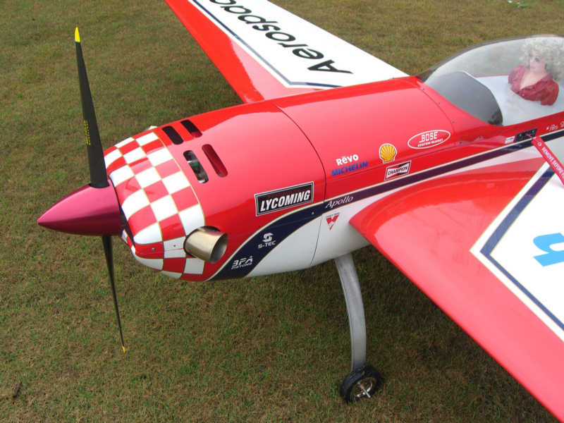

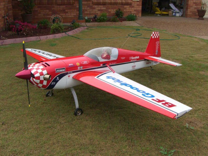

I had a Wren 54 TP in a Carden 35% Extra. It flew very well. The seperation of the cool intake air from any hot sources is very important. I made a mistake and overpropped the Wren 54 and did a lot of damage.(Overheating). Once i got the prop size right it was great. Wren had built in a great smoke system ( smoke pipes on both sides) and it produced super dense smpke. I used a Tamjets variable speed pump and Super Dri oil.
http://www.youtube.com/watch?v=bpemSYH59Mc
Over all I liked the Wren. Wren have stopped making the 54 size TP.

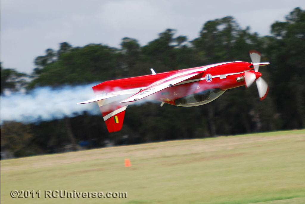

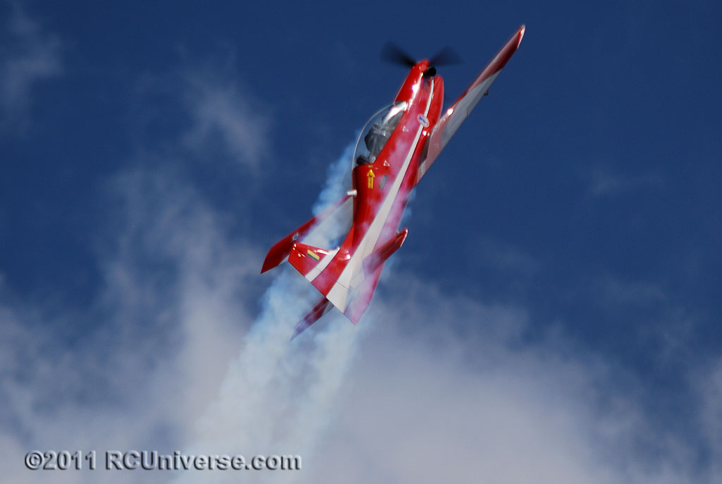

Colin.
Add 12 ounces to the nose if the C of G is in the factory recommended location and you will be right on the money.
Great looking bird Mate!
Beave

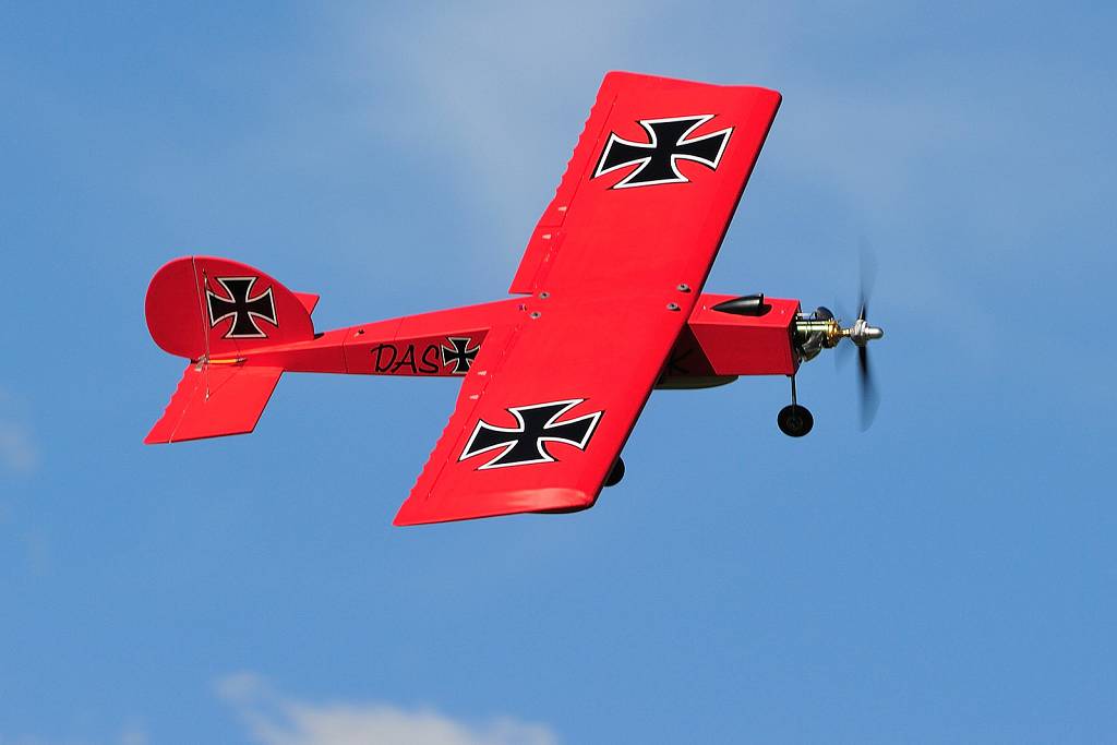

Hi Marty,
Can't say it's scale or fast....but my Wren 44 turboprop powered Das Kero Stik rocks!
Check the Stik flying at our latest ANZAC jet meet....
http://www.youtube.com/watch?v=oGNxyW2teC0
The airframe is the Bud Nosen 101" Das Ugly Stik built from a laser cut part kit and the wren 44 now has around 6 flights and god knows how many demo starts and so far it's been absolutely flawless. Starts every time, runs like a clock and sounds fantastic with the solo 3 blade 22x10 variable (static) pitch prop.
The turboprop is destined for a 134" span Fletcher FU24 ag aircraft.
