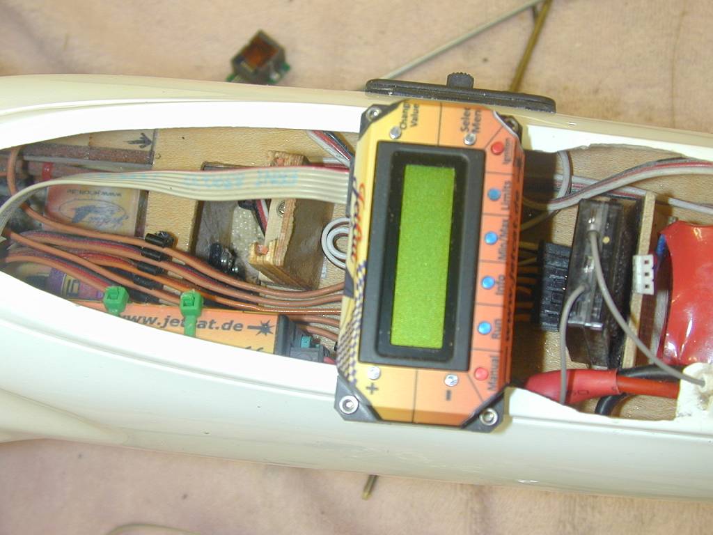

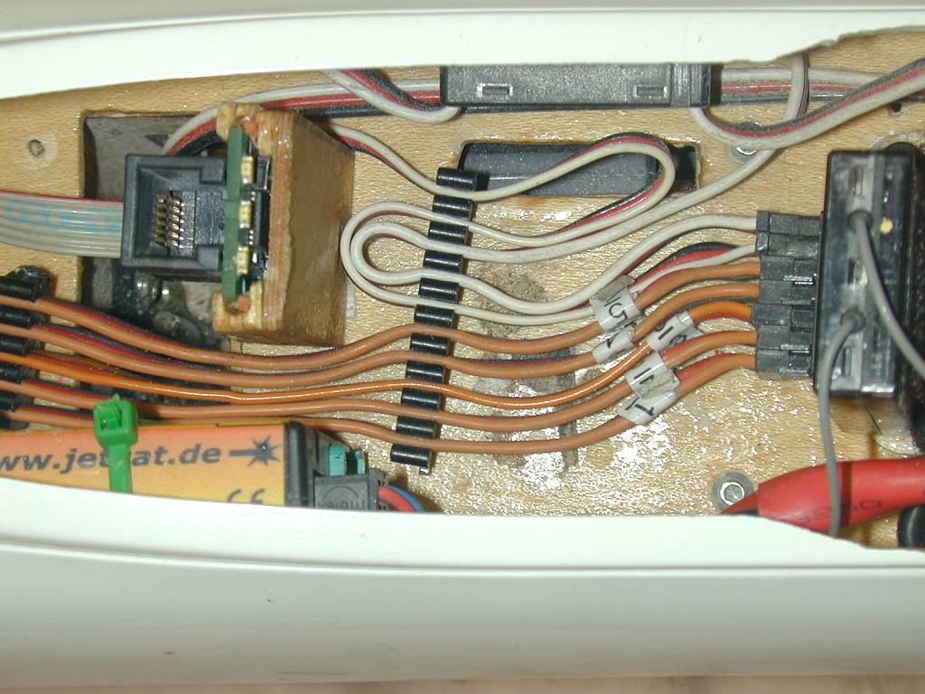

I picked one up while at Florida Jets and mounted it in my KingCat today.
I have the latest style large I/O Board, which has a socket below the LED's to connect the ribbon cable. This large I/O Board can be easily identified by the black plastic housing for the LED's.

Old 03-17-2011 | 02:49 PM
BaldEagel's Avatar
Joined: Oct 2005
Posts: 9,673
Received 6 Likes on 6 Posts
From: Kent, UNITED KINGDOM
Default RE: Jetcat Mini GSU
I have mounted the I/O board that comes with the P20 in a slide, so I can remove it from the airframe, un plug it and plug the cable into the mini GSU, have not tried it yet with the turbine run and shut off, but will let you know if it all works tomorrow after I have run it up.
I should have mentioned...mine is easily removable, as it is held to the support frame with Velcro.
It is very easy to remove if/when required for maintenance.
The support frame is made from the scrap bits of wing skin left over from cutting out the KingCat main landing gear skins during construction.
