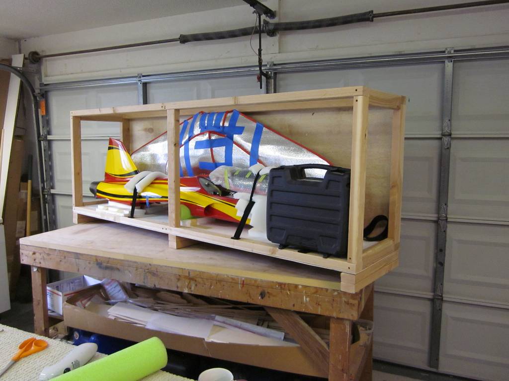

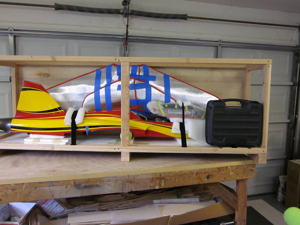

Da Rook, I just finished a crate to ship a Ultra Flash to a customer of mine.
I always take photos of my planes in the crate so I have a record of how they left here.
I use 2x3 lumber in the corners. I find it to be much straighter than 2x2 and only a few cents more money. I use the 1/4 inch luan on the sides.
Here are a few photos
