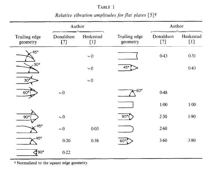

This is a figure taken from "The effect of trailing end geometry on the vibration of a circular cantilevered rod in nominally axial flow" by M.W. Wambsganssa and J.A. Jendrzejczyka.
What is shows is that for a tapered trailing edge, the angle between the two sides of the taper needs to be about 30 degrees or less for there to be a low level of induced vibrations (that can lead to larger vibrations known as flutter). A taper with an angle of 60 degrees is actually over 3 times worse than a simple flat (blunt) end and a rounded end is over 2 times worse than a blunt end. A sharp taper is not only fast, it is much less likely to flutter (which are both related, because vibrations means that there is turbulence - which is drag - which is wasted energy).
Bob

You either want the trailing edges sharp, or blunt. The pitching moments get unstable with round TE's and flutter is more possible as well as poor trimming and tracking qualities. Sharp is great, it reduces drag. Blunt is second best - small drag penalty but much easier to make consistent and hangar rash much improved. In the air I'll take sharp, and on the ground I'll take blunt. I need a shape shifting TE.
All my nicely molded pylon racer planes for electric have nearly razor sharp TE's. Those things are glass slippers - the meaning of efficient and fast.
I like the diagram Bob included! It's an easy way to show what people have "observed" over time but in an objective, measured way. I can use this for scratch builds, THANKS Bob!
