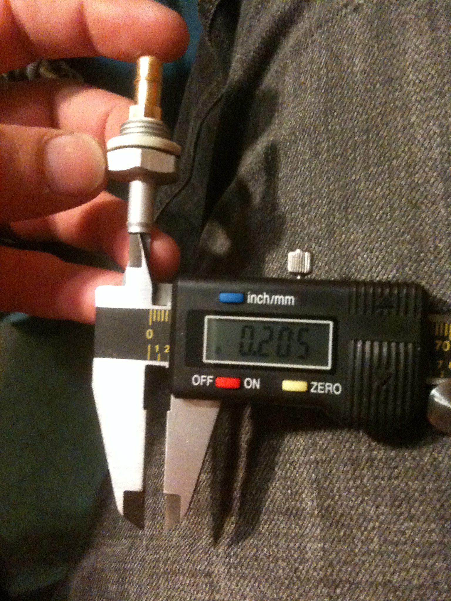

My Feedback: (11)
Max(ie full throttle) pump voltage for the P200 was 5V. I figured since 300N is 50% more thrust, the 300N engine would need 50% more pump voltage. That would mean the new, higher, full throttle pump voltage would be 7.5V.
As in my previous post, I was not able to test out the system at this voltage. I had to settle for 6V. With the understanding that when I was able to give my engine full throttle, I would note the pump voltage and then come back and test the integrity of my system.
The problem I ran into, testing my fuel system at 6v, is about 2 minutes in, I thought I was seeing bubbles coming out of the center nipple out of my large CAT air trap.
And indeed, there were bubbles.
Not acceptable.
Either
A: The system is cavitating (there was NO air in the CAT)
B: This new center fuel tubing I placed is leaking and allowing air to be sucked in. I must admit that I'm not to happy about the way I placed my safety wire. I will redo that and revaluate.
An air bubble in this line will likely cause a flameout, is something that can never be tolerated and immediately grounds an airplane.
I will find the source of the bubble before continuing.

Yup, cavitation has reared it's ugly head again.
I ended up disassembling my entire fuel system to try to isolate which tank and/or pick up was causing the cavitation and all three tanks hooked up individually all 'caused cavitation.
Also, in my possession were two brand new JMP accumulators that I tried out as well and they had more cavitation than that CAT, just like my previous tests a few years ago.
This makes me believe that the CAT is just not quite up to the job of feeding this beast. Even with my tanks (all individually tested) at a much higher level with the CAT (to help with gravity feed) at 50W, cavitation was occurring.
Before I even try to go further with this engine, this cavitation needs to be figured out. I will completely rebuild my fuel system and will buy that new Large 450 cc CAT.
And Oli, the engine started silky smooth in that orientation.
Also, the fuel pump doesn't even get warm after repeated tests! I'll post some pics with my infrared thermometer before and after for some real numbers.

Give BV's Hi flow fuel system a try.. I noticed the same thing when using the 6MM system with my P300 and then when I switched over to the the Hi Flow (8mm) the problem was solved... You got to make the "pickup line" and "vent line" in each tank 8MM with huge brass clunk and use 8mm festo tee's.. the UAT is also 8mm...
Using the old 6mm lines from your P200 is not sufficient for this beast...

My Ultra B has had more fuel combinations (UAT, JMP, CAT's) different clunks, pickups etc...Some even custom made by me and I've never been satisfied with the fuel delivery performance.
It has been my opinion that the fuel system was just barely able to supply the P200. Any "special need" situation would cause cavitation and hence a flame out.
I've had more "Low RPM" flame outs in this Ultra B than all of my jet flying career combined. I've gotten lucky every time, even on short fields.
BV's new system isn't cheap at $600, but I was going to spend $450-$500 with the bigger CAT, pleated clunk and bigger fittings. Yeah, I hate building those BV tanks, but they are the best in the business.
Time to give my favorite person, Patty Generali, another call! LOL!
