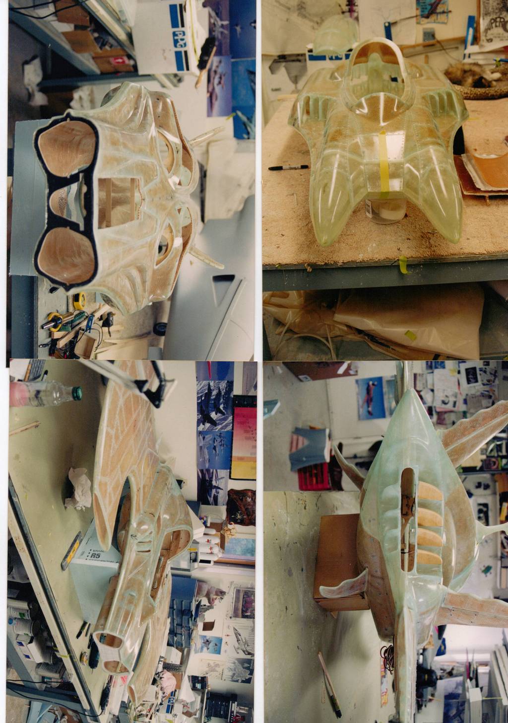

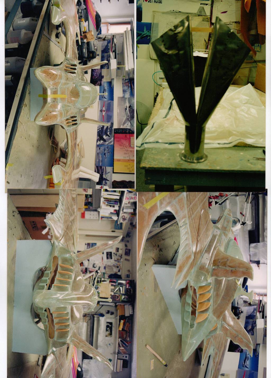

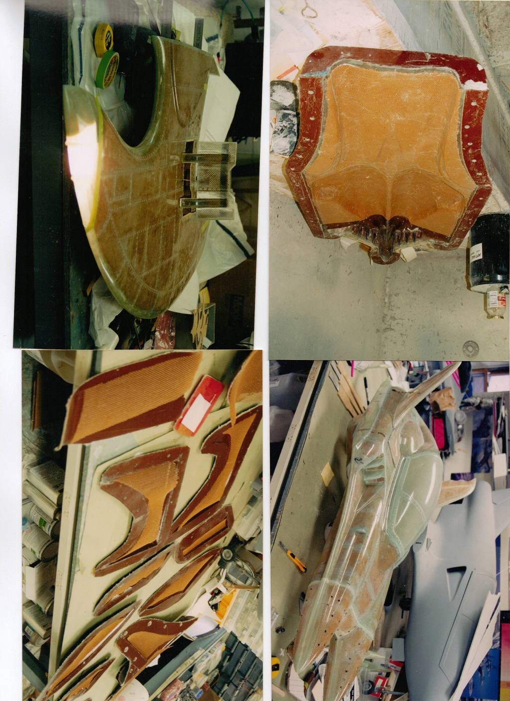

here are some pix of the batwing build
ID:	1655832   Click image for larger version
ID:	1655833   Click image for larger version

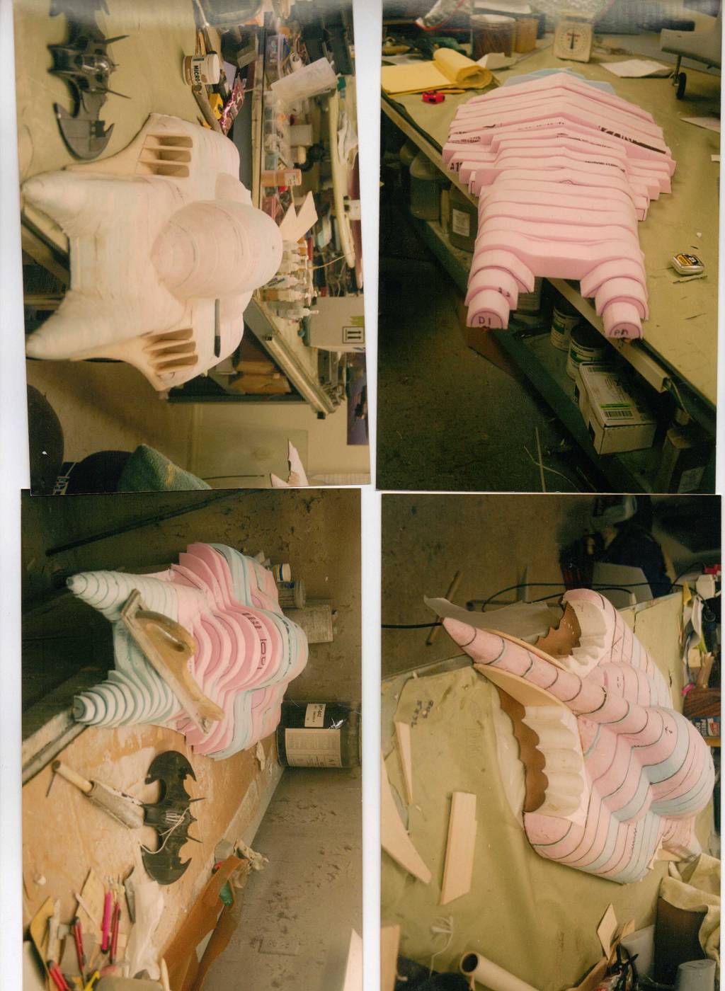

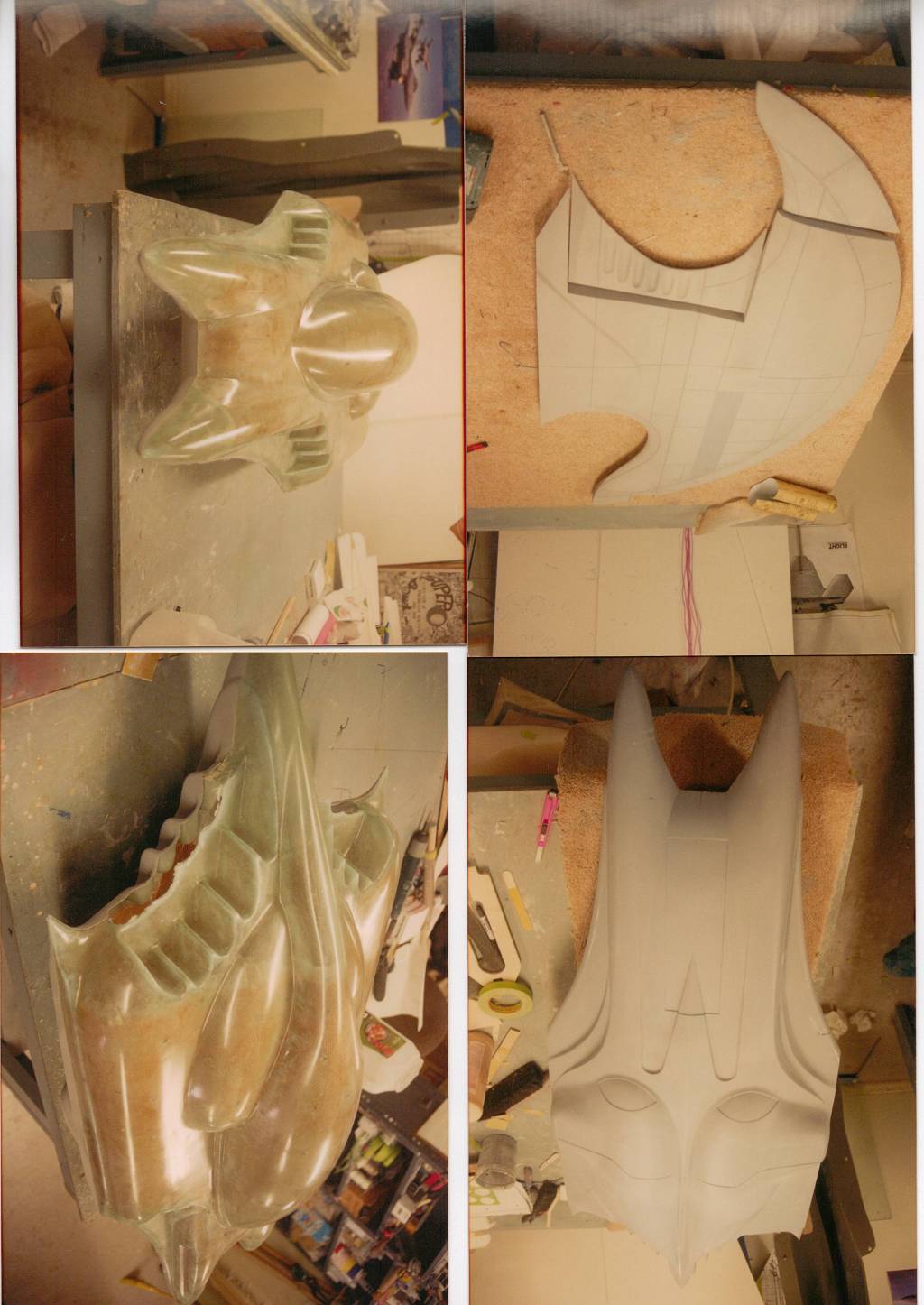

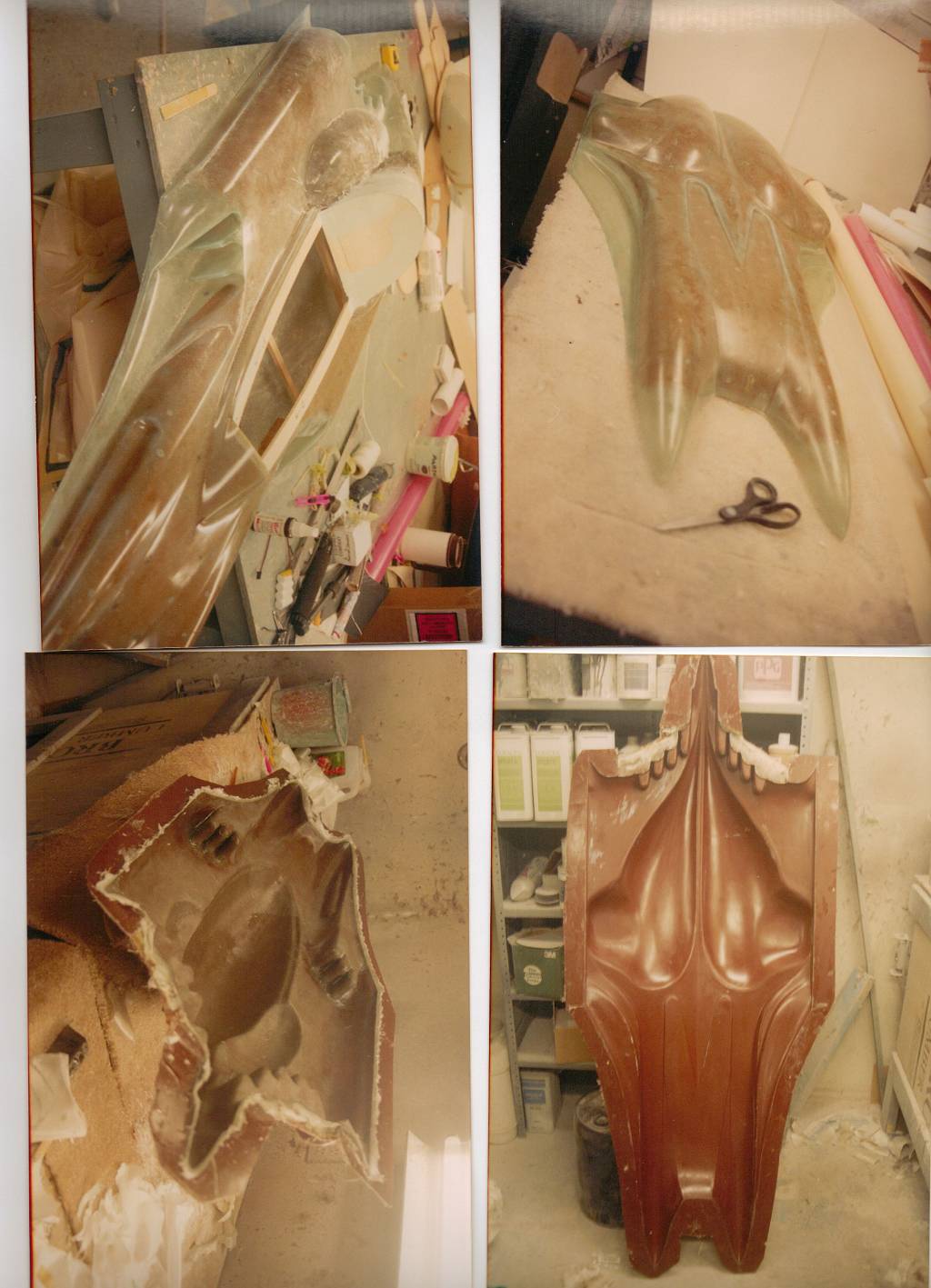

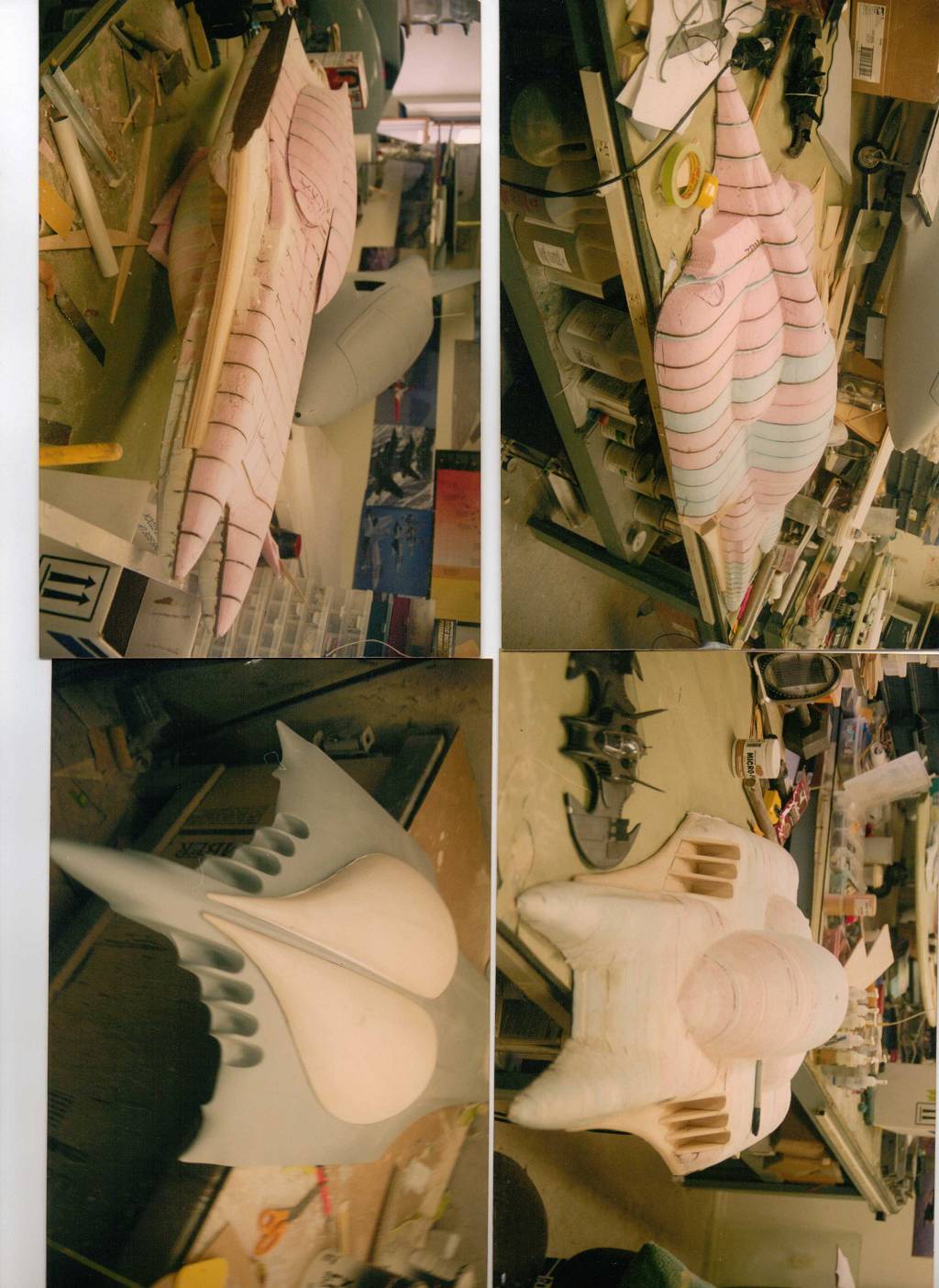

Here are some old build pics of plugssorry if there are any dups
ID:	1656313   Click image for larger version
ID:	1656314   Click image for larger version
ID:	1656315   Click image for larger version
ID:	1656316   Click image for larger version
ID:	1656317   Click image for larger version
ID:	1656318   Click image for larger version
Old 09-01-2011 | 05:07 PM
Posts: 398
Received 10 Likes on 9 Posts
From: pittsburgh, PA
Default RE: turbine powered Batwing build

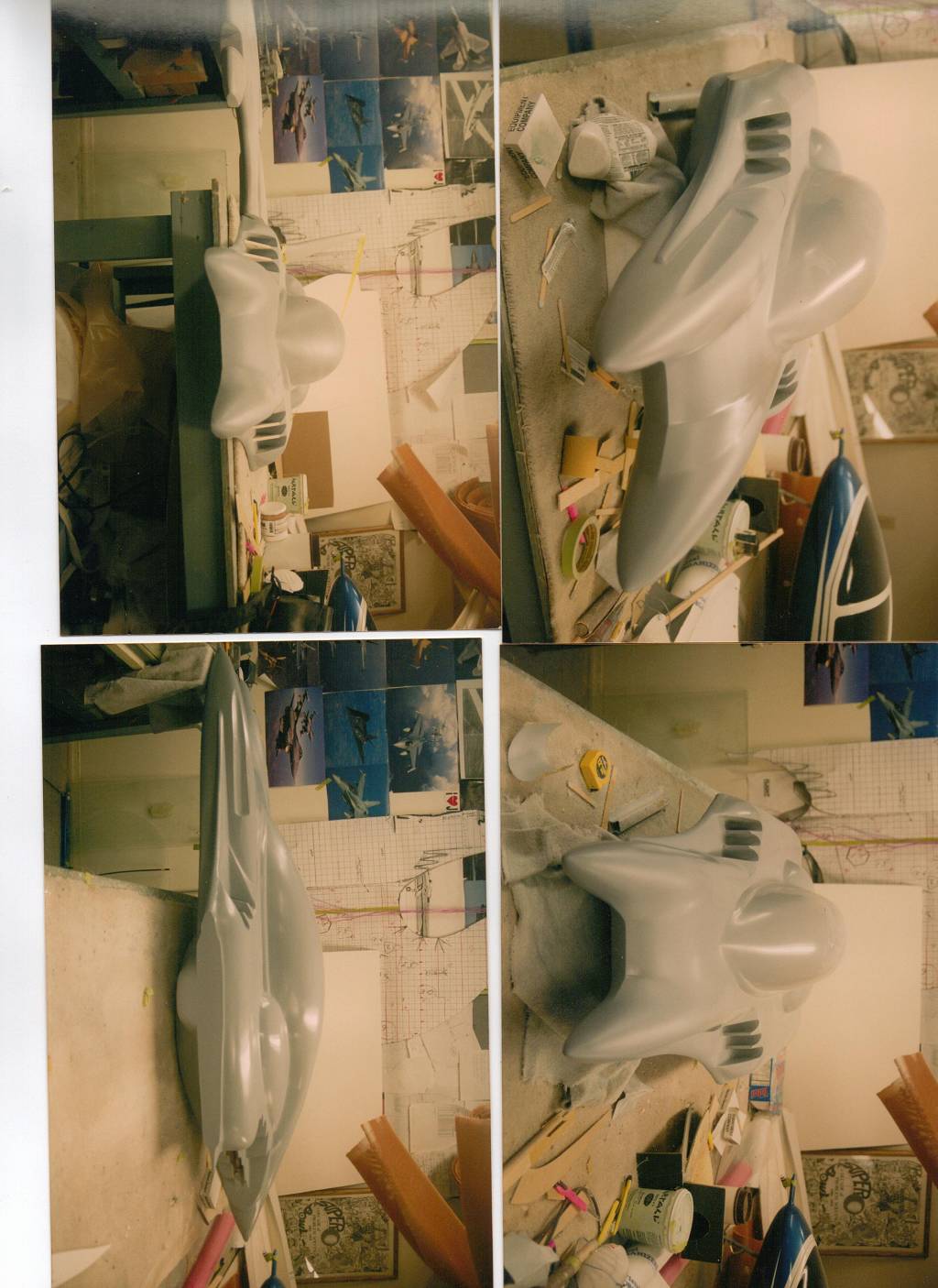

more plugs
ID:	1656320   Click image for larger version
ID:	1656321   Click image for larger version
ID:	1656322   Click image for larger version
ID:	1656323   Click image for larger version
ID:	1656324   Click image for larger version

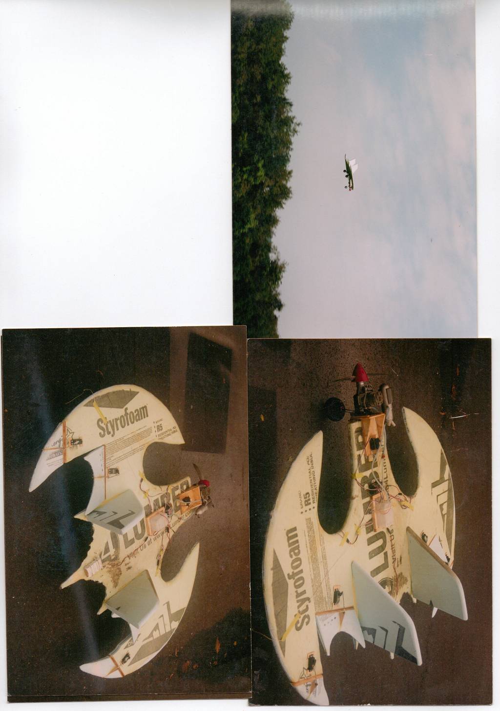

here is the very first batwing prototype-it was a chunk of foam with no airfoilit proved the air worthiness of the planform-and provided CG and control surface areas-flew like a trainer

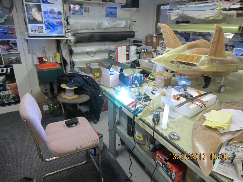

sure you can

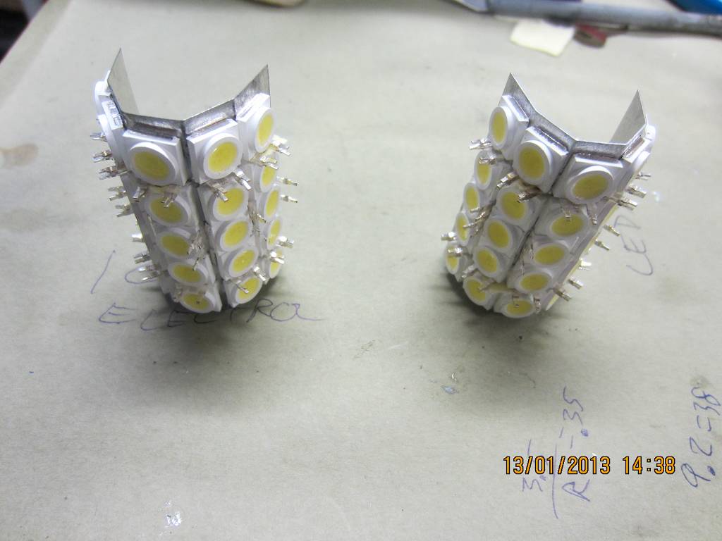

Here are pix of one of the wing light emitter arrays25 moonstones-9 amp @ 6.6 volt
