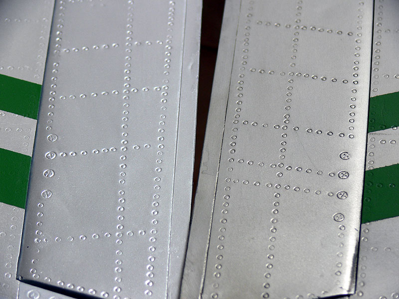

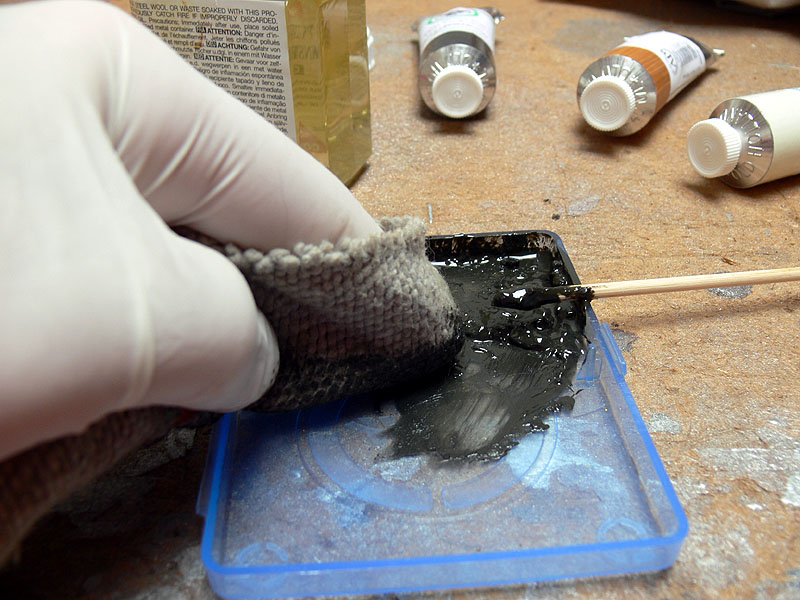

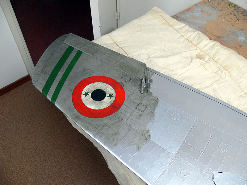

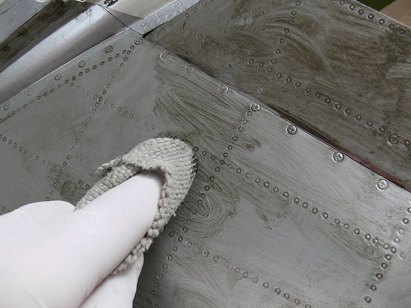

Yes I did on my Carf Mig 15
Its easy and works for me!, just follow the directions and you'll be amazed about the effect [8D]
Turpentine is just used to thin the paint so you can apply it easier,

Yes oil paint base...
black colour
earth or brown colour

i hane not paint protection... because i can remove or re-apply the wheathering at anytime
