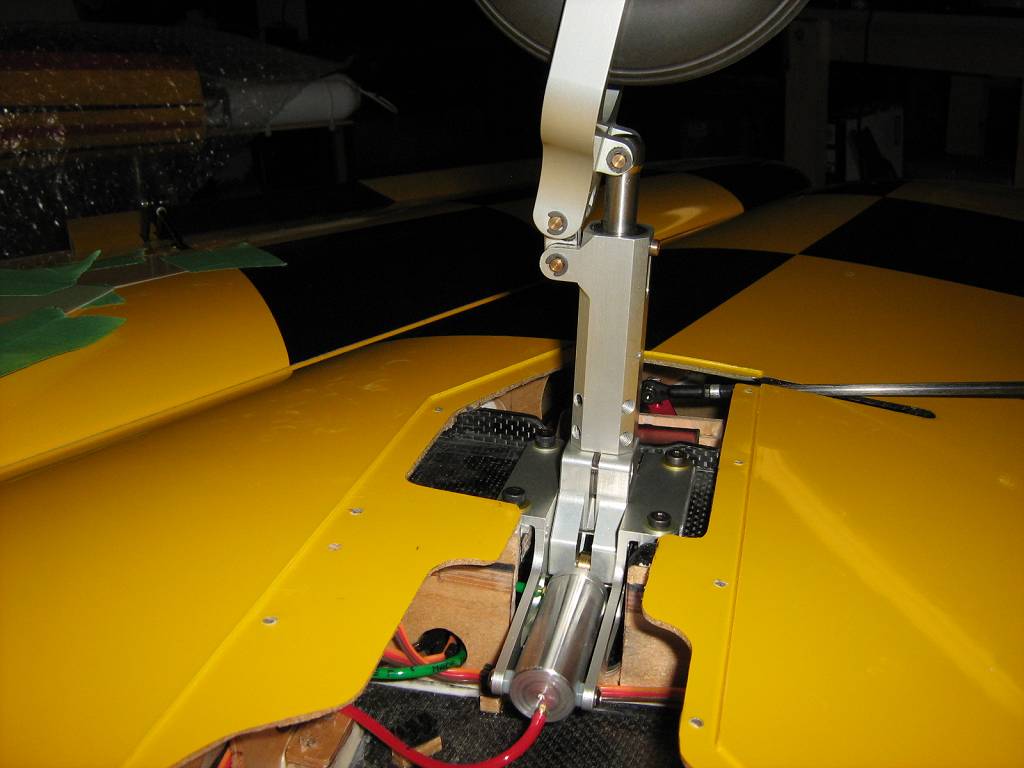

Dreamworks Hercules retracts+ Behotec struts/wheels/brakes= a bullet proof combo. You need to make 8mm to 1/2" adapter pins or just buy a few fromhttp://altecarerc.com/, part # FB81/2.
