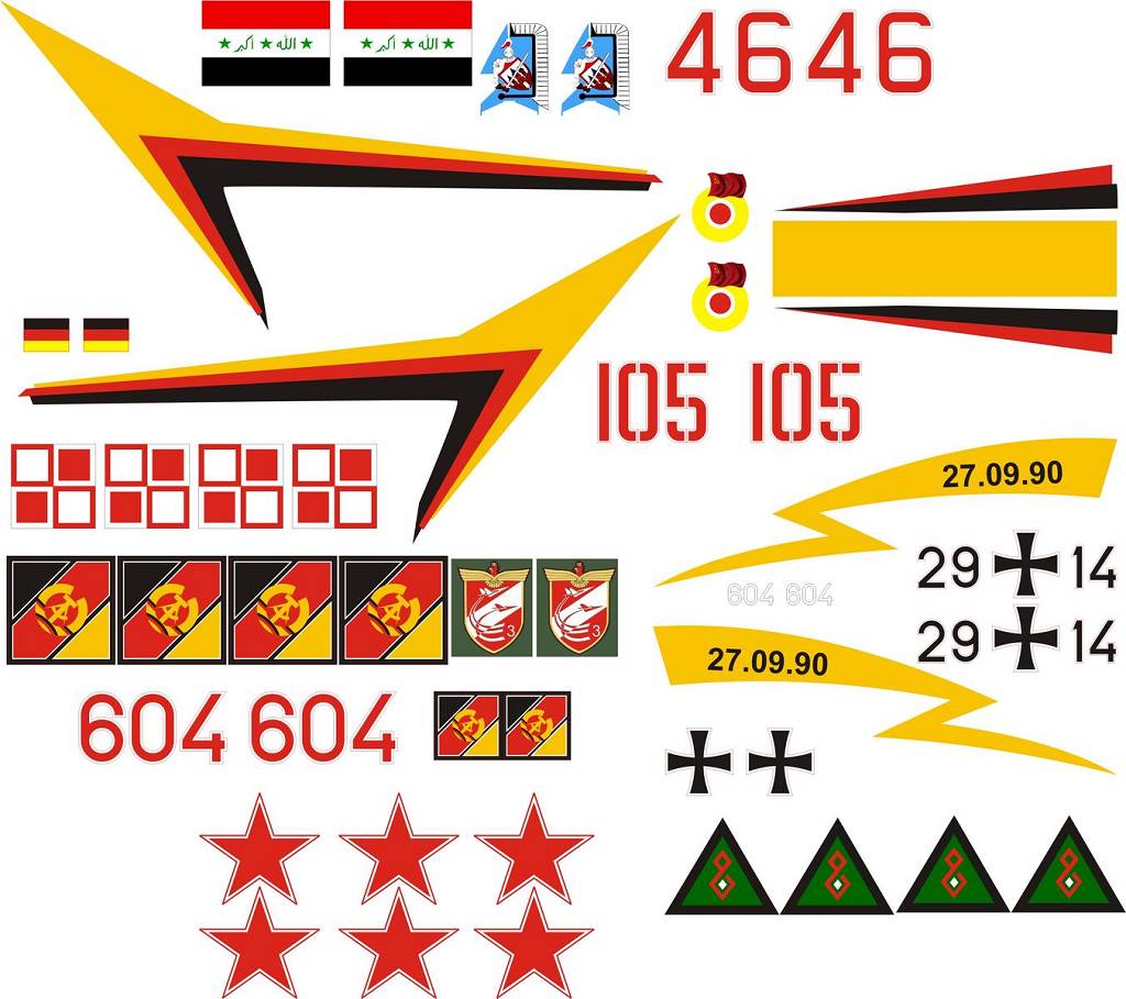

Oh and close up of the insignias as well would be helpful

Cheers, just what i need, just need a close up of the red an white insignia now, i have one of the red, yellow and black one.

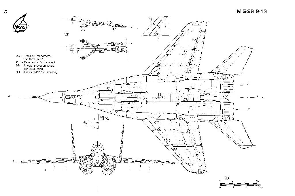

Maybe this can be helpful!
Jonas

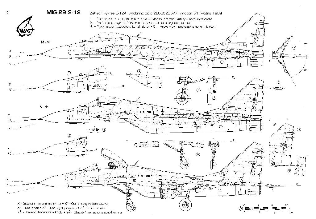

seems i can do only one at the time so here goes!
for some reason i cant post more than two posts in a while (strange!)
If this is what you need more will come! 8pics in all.
Jonas

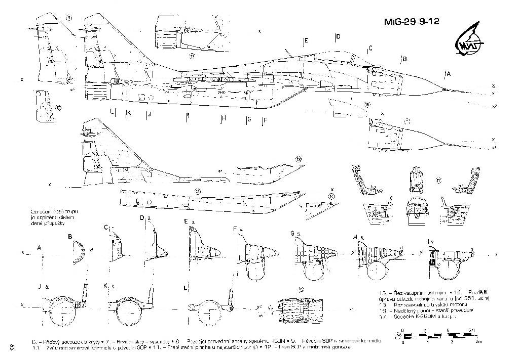

no3 and 4

Thanks for the drawings. Will try and print them out.
Hal

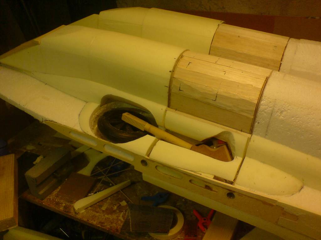

You are welcome! Im doing a Mig myself. A bit slow but i am at it again after a long break.
Probably gonna use the same schem as Carl!
Fiddling with the cockpit and the slob in the seat. Working on the nose gear at the moment.
Jonas

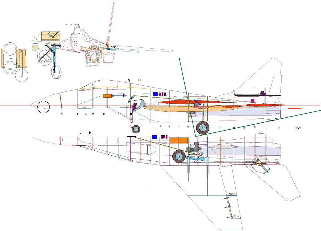

Old 10-24-2011 | 03:30 AM
Joined: Apr 2005
Posts: 314
From: Stockholm SWEDEN
Default RE: MIG-29 3 view
Yeah its scratch from my own plans. They are not all that accurate, i found those 3-views after i had drawn mine. Im building i foam and will use DF with IC engines. Performance will be poor i know, but so am i. Anyway, at 1/5 i think it will be pretty cool.
Jonas

Joined: Feb 2003
Posts: 538
From: Jackson, MS
Jonas
What did you use to make the patterns for your fuselage bulkheads and rib patterns?
Hal
Old 10-25-2011 | 02:06 AM
Joined: Apr 2005
Posts: 314
I have this signcutting machine, I found that by replacing the knife with a ballpoint pen i could get pretty good fullscale drawings.
Otherwise i use 4mm MDF board or where there is plywood bulkhead i ssssimply drew on to the plywood. The Fuse is pretty much sanded to shape. Only bulkheads where engines/landinggear and other strongpoints dictates a need. Otherwise just foam!
Jonas
