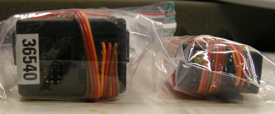

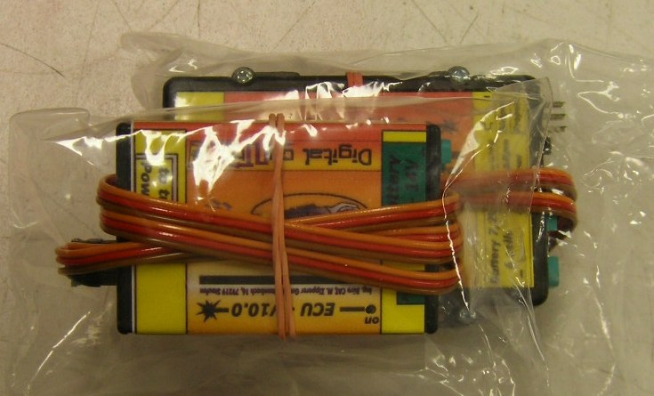

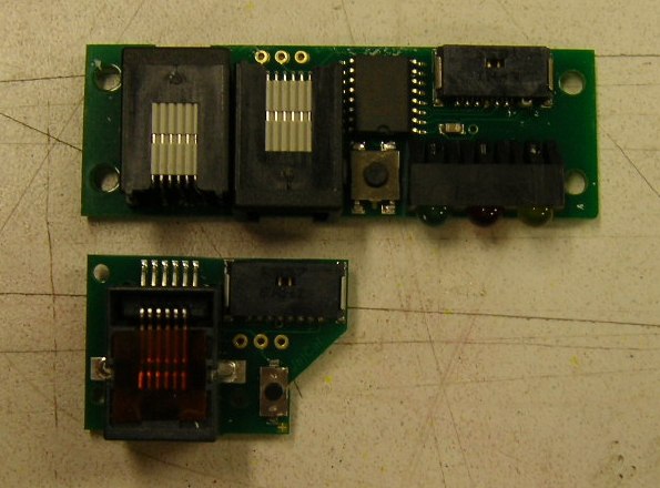

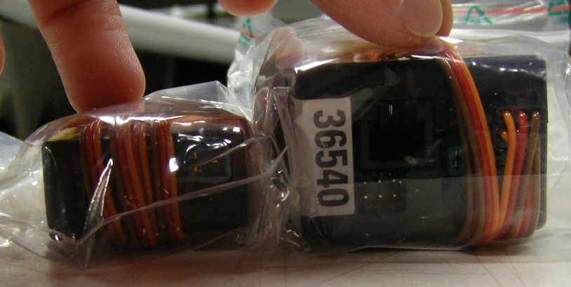

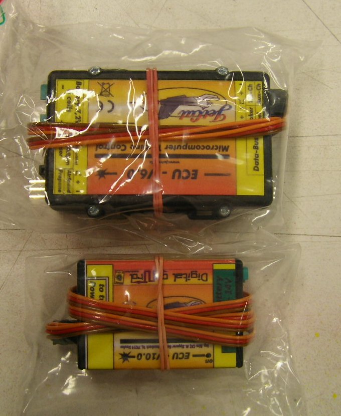

Here is a side by side comparison between my V6 ECU in my new P-120SX and my V10 ECU in my new P-140RX. this thing is 1/2 the size. Also look at the new IO Board. Tiny as well. Add in the fact that there are no solenoids and you have a very simple light install. Well done JetCat!!

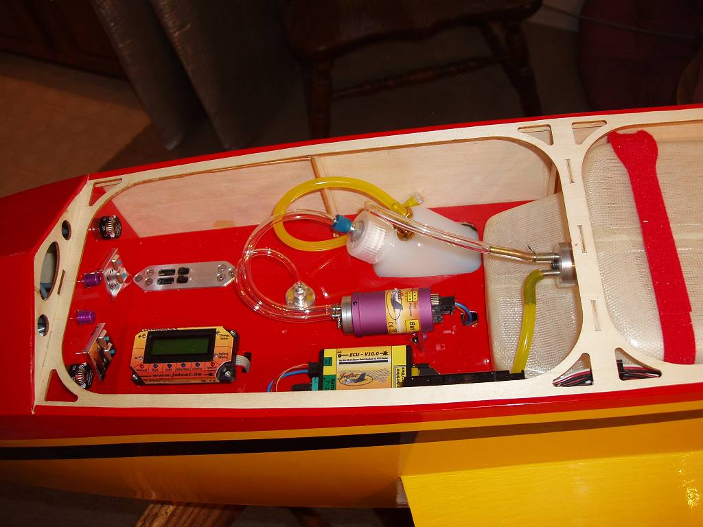

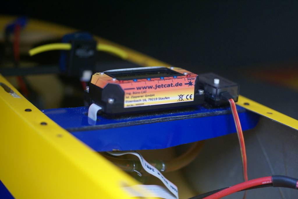

Old 11-17-2011 | 07:36 AM
Posts: 2,341
From: Longwood , FL
Default RE: JetCat V10 ECU

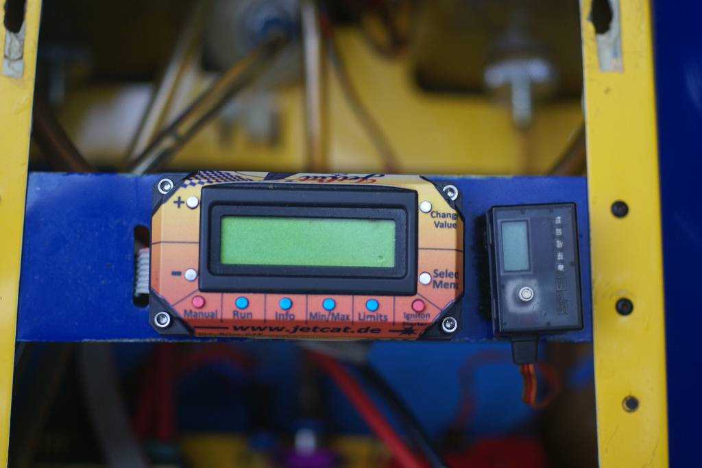

Here's the new GSU installed in my KingCat. It is small enough to mount in a usable position on most jets. The characters are small, but readable even with my old eyes.
The GSU will work with all RX and pre-RX engines.
You must use the latest model pre-RX I/O board (With the plastic housing for the LED's) or the RX I/O board as they have a socket for the ribbon cable. Previous I/O boards lack the socket below the LED's.
The socket for the ribbon cable is visable in the last photo on post #1.
