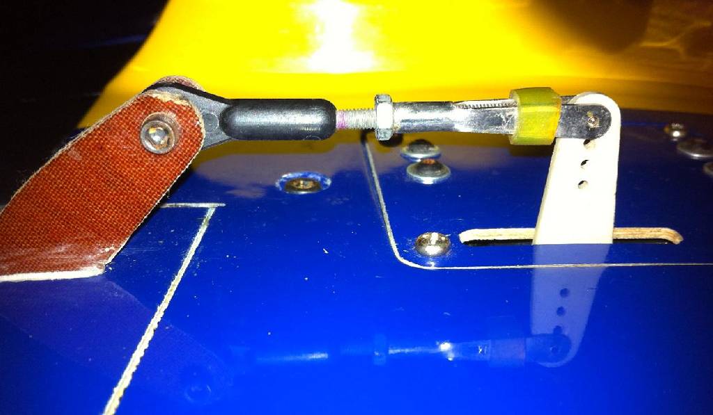

as work continued this afternoon on the redoing of the #6 Blue Angel Flash, i have discovered the most likely cause of the stab blanking mentioned earlier in this thread......the elevator servos have 3D control horns on them a mile long, at that length, the travel adjust would of had to have been dialed down so low there was no stick resolution and the servo was at a huge mechanical disadvantage. will be replacing these with JR HD horns a little later tonight, pic 2 is of my Jolly Roger Flash with the JR HD horns, it's never blanked at any speed and it's flown with a Titan SE.
