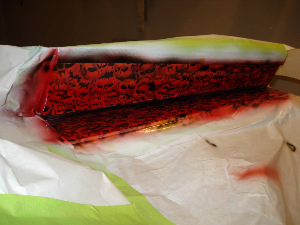

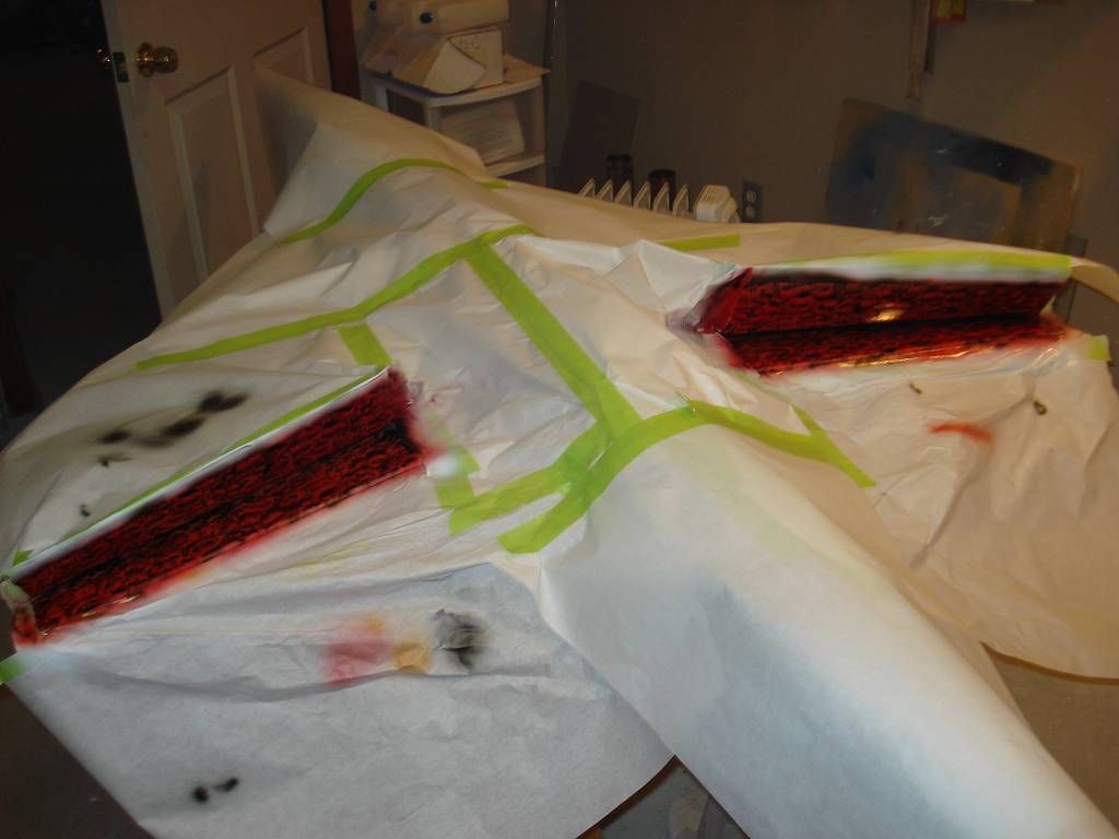

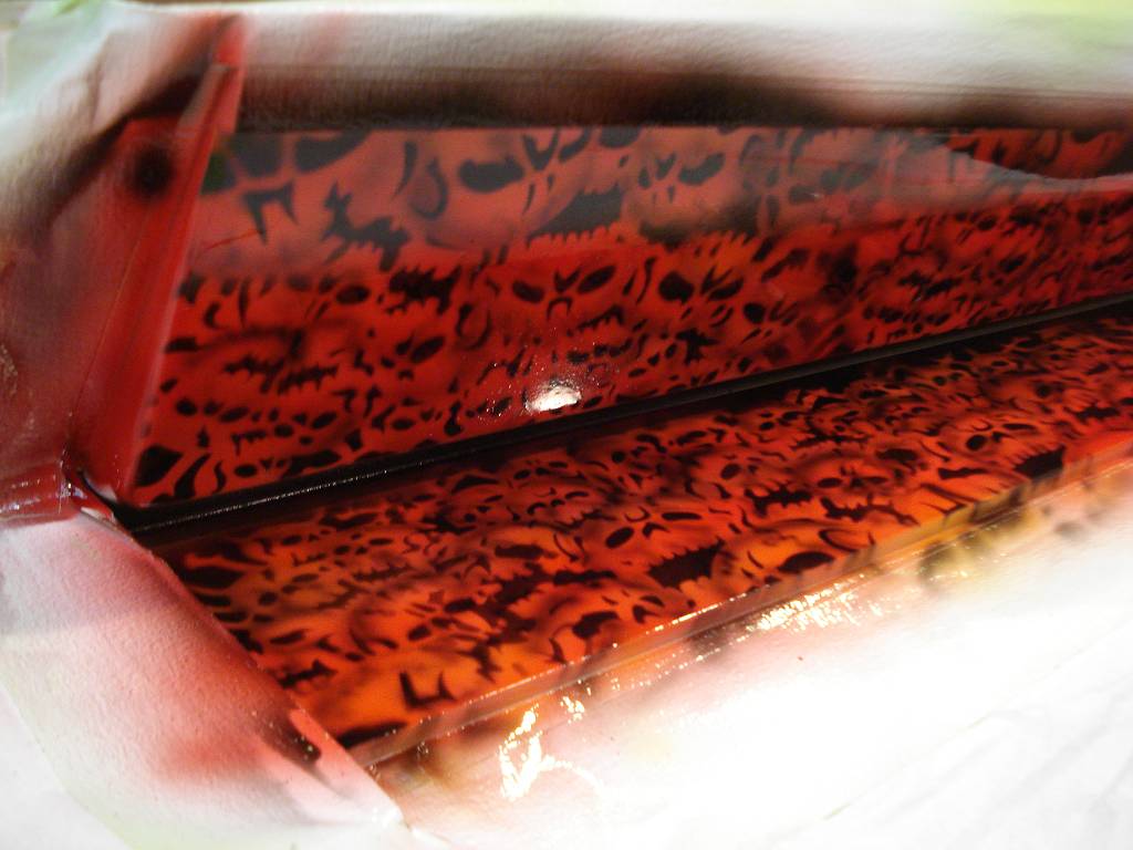

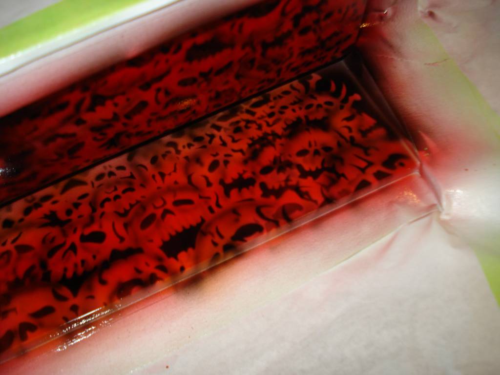

While I'm waiting for some supplies for the Richthofen Phantom, I've started the paint work on my buddy Erik's Firebird. Basically the scheme is a take on Miss America done in candies and pearls topside but with something a bit more evil on the bottom. Since the flaps are already hinged this presents problems in the paint department, it's not easy to do alot of stuff in there. Not being able to lay things flat is a pain, but it's workable with some patience. The inboard areas get lots of skulls, candied, cleared and then taped off so I can continue with the rest of the work. Should give you an idea of the rest of the bottom of the jet. Shredded metal, reapers and other cool stuff. I'll update this as time allows....

Stencils and patience!!
Old 12-20-2011 | 03:53 PM
SPLIT S's Avatar
Joined: Apr 2006
Posts: 1,171
From: Blandon, PA
Default RE: Firebird Paint
Ok, back at a real keyboard.
Yep, stencils certainly help. First the area was sprayed with white PPG DBC base coat. The skull stencil is positioned where you want and black DBC is applied. You end up with white skulls with black highlights. Pretty cool but kind of plain looking. The patience is highlighting and shading areas using an airbrush with more of the black base. You want to give the skulls some depth and seperation from the others creating a more 3D type effect. No different really then weathering. I then airbrushed some yellow and orange candy to brighten certain areas and then finally red candy to tie everything together. The result is a sea of evil skulls, too bad the area they are in most will rarely see.

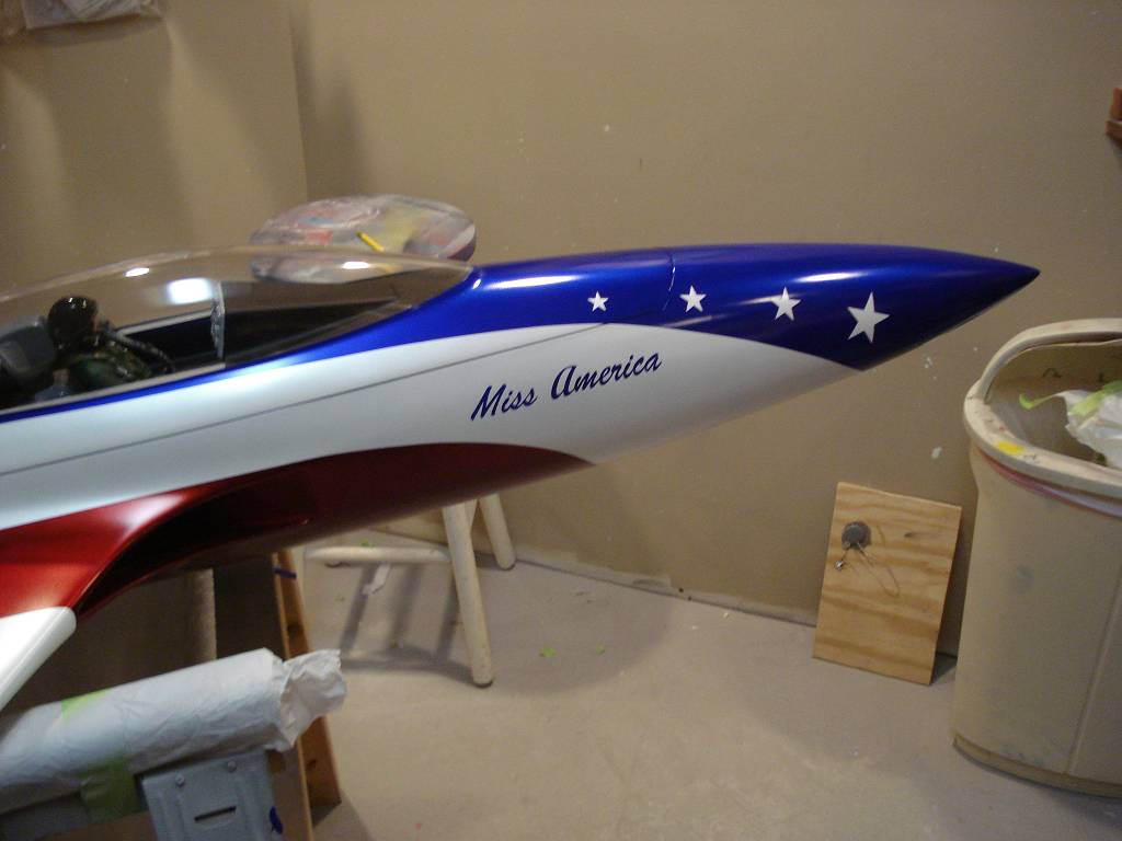

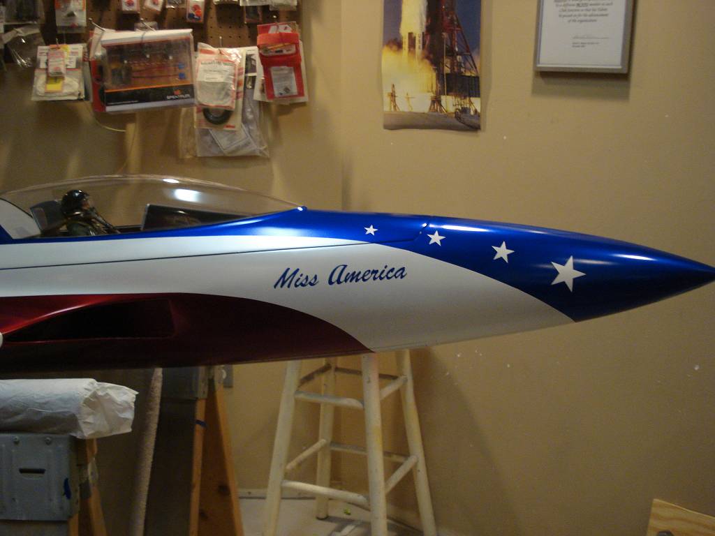

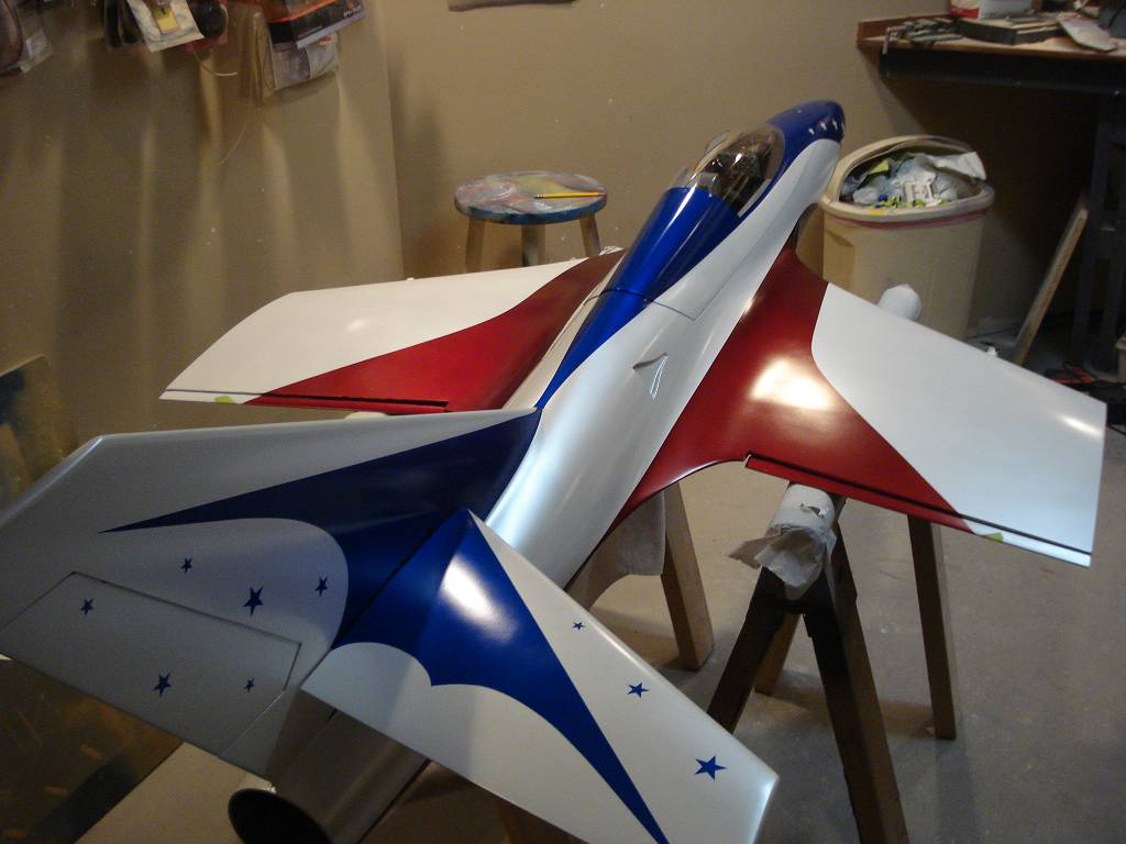

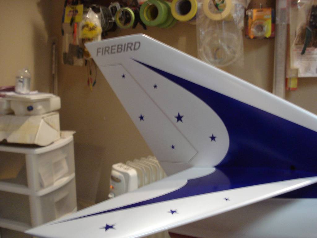

Candy blue and stars up top...

Old 01-11-2012 | 06:55 AM
AndyAndrews's Avatar
Joined: Feb 2007
Posts: 6,147
Received 8 Likes on 6 Posts
From: Little Rock, AR
totally sick demon core badassness.
