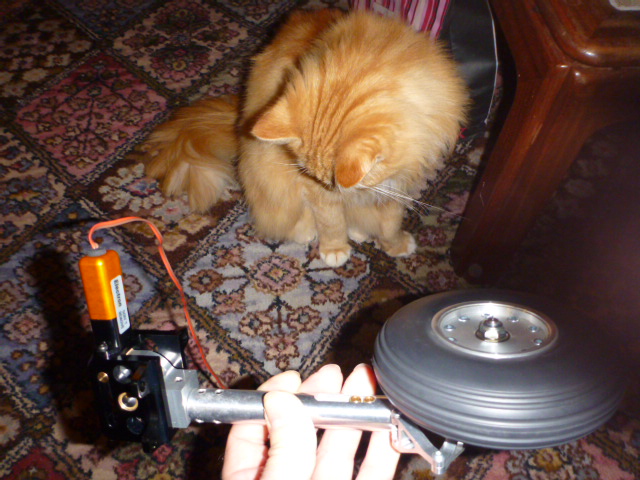

We now have available these high quality electronic retract systems available in medium and large sizes. CNC machined from solid and available with or without built in nosewheel steering. They are extremely smooth and quiet in operation with a typical scale cycling time of around 3 secs.
The small programable electronic control unit also allows for the use of electromagnetic brakes for a completely air free system. I will upload some video of their operation later.

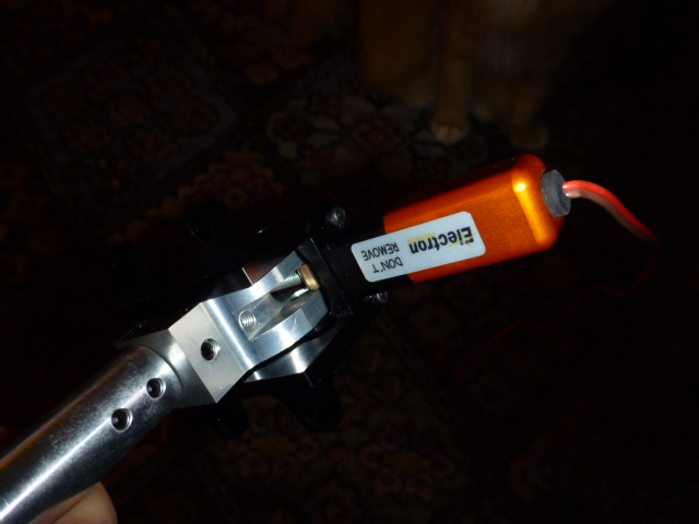

Electron ER40 Electrical retracts
The ER40 kit replaces your pneumatic 3 legged landing gear. The electrical retracts greatly add to the reliablility of your jet. The move in 3 seconds in a scale like appearance in or out. The ER40 kit is suitable for jets up to 20 kilo. ( 44 Lbs)
Angle 90 degrees
Pickup choice between: 6,8,10mm or 1/2"
Weight 310 gr.
Power consumption 400 Mah
full travel in 3 seconds
Comes with steering wheel option
Comes with controller

Thanks for the words of support gents, medium size are up to 20kg and large are up to 40kg models. Prices later today but comparable with other quality retracts. Please note these are only the retract units, the struts are Behotec for my Tutor, I also have a medium set arriving for Ultra Flash.
Pin size can be made for any existing struts, these are 8mm.
Brakes are still under development but having the facility now helps to make them future proof. Also no need for a separate battery, just t off the ecu battery for convenience.
