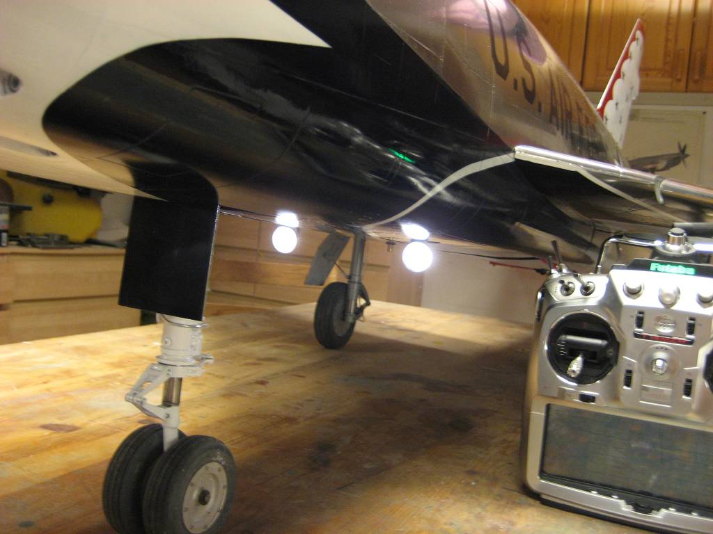

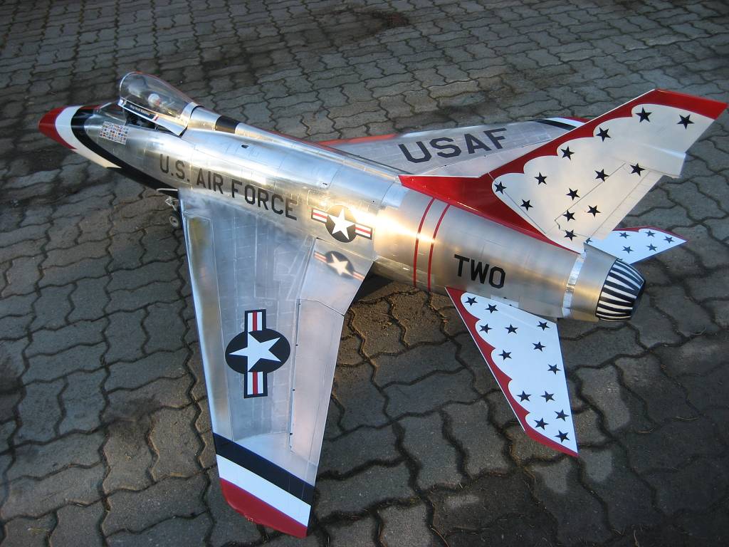

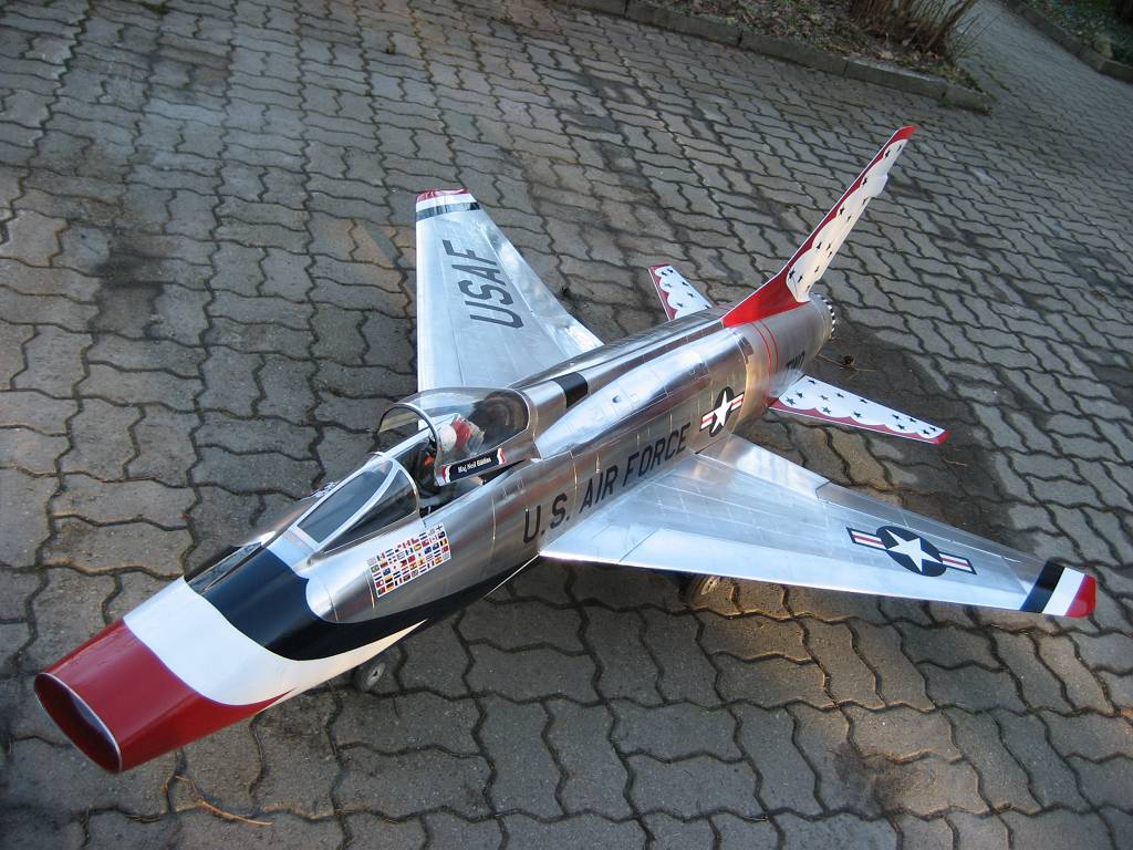

Finally! It flew first in 2005, got inspired by Greg's thread recently.

More

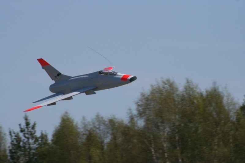

Very nice looks great!!!!

Pictures taken today, slow winter so far. Mild westerly STRONG winds recently.
Colors are painted with acrylic base and 2k clear coat.
The FliteMetal aluminum tested my motivation, especially the sanding part. But I learned how to polish!!

Did you pre-sand the FM to account for the panel lines or did you fill those before applying FM?
I agree about the sanding, it takes a lot of time but FM just doesn't look right without it or if it's not done enough to remove the orange peel look.

smchale, I sanded the FM on the model. The panel lines were not altered, just matted carefully with a toothpick inside the paper(400)

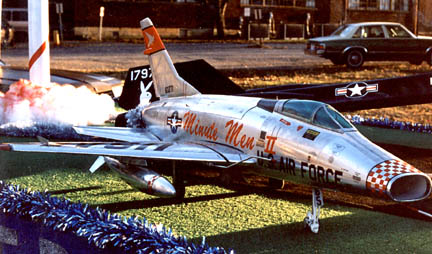

Very nice I love the metal finish on an F-100. Just doesnt look right without it. Here is mine. Its long gone now but would do another in a heartbeat. Great job on yours. Im thinking of making the trip to KY jets this year.

That "Minute Men" scheme looks great too! I chose the Thunderbrds primarily for the (hopefully) better visibility. Working on the ferry tanks for more area as well.
