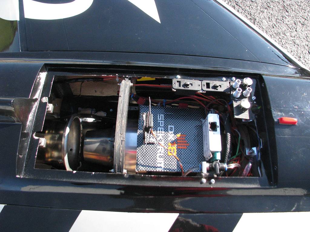

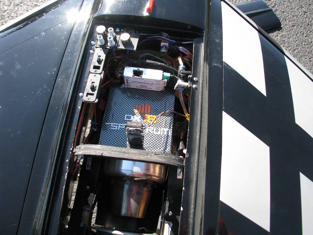

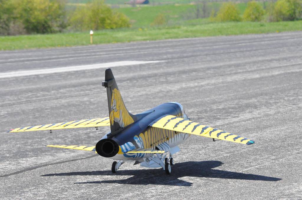

Take Care...Notice in the installation thatone receiver antennae is near the intake. During the range check, this antennae was touching the intake. After four holds, I realized the air rushing in was probably causing some static build up.We putsome short tubing on the antannae and the rangecheck was successful. If anyone chooses to locate your receiverin this area, make sure to stabalize the antennae. 1/4 inchof the antennae extends past the tubing.

Default RE: Fly Eagle A-7 Corsair Build
Congratulations !
..it would be a good idea to reduce the gap between the bell mouth and the turbine as is too big.
my 2c

DelGatoGrande'
Your observation is noted. . .however, tests with our Rhino prove the best cooling of pipe, air frame and the added thrust are realized when the end of the nozzles is between 1.25 and 1.50 inches spacing from entrance to the pipe. This is most definitely been tested and works. The reason is, the pressure area at the entrance to the pipe is enhanced when set up this way. Many of our customers who previously complained of "hot" fuselage after flight, could not believe the difference when set up this way. We include within our manual, a chart of measurements for each of our turbines. Maximum/minimum ID pipe size is noted as well.
Readers. . .please check with your specific turbine manufacturer as to their acceptable turbine/pipe set up measurements.
Thank you,
Eric Clapp

ORIGINAL: DelGatoGrande
Congratulations !
my 2c
It's exactly at the1.50 recommendation.
Lewis

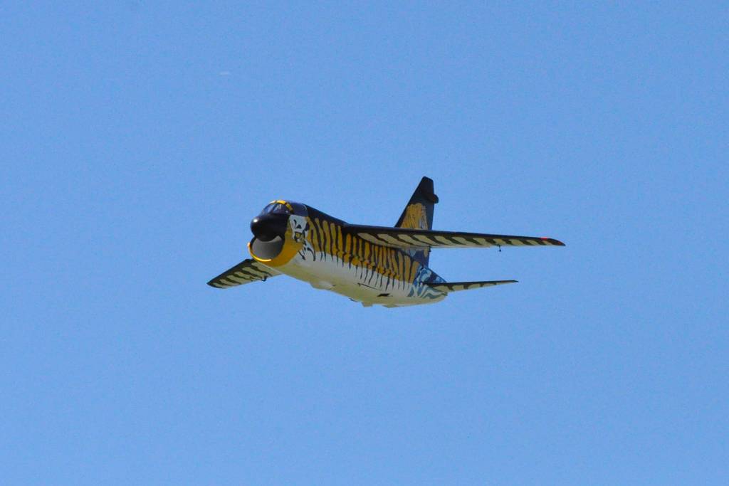

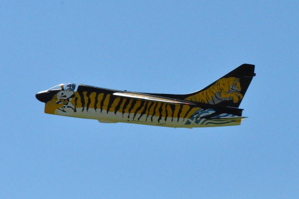

Last photos
ID:	1744327   Click image for larger version
ID:	1744328   Click image for larger version
ID:	1744329   Click image for larger version
ID:	1744330   Click image for larger version
ID:	1744331   Click image for larger version
ID:	1744332   Click image for larger version

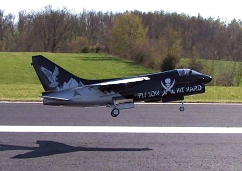

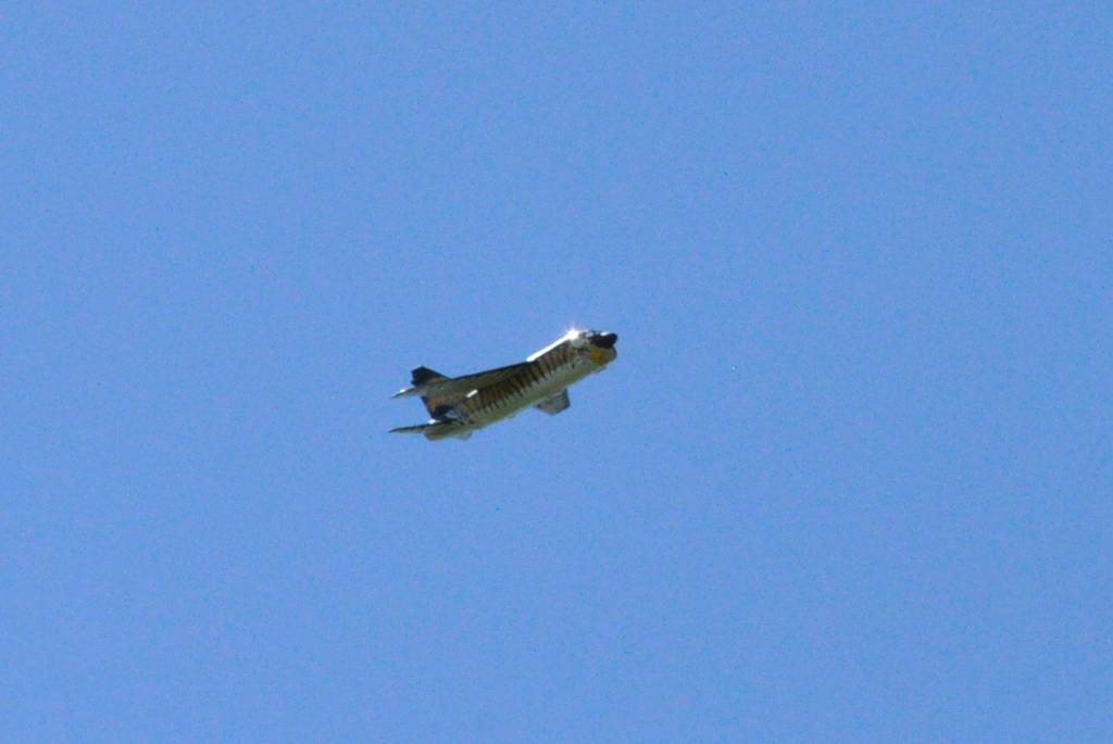

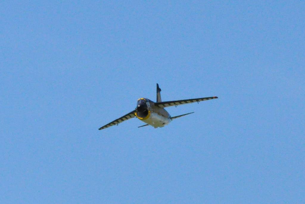

More flights Saturday. One thing I did was land with flaps. Instructions say not to, but from practice runsata few hundred feet I had no problems, so lets do it! The A-7 is a breeze to land with flaps. Landing position flaps were deployed on the downwind, all the way to the centerline just like a trainer. The A-7 was smooth as silk all the way around. Wind direction was slight cross blowing out (8mph). With a Rhino, it tough to slow down, therefore the use of flaps for me is very necessary. Nextsession I'll use flaps for takeoff. Takeoff roll is about 400ft; flaps should help that considerably.
ID:	1748283   Click image for larger version
ID:	1748284   Click image for larger version
ID:	1748285   Click image for larger version
ID:	1748286   Click image for larger version
ID:	1748287   Click image for larger version
ID:	1748288   Click image for larger version
ID:	1748289   Click image for larger version

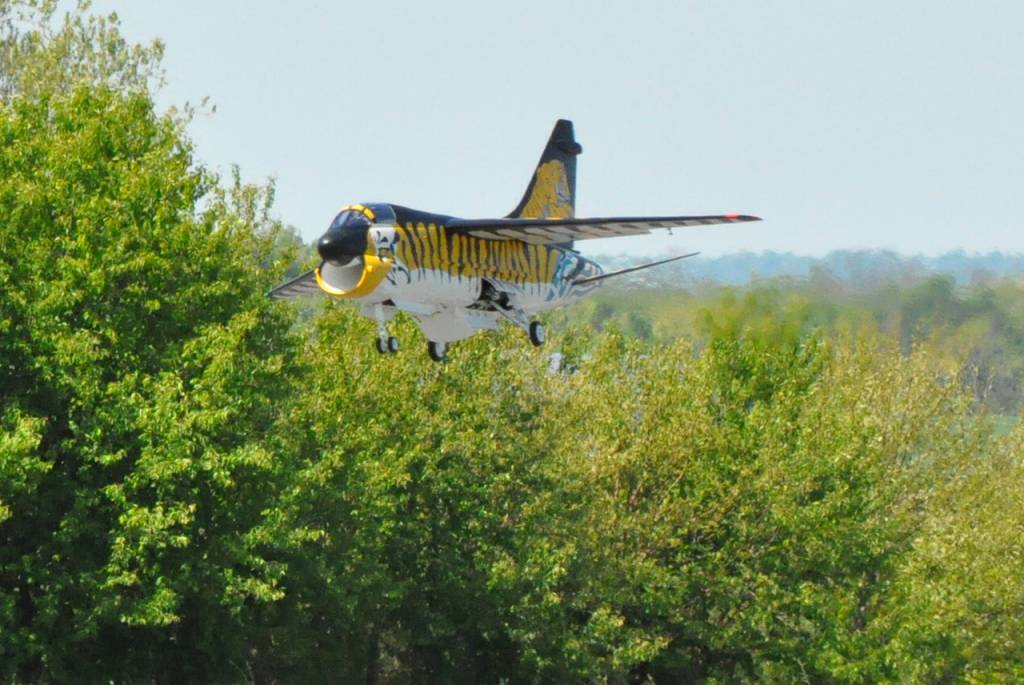

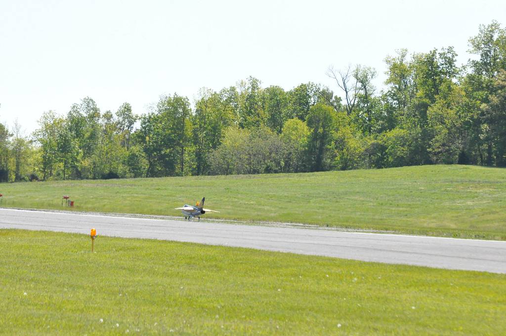

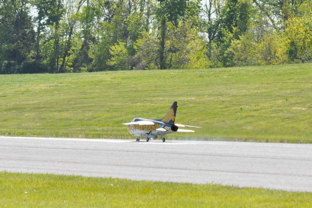

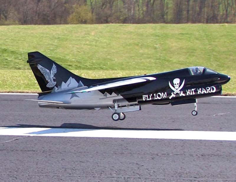

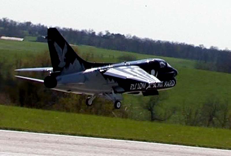

Pictures of the landing with flaps. Flap position was takeoff...Will do full flap next time...Handles like a trainer!
ID:	1752054   Click image for larger version
ID:	1752055   Click image for larger version
ID:	1752056   Click image for larger version
ID:	1752057   Click image for larger version
ID:	1752058   Click image for larger version
ID:	1752059   Click image for larger version

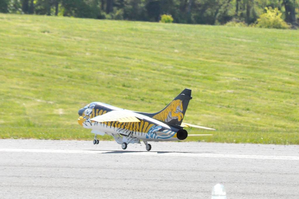

Received 63 Likes on 45 Posts

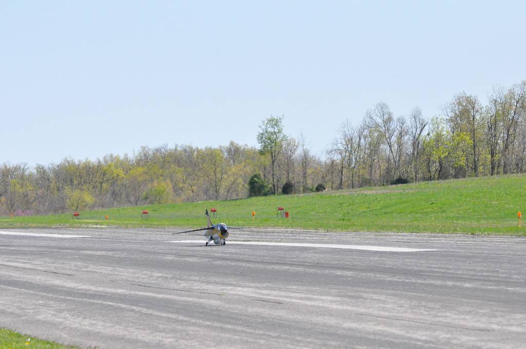

Made a post a few week ago on my "Jets Over Kentucky Week" thread a few two weeks ago, but wanted to follow up on the build thread of the A-7...
Video...
http://www.youtube.com/watch?feature...&v=tPdRnqRc4xQ
Had the pleasure of flying the new A-7 Cosair a few weeks ago. This aircraft is the replacement for the Tiger scheme A-7 that was lost due to a mid-air collision at Jets Over Kentucky last year. What a great airplane!Takeoff was very predictable and stable, and the entire flight was AWESOME! This was the most uneventful maidenever for me! The old A-7(midair victim) was a good one, but this one is truly exceptional. Leading edge slats make for a slow and stable landing.I'm also using two JR 370Agyros on this model. Ailerons and rudder were truly locked, and did not waver in the 18 to 20 knot winds thatI had today. I took a picture of the wind sock and began to wonder if I should wait!!!!! Temptation was too great, and away she went.I however chose not to fly again for the windwas constantly picking up. Keith "Jet Jockey did the taping on my camera, and Buck showed up with his equipment. Make sure to click on the link to see Buck's great work on the video! Here are a few picturesbefore the flight. Many thanks to Fly Eagle Jets for such a fine airplane. Thanks also to Scott Marr and the Jets Over Kentuckypilots for making this happen. I hope Scott has his new plane ready to fly.Thanks to everyone formaking this a very specialday.
Made a second flight this past weekend, and all still went very well. I put the aircraft through point rolls, slow rolls, loops, and a big humpty bump...what an airplane!!!The A-7 will make it's first appearance at theFirst In Flight Jet Rally in Wilson, NC. in just a few weeks.
Lewis Patton
