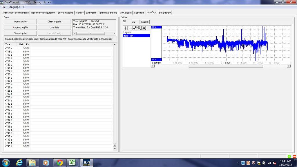

I also agree with David..
This is a thread about Futaba Sbus and the power requirement of servos.
I use a Wea micro system in my Bandit (8 x 8411) which records the Rx battery voltage every second and logs it. The attached graph of a 12 minute flight shows the voltage varied between 5.8 and 6 volts. I am very comfortable that my system is coping with the power demands of the eight servos. (just a fraction of what the Wea system can do.)
Roger
