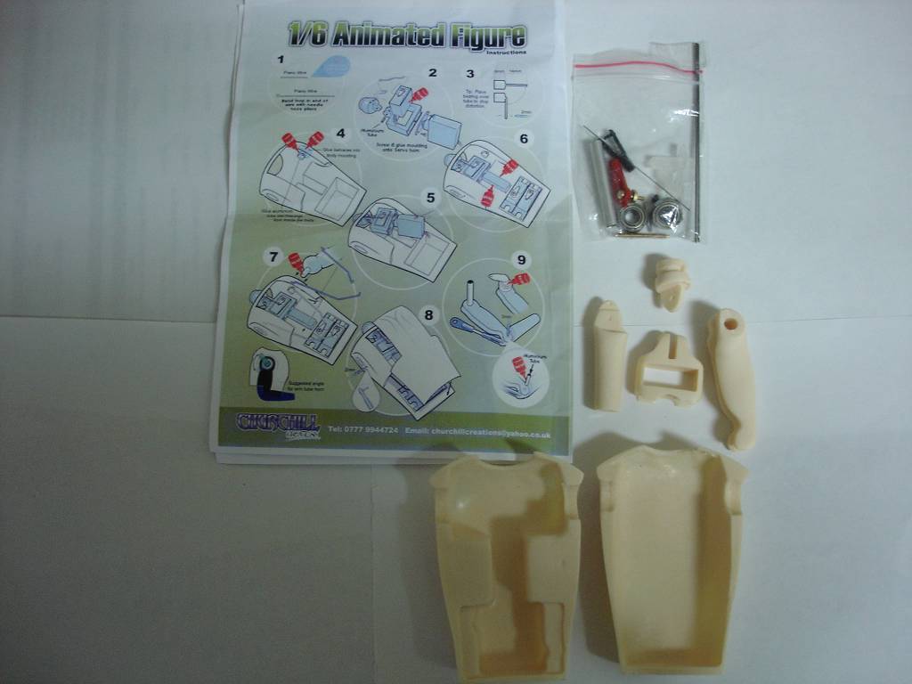

it a kit look like this one, use your 12" pilot like this one and replace the up body and clothing

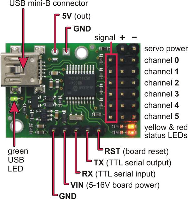

I finally got my Pololu boards, but having a hard time to program it.
Can any one know how to strat a sequence from the TX. Do I use this?
The RX line is used to receive non-inverted TTL (0–5 V) serial bytes, such as those from microcontroller UARTs. These bytes can either be serial commands for the Maestro, arbitrary bytes to send back to the computer via the USB connection, or both. For more information about the Maestro’s serial interface, see Section 5.a. Note that the Maestro will probably be able to receive 3.3V TTL serial bytes, but it is not guaranteed to read 3.3V as high on the RX pin, so you should boost 3.3V TTL serial signals to above 4V if you want to ensure reliable operation.

Nuno which model Pololu did you get? I know how to record from a TX on the basic stamp but I have not tried it yet on the Pololu.
woj has one he might chime in soon.
Don't give up, these things take on a whole new dimension when they move on their own and are not tied slavishy to the rudder or something.

I have the micro maestro board for 6 servos and having a ball with it.....
I already made some movements but need to know how to strat the sequence from the TX, using a spare channel

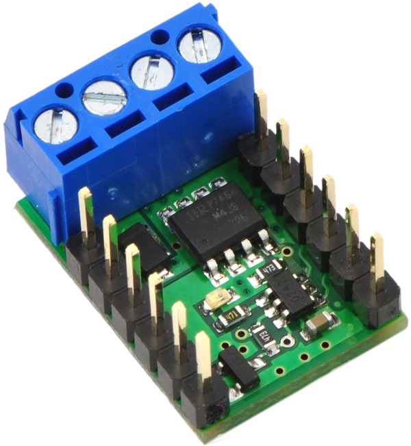

http://www.pololu.com/catalog/product/721
you can use this ... it allows you to switch between TX control and the automated sequence programed into the controller board .. if you just want to turn it off, don't run any channels but the switch channel into the mux ..

Thanks Woj
Isn't possible to start the sequence only with the Maestro board using the TTL serial input (RX pin)?
Is there any other way? What about a switch? I really don´t want to order another board. I have to order from abroad and it will take a long time[]

Still I am not able to start a sequence without the USB port connected to my laptop.
HELP, please....
Regards
Nuno

Ok
I finaly got them working without the USB port.......
